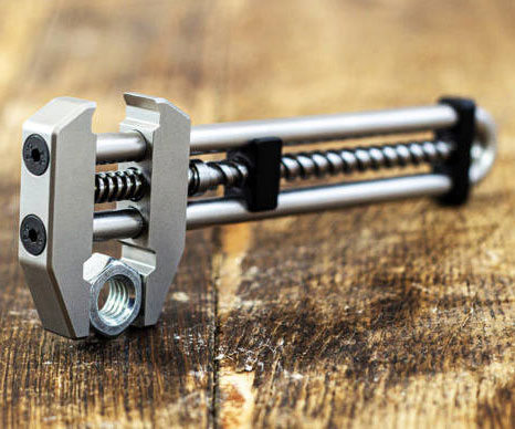

      Methinks pgk may have a vested interest in this unique design. That said it is an interesting combination of approaches to solve a problem and must have been relatively difficult to blend these designs into an apparently functional unit. I look forward to developments that may be forthcoming that could solve as yet undiscovered problems.

        Clive Foster
          @clivefoster55965
          Martin
          No great difficulty in blending the Crescent style adjustable spanner mechanism with the Mole locking capability.
          Essentially the adjuster helix is mounted at right angles to the parallel jaw motion version of the Mole / Vise-Grip et al mechanism. The locking action just shifts the helix along a little so the nut / bolt head / square or whatever is gripped between the jaws. The effect is no different to torquing the adjuster up really really tight. Which is impractical in the real world.
          From a constructional viewpoint the main issue is providing sliding surfaces for the moving jaw that restrain it from tilt in both widening and narrowing the spacing directions. Crescent style wrenches generally only provide positive restraint against widening splay. Mostly pretty badly at that. Theoretically the jaws should naturally sit slightly pigeon toed as the wrench is adjusted and move out to dead parallel when its used correctly by nipping the adjuster up as it sits on the nut. If you don't nip the adjuster the jaws are inherently splayed and just get worse under leverage.
          The locking plier hybrid just does the nip for you pulling the jaws parallel and stopping the thing falling off the nut or whatever.
          For me the most likely use is when needing to hold a semi-accessible nut or bolt head by jamming a spanner against a suitable hard point before going round to the, out of reach, other side to actually operate on things.
          Clive

                  #558615
                  Mick B1
                    @mickb1
                    Here's one of the sites selling it:-
                    **LINK**
                    Note the name of the site.
                    laugh
                    I think it's fairly clear that most early sales at those prices will be more for its coolth than its usefulness…

                        With that fast, deep–threaded leadscrew, I can see why the sell price has to be so high. The only cheap an' easy way I can imagine to make it would involve mazak diecasting, with exactly the quality you might expect from that …

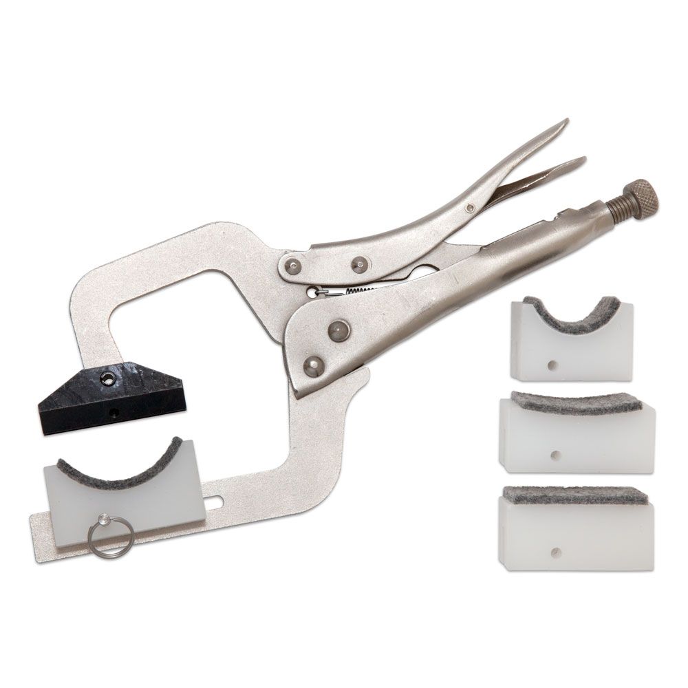

                            Forgive me if this tip has been aired, but what about a mole grip style grip with one jaw removed and replaced with one that pivots in the middle, so that an even pressure could be obtained along its length.
                            Mike.
                            #559279
                            sparky mike
                              @sparkymike
                              #559280
                              sparky mike
                                @sparkymike
                                See above picture. This is for pressing in frets when making guitars, but any shape jaws could be made and fitted to same idea. I have a Facom grip that is similar to above grips. Frets have to be pressed in with even pressure along the length, which the above will do very well, with whatever reasonable pressure you want..
                                Mike.

                                  John Smith 47
                                    @johnsmith47
                                    Posted by Mick B1 on 17/08/2021 13:19:24:
                                    **LINK**
                                    laugh
                                    I admire the clever engineering. In particular the way it auto-locks is clever.
                                    BUT
                                    1. It is using 316 stainless steel. That won't be very strong. I'd rather have a hardened forged steel and just look after it to make sure it doesn't rust
                                    2. The 90° angle to the handle isn't ideal.
                                    3. Although it appears to auto-lock, it doesn't actually stay clamped – which was the main thing that I originally specified!
                                    Conclusion
                                    A rather nice office/fidget tool for those with 'more money than sense'. Or possibly the most expensive bottle opener in the world?
                                    J
