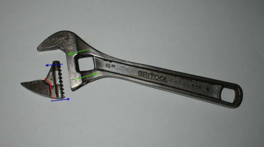

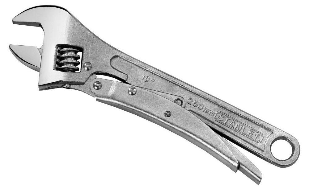

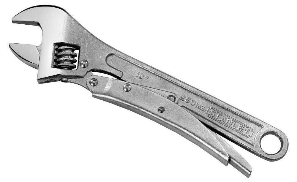

          The Stanley 85-610… I'm on the very brink of buying one… But have you tried shifting a large rusty nut (e.g. 30mm) with it? It would be interesting to know what the point of failure would be.
          i.e. Is it any weaker than a conventional adjustable spanner/wrench?
          From looking at it would would worry me is that the metal under the [green] arrow might get permanently bent, thereby rending the locking mechanism useless.
          OK it's been a long day… please don't flame me for this… but let's have some Photoshop fun with this design.
          1. Here is the existing Stanley 85-610 design:
          2. Here is what I would have done with it:
          The above looks much stronger, no?
          Can't see the difference?
          3. OK, here is an exaggeration…
          ==> I think I've taken it too far this time, but you get the general idea. Looks a LOT tougher now, no?
          The point of failure probably isn't where I thought. Maybe some pin will shear first… but that was fun to think about.
          Should they exist, which version would you buy?

            No they shouldn't exist, it's a plumbing tool, if I want heavy duty I'll use a 6 sided hex socket with a 1/2" drive breaker bar.

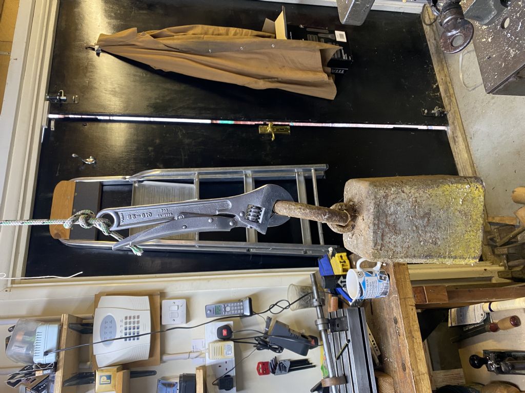

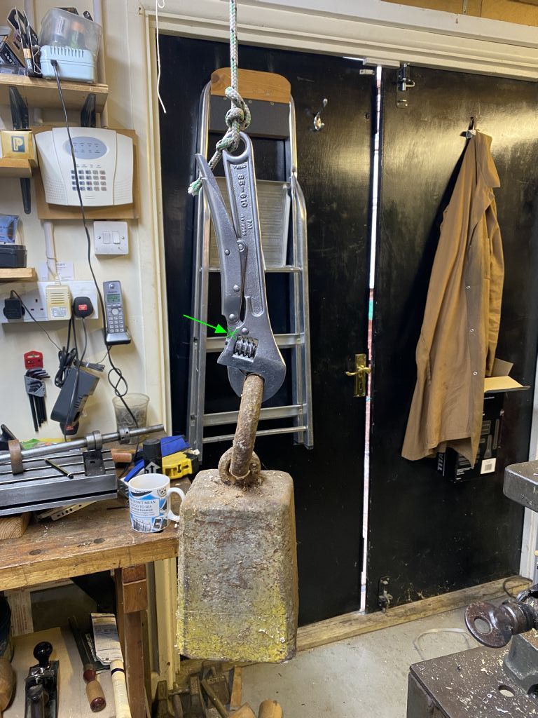

                          Nicholas Farr
                            @nicholasfarr14254
                            Posted by John Smith 47 on 13/05/2021 23:05:40:
                            Snip
                            Hi John, putting the locking mechanism aside, I've used many of this type of adjustable spanner very many times in various sizes in my day jobs and have only ever experienced one failure many years ago (apart from wear through use) and that was on the moving jaw, shown by the red line in the photo below. This failure was probably due to a flaw, as no extension tubes etc. were ever used on that spanner and a replacement jaw was fitted, and I still have and use this spanner. Further more, I think you will find the major moments of force on these types of spanners, are shown by the blue and green arrows, so beefing up the area you suggest will probably gain very little more strength. Many manufacturers have been designing and producing this type of spanner all my working life (locking mechanism excluded) and are a very successful tool (cheap versions not counted) I think the main principal of the locking mechanism is for locking the jaw at the desired width so that when in use, the adjusting screw doesn't unwind, which happens to the best of them when used, during putting on and taking off a nut on an adjuster, for example.
                            Regards Nick.

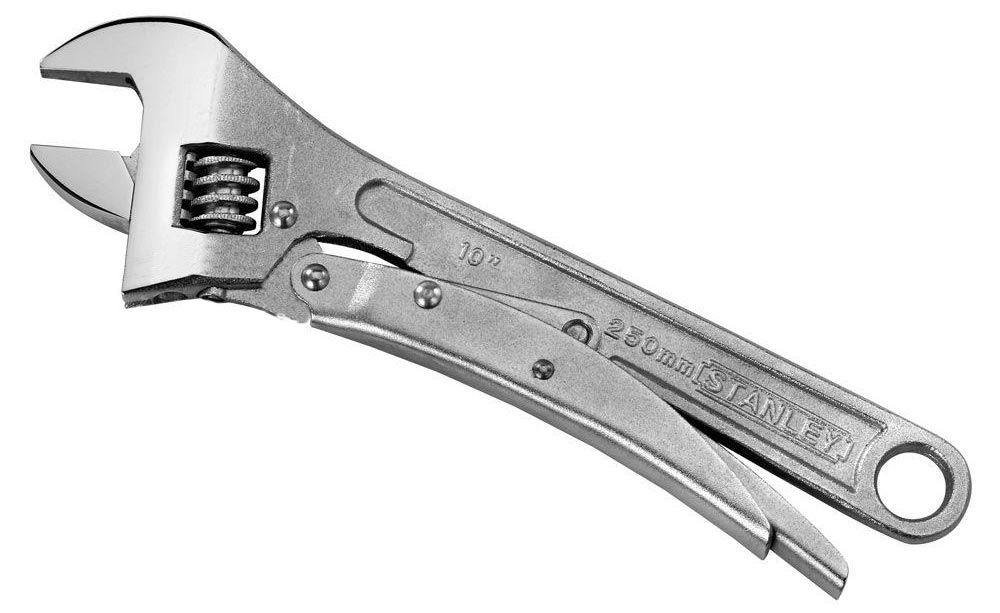

                              ChrisB – Laugh all you like…. Then read the reviews of some actual customers:
                              1. "When I first got my hands on this tool I thought it'd soon become my favourite spanner to have around as the locking function eliminates the inherent flaws with adjustable spanners, and it would also be excellent for gripping stubborn bolts on my old car.
                              Unfortunately after attempting to loosen one particularly stuck bolt one of the pins in the linkage deformed and now it's nearly useless. Seems that it's fallen for the Stanley tools staple of poor manufacturing quality and cheap materials."
                              2. "With so much steel, I would have thought "solid". No. Mine arrived, I unlocked the mechanism, and it did not lock back again, ever. Lots of steel, yet, weak. Furthermore, there was no indication of the steel type (not Chrome Vanadium steel, then)."
                              3. "The disadvantage of an adjustable wrench is that it is not stable enough, so that it may slip around a bolt or nut, resulting in damages to the parts or even to the operator. This item has been designed based on an intelligent idea, locking the adjustable jaw in order to solve the problem. Happily ordered one, just when I found it on the Internet. When repairing my bicycle, I used this wrench for the first time and I realized some deformations on its jaws. The applied materials in the tool are of such a low quality that the wrench was damaged by a bolt under a moderate torque. It is really disappointing. I do not recommend it at all, if you are looking for a durable wrench."
                              So the above is evidence that all my instincts are absolutely correct.
                              I am curious enough that I may possibly buy one anyway, but I'm not exactly rushing…
                              @ Nicholas – It is clear from the design that in use, a huge about of force will now be being taken by the locking mechanism itself. i.e. The jaws will start with a large amount of force due the jaws being locked together, before the additional force caused by the user turning the wrench (i.e. to move say a nut or similar).
                              The good thing about a Mole wrench is that it is fully adjustable. So if you really force something and end up bending the jaws slightly, you will barely notice because you can just wind in the adjustor thread as much as is required.
                              However as other reviews have pointed out it isn't all that difficult to bend the mechanism slightly and once that happens the locking mechanism will no longer lock!

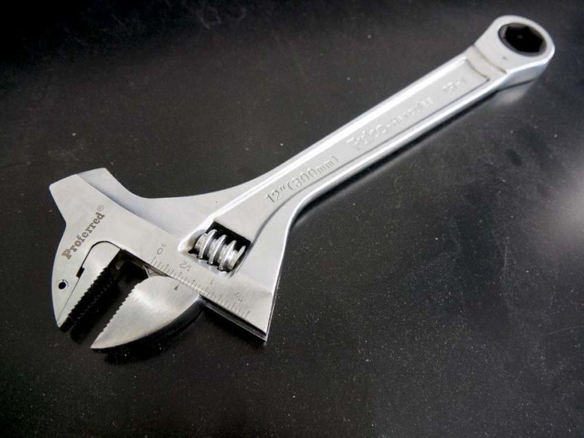

                                    What you need is one of these. A King Solomon's Miner's Wrench/Hammer. You can hammer the bejillikers out of any rusty nut with the hammer part before undoing it with the toothed jaws that never let go. Can be used as a pipe wrench too. Failing all else, you can hook a hex drive socket up into the ratchet on the handle and use that too. As the wedged toothed jaw section is self tightening it locks on to the job under pressure of rotation. The harder you yank it, the tighter it grips. And made by Proferred for the mining industry so you CANT break it. Four foot of pipe on the handle will not faze it.
                                    Either that or cut the rusty nut off with the oxy torch. proferred-adjustable-mining-wrench-with-hammer-09.jpgAngle grinders work well too.

                                      A clash of cultures! Engineer's shouldn't have 'instincts', and – because engineering is all about compromise, it's unlikely that anything will ever be 'absolutely correct'. Expectation management is always required.
                                      Adjustable spanners are good example of a design compromise. Strength and reliability are reduced in favour of adjustability. Adjustable spanners are a convenience, not best practice. In many workshops adjustable spanners are forbidden, locking or not, because they are so likely to chew up nuts and bolts. Otherwise, useful in their place, but no-one has ever invented one that's entirely trustworthy.
                                      Open ended spanners are better, but they're inferior to ring spanners, and not all ring spanners are equally good. Still much preferred to any adjustable. Engineers generally prefer single purpose to combination tools of any type, because the latter are rarely fully satisfactory. Not many workshops choose Swiss Army knives!
