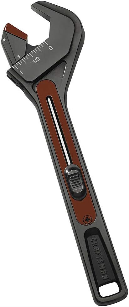

        PS I would love to know how the slider on thiis "Craftsman syw 27319 8Inch Mach Adjustable Wrench" actually works.
        Sadly they don't seem to work very well
        **LINK**
        I'm not sure why the lower lip comes out like that, maybe it's part of the attempt to ratchet (probably not a good idea in any case if one wants good strength…)
        J
        PS Wait! I just found out how how the engineering works!
        **LINK**
        A weak and poorly executed design.. but damned clever, I say.

                    Posted by John Smith 47 on 02/06/2021 20:37:54:
                    It looks clear from the relative movement ranges of jaw and slider that the grip is only going to be about 3x thumb pressure, and the user will usually have to change grip between setting and op. I wouldn't buy anything like this.

                        @Mick B1 – Particularly if you are compelled to press down with your thumb on the slider, it's and ergonomic nightmare. Either way it clearly doesn't have the strong clamping action of a Mole.

                                        Howard Lewis
                                          @howardlewis46836
                                          In response tom the question of how the adjustable spanners "work", the slider in the handle operates on a helix, so that the helix rotates and operates the worm that moves the jaw.
                                          I Found both the slider type and the "adjustable ring" type when in USA in 2000. Both have proved useful at various times.
                                          The slider type is particularly speedy in changing size compared to the conventional worm type.
                                          The adjustable ring type is more restricted in range, but gives a good grip on worn or odd sizes hexagons.
