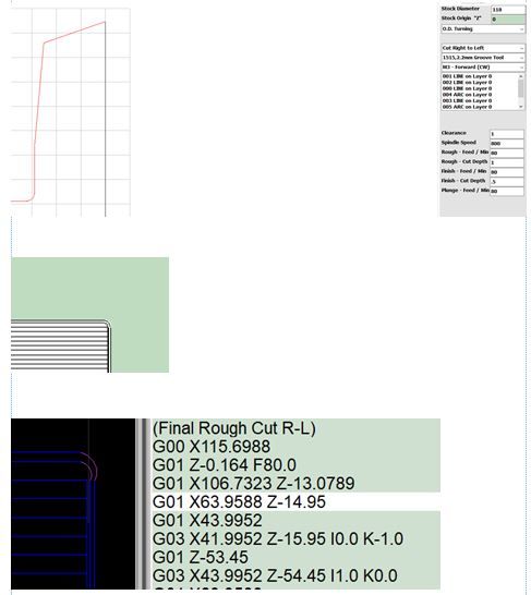

                            I don't know what the latest version of Ezilathe is but version 1.7.3.0 had some problems when looked at. It messed up radius calculations which would result in scrapping my sample file part when on the last few passes. It calculated a 2mm radius curve with a 1mm Z change and a 2mm X resulting in the tool going outside the profile and into the workpiece. It should have been 2mm for both X and Z. It may not seem like much of an error bit when you are deep into a wide groove the side of the groove would contact the tool over a large area.

                                  Here are some screenshots showing the error I found in Ezilathe, there is the original DXF page, the Ezilathe simulation and the Mach3 run page showing the actual path produced.
                                  I would also say that the Mach3 wizards as supplied are not perfect. I had to redo some of the facing wizard script due to faulty coding that had, for example, minus signs where it should have had plus signs. If anyone wants the corrected script let me know, it is just a short script so not a big file, I could probably post it in here if required.
