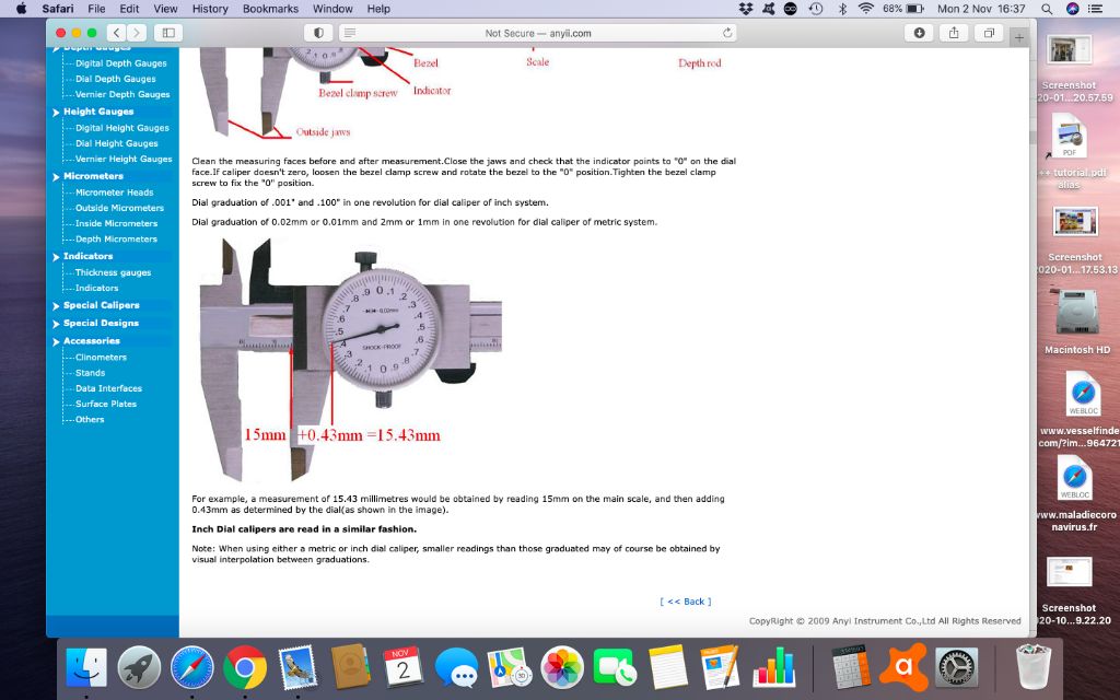

        Am I being really thick here. Thinking of buying a METRIC Dial calliper, but puzzled by how to read it. Imperial is simple, what you see is what it is. However METRIC dials have a dial marked in divisions of 0.02mm. The dial is marked 0-10,0-10.

          Yep 2 mm / rev is normal.
          Fundamentally a question of mechanical practicality.
          1 mm is near as dammit 40 thou so a 2 mm per rev dial corresponds to 80 thou / 0.08 inch so the sensitivity / accuracy of metric and imperial dial callipers is about the same.
          1 mm per rev is too sensitive to be sensibly practical. The rack and gear teeh become silly tiny.

            Clive has it, spot-on
            The Metric dial is just two 180° scales
