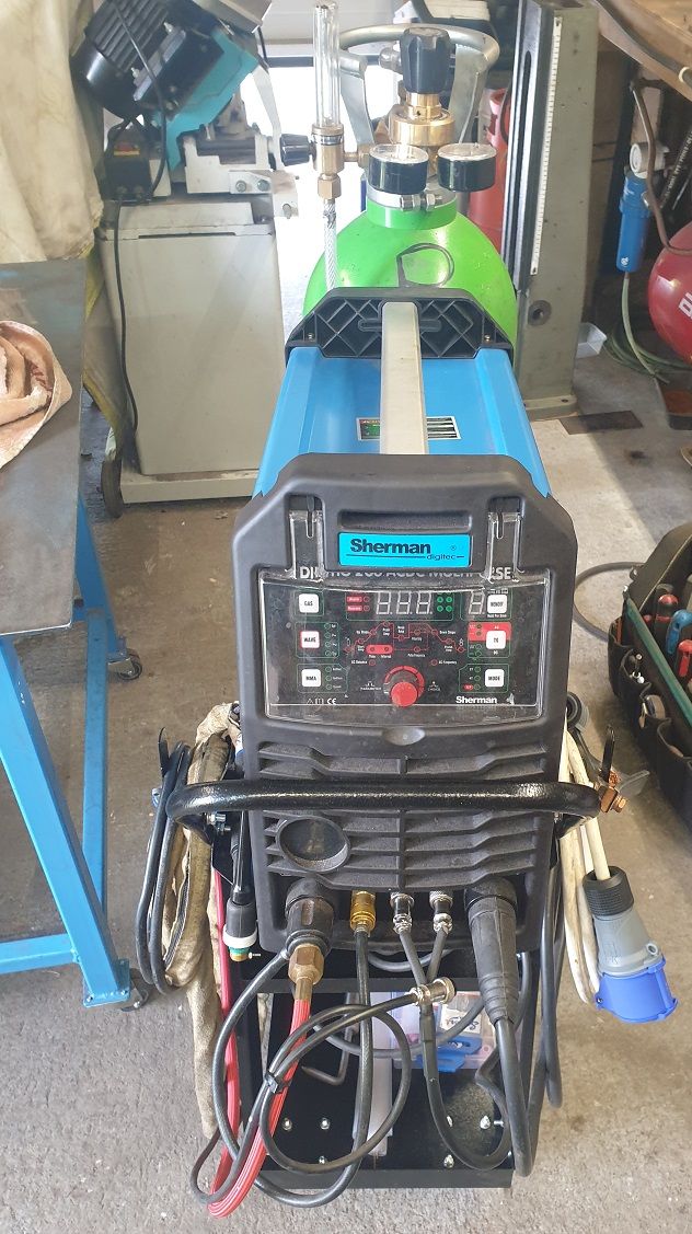

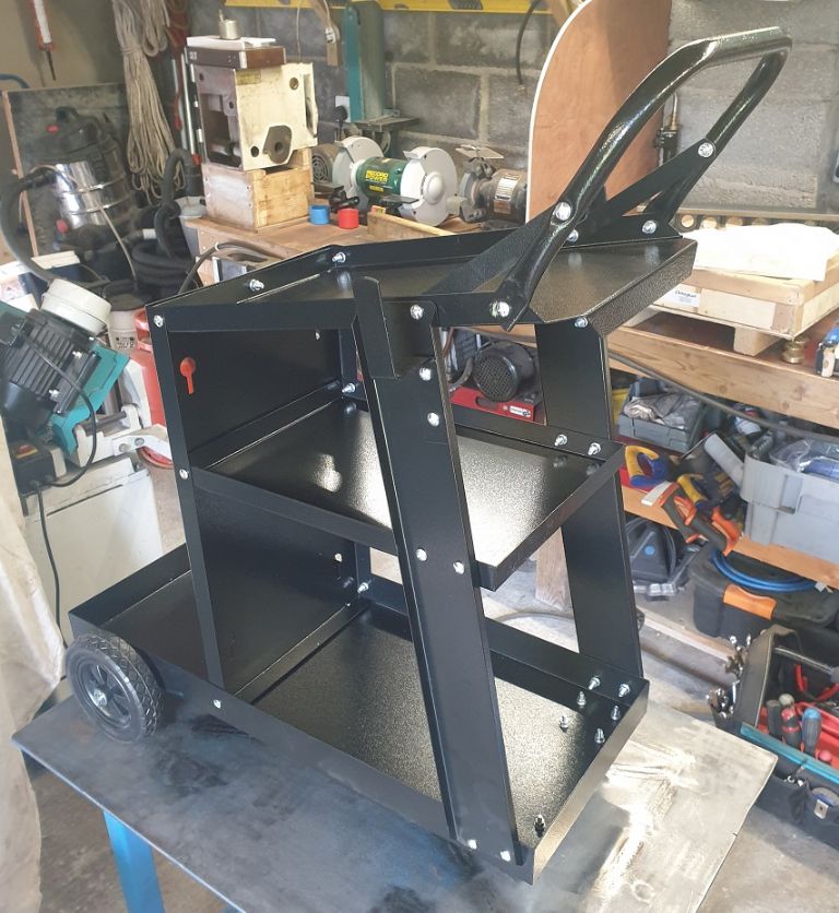

                                Well eventually got round to getting one of the budget £41 welding cart's form the bay of tat.
                                On unpacking I was surprised that the flatpack metal work was actually a bit thicker that I was expecting.
                                Instructions – no.. just an exploded view of the parts (labelled wrong!) but hay, it's not difficult, there is a picture.
                                As said, I've got a 30L bottle of gas but from the comments above it seemed like it was going to be ok and it was .. just!
                                The fasteners are all a bit too long so you either have them all sticking into the shelf areas or have them sticking out and attacked by them every time you walk past. Will have to set to them with a cut off wheel and cap them.
                                Because the top shelf slopes backwards the welder then sitting on it is pushed forward by the bottle, so much so that it's jammed against the cart handle.. not a real problem, it's not hurting anything.
                                I put a piece of plywood in the bottom under the bottle for a bit of extra support and to spread the load a bit.
                                The other down side of such a bit bottle is the top chain is barley half way up the bottle.. will do something about that.
                                I'm going to have to get some padding to go round the base of the tig so it doesn't slide around the top shelf and gouge itself on the protruding bolts.
                                The caster bolts have to come up through the bottom rather than down as they jam the castors so they need dressing down too as they mess up the bottom shelf.
                                Need to add some rod tube mounts but other than that, for 41 quid delivered I am surprisingly impressed. I couldn't have made one for that money as I would have had to buy the materials.
                                Yes it's cheap and rough but it's only to keep the clutter down in the workshop.

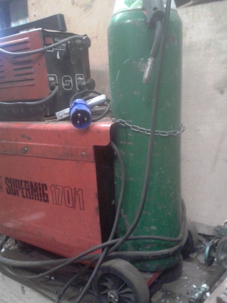

                                    Both of those cylinder chains would scare me, the bottom one can slip under the bottle and you have reduced the angle iron ability to restrain the bottle with your wood 'Improvement'

                                        Yes the bottle is too tall for those chains. When I get some small angle iron I intend to try and add a pair of uprights to the outer edges of the panel and use that to set the top chain somewhat higher. Having said that, I have tried to pull the bottle over and it only pulls the cart over and the bottom doesn't slip out, there is enough lip left to stop it. As I said, it's hardly being moved about just able to keep it out of the way.
                                        It certainly does the job..beer

                                                Hi Dave, I can't see any problem with them, although I wouldn't bother putting the bottom one on even. Every industrial one I've used, only has one chain, and they are more or less fixed at the same height proportionally, with a full size cylinder. My own Supermig 170/1 has just one chain, about the same height as the one Taf_Plems has shown, and it doesn't even have any type of bar at the bottom, in fact the cylinder hangs over the edge of the platform by a little bit, and its never been a problem.
