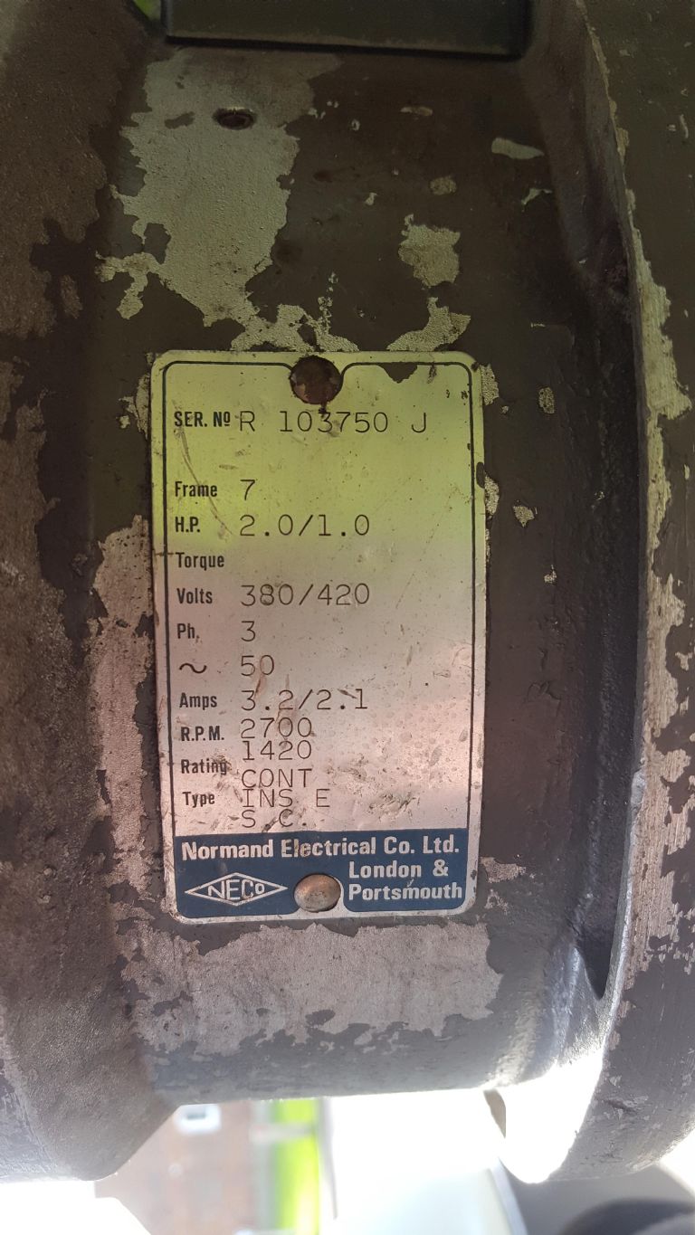

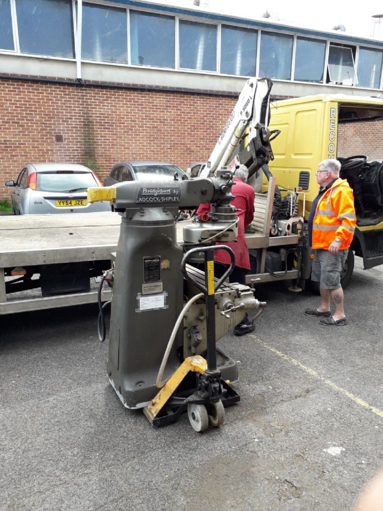

      img-20180426-wa0000.jpgHi All,
      I've just become the owner of a Bridgeport Mill. Even better it was free (except £150 delivery).
      On the motor plate it says 380/420, 3.2/2.1, 2700,1420, CONT INS E, SC, Frame 7, HP 2.0/1.0
      I want to run it off 240v single with a VFD. I have already setup a lathe like this. I assume that this motor would not be compatible as it's not 240/415 – could someone with more knowledge than me please confirm this please.
      I've attached a few pics.
      Any help much appreciated.

              The motor is definitely not dual voltage, although it is two speed. Presumably there's a switch in the control box somewhere that looks after the pole switching. Since the hp values are in a 2:1 ratio the pole switching is not accompanied by star to delta switching.
              The motor appears to be a "pancake" style which is integrated into the drive so will be tricky to change to asingle phase or dual voltage motor.
              Best bet is to find a way of generating some sort of approximation to 415V 3-phase. A good place to start would be to take Oldiron's advice.

                            You have what is called a 'pancake' motor and these CANNOT be converted to 220v. Your quickest way of getting it working from a domestic supply is to use a rotary converter (Transwave) but these are not cheap. I did use a static converter for a couple of years and it worked, but it was fussy about the higher speed if selected.

                                      If you have a motor rewinder near you it might be worth finding out what it would cost to bring out the star point and convert it to delta. I've actually done it on a bench grinder, but it didn't matter if that dies. Replacing a Bridgeport motor would be a bit more expensive to put it mildly, so consult an expert.
                                      #351908
                                      davidk
                                        @davidk
                                        I took my 3-phase Bridgeport 2-speed 380/440V pancake motor to a motor rewinder in Southampton. He rewound it for me, so it's now a 3-phase 2-speed 230V motor. It now runs just fine on an IMO Jaguar VXR inverter which is 230V single phase in, 230V 3-phase out. The rewinding cost me about £300 three years ago. I only power this motor with the inverter, not the rest of the (Denford) milling machine that the head is fitted to.

                                                  I removed the original pancake motor on my BP clone. It was a 1500rpm 220V 3-phase machine, so looks similar to the motor in the pics but suitable for VFD.
                                                  The replacement is a conventional 2.2kW 3000rpm (well, 2850 rpm etc under load) flange mount TEFC motor, so I can still develop the same power and torque at the original speed but can also run it at twice the speed.
                                                  I got the replacement motor from John Stevenson, along with a laser cut adaptor plate. The only work required was to clean up the flange plate on the lathe, then wire it up. Works like a dream. Pity that route is no longer an option.
                                                  My machine is a Taiwanese clone with fixed pulleys like the one in the pics. I could possibly flog you the old one as a solution but would need to check it's the same dimensions.
