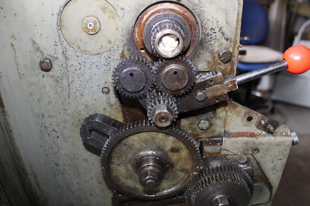

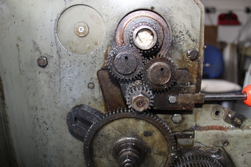

                            Steve Jones 20
                              @stevejones20
                              So, I followed instructions from “Know your lathe manual” and advice from those above (thanks guys, much appreciated) but I’m still having some issues. If I want to do some screw cutting I cant reverse the lathe.
                              Apart from the neutral position, when I put the reverse lever in the up or down position the main leadscrew revolves in the same direction as the main spindle.

                                Sounds like the tumbler gears are not engaging properly*, on my model C the lead screw turns the same way as the spindle with the lever in the up position (when using it for carriage feed the carriage moves towards the headstock) and 'backwards' with the lever in the down position.
                                * and possibly there is something else wrong if it is locking up/

                                  If you look at the two pictures I posted it shows the gears set in either direction, as I have a AUD the forward and reverse probably gets used more for saddle or cross feeds rather than cutting threads. Feed options are not available on a CUD.

                                      Sam Spoons
                                        @samspoons83065
                                        Have a look at Bob Brown's pics above the top pic the LS will turn the opposite way to the the spindle, in the bottom it will turn the same way. The only way this could be otherwise would be if both tumblers are not engaging in the 'down' position but the single tumbler was still engaging with the spindle fully and the top change gear. It's easy enough to check by turning the chuck by hand and watching the gears move.
                                        If you're still stuck tomorrow let me know I'll post a couple of short videos of how my Model C change gear work.

                                          Sam Spoons
                                            @samspoons83065
                                            First pic is forward second is reverse. In the first pic the left hand tumbler gear is not engaged with either the spindle gear or the on on the lower idler gear, they are connected by the RH tumbler. The odd number of gears mean the Layshaft will turning the same direction as the spindle, the second pic the RH tumbler engages with the lower idler gear but to the spindle only via the RH tumbler giving an even number of gears and reversing the direction of the layshaft. Your lathe has an additional gear in there which would reverse the direction (as well as changing the thread pitch) but it shouldn't affect the working if the tumbler gears.

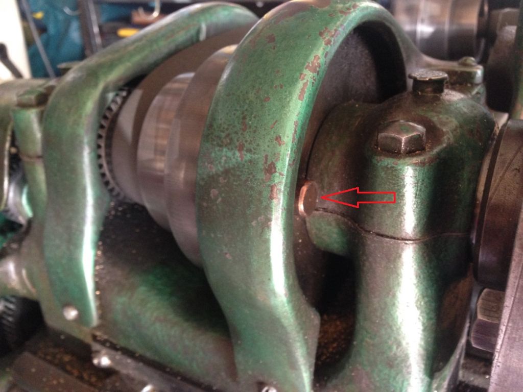

                                            Paul Lousick
                                              @paullousick59116
                                              Hi Steve,
                                              Your Boxford lathe is similar to my Southbend which was originally fitted with a reversible motor to change the direction of the spindle. It does not have gearing to do this.
                                              The lever on your lathe with the red knob is for reversing the direction of the lead screw.
                                              The lever at the back is for engaging the back gears that turn the spindle at a slower speed. But when engaged, a drive pin (shown in the photo) has to be dis-engaged otherwise they will lock-up and could cauld cause damage to the gears.
                                              Paul

                                              Hopper
                                                @hopper
                                                Take pics of the tumbler gears in the 3 positions of the lever and post them. We may then be able to tell you what is going on.

                                                  Sam Spoons
                                                    @samspoons83065
                                                    Posted by Paul Lousick on 19/04/2020 00:03:21:
                                                    Hi Steve,
                                                    Paul
                                                    This could be misleading as the Model C has a different mechanism for engaging and driving the back gears. The drive pin is replaced by a sliding bull wheel gear with dogs/pins that engage with the spindle pulleys. This is operated by the lever on the front of the headstock and the mechanism is quite hard to see clearly as it is buried up in the business end of the headstock casting.
                                                    But yes you are right, engaging the back gear without releasing the pin would lock the spindle (and Boxford used to recommend it as a way to lock the spindle for chuck removal though it is advised against these days).
                                                    I think the OP has stated that the problem is with screw cutting up thread and implied that the back gear 'trick' is not what is happening.
