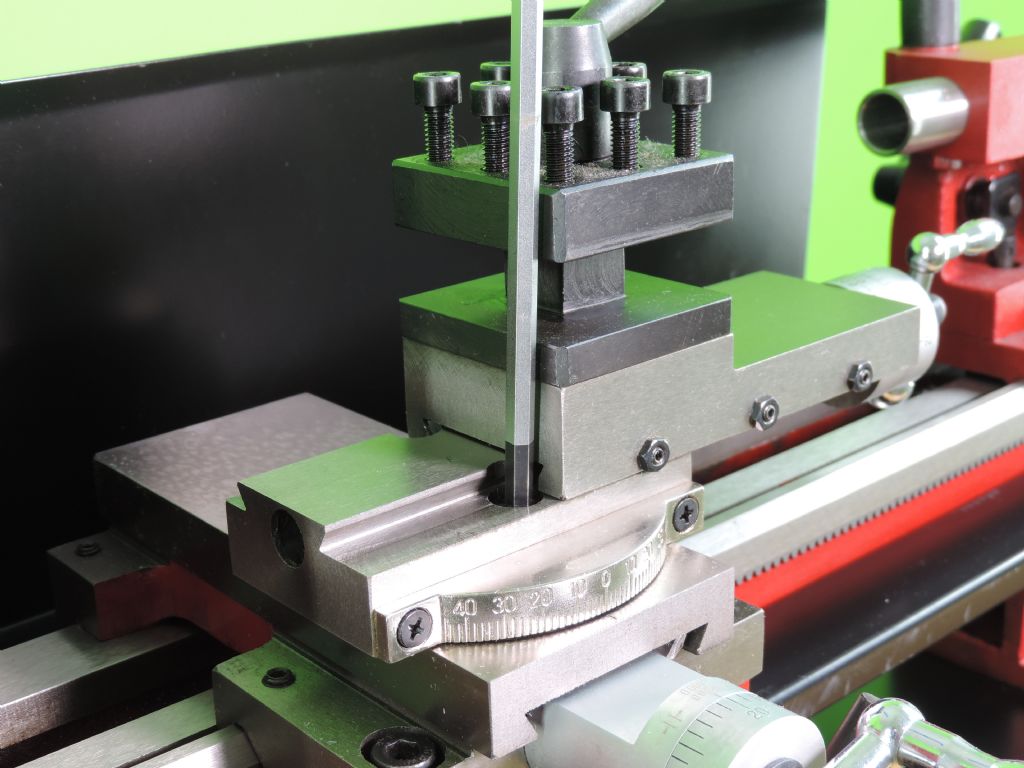

          angry 2Then comes some mini lathes and others where the way the compound slide is mounted causes it to carry tensile loads in what people would regard as the normal position for the slide. Shear idiocy really but given sensible sizes still very stiff but no where near a stiff as a correctly designed one would be.
          Can you explain?
          The compound slide mounting on a 'standard' mini-lathe is one of the most solid I've seen in a small lathe. I can't see any way it's inferior to that on the ML7 or S7.
          Or do you mean 'some small lathes' – 'mini-lathe' has taken on a very specific meaning these days.

            Oh yes I can Neil complete with a photo
            It's BAD design with a capitol B and has been used on several sizes. Not that it causes too much of a problem in this case but it may well in other areas of the cross slide when turning the full swing with any degree of grunt being applied by the tool.

              Ah, but that's not a mini-lathe as most people know it!
              In a true mini-lathe the base of the top/cross slide is ground flat and bears on the ground upper surface if the cross slide. The only PITA is having to wind it right back to adjust it.
