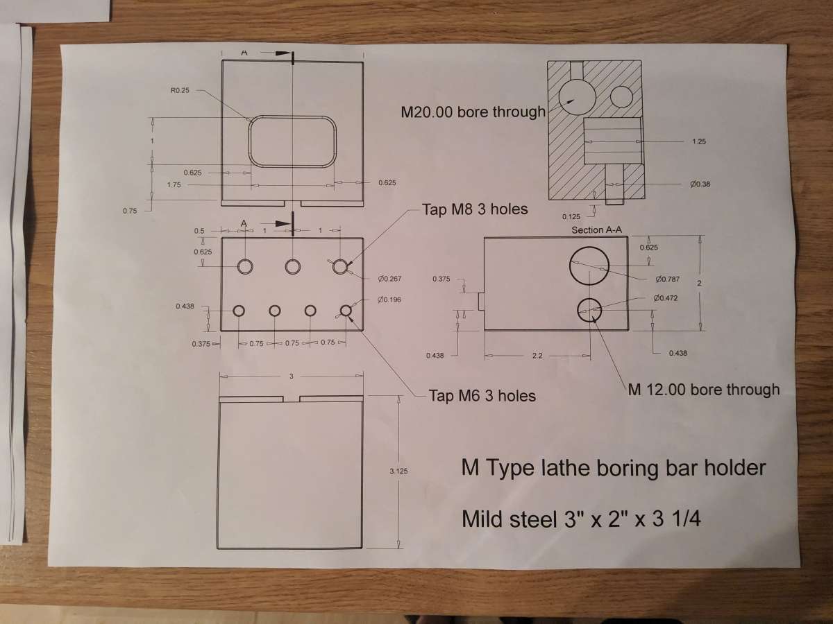

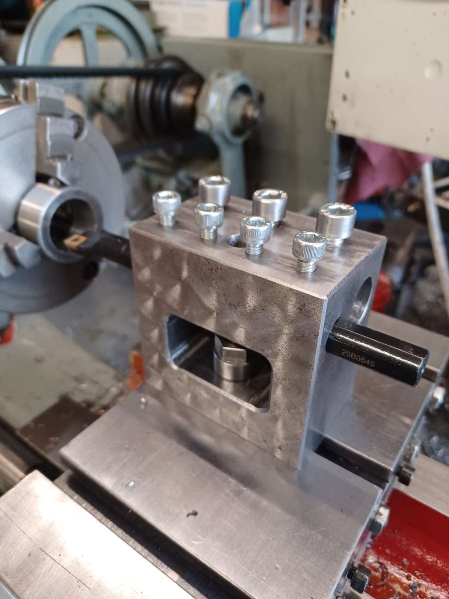

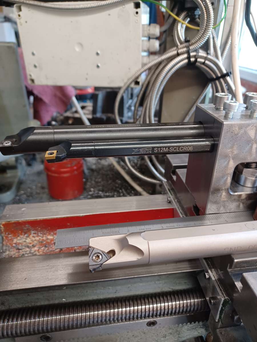

            Recently I decided to screw cut a large thread and found I wanted to use a full form insert which needs an insert size which will only fit into a 20mm diamiter toolholder/ boring bar. I found a piece of steel which will bolt to the crosslide with T bolts and which will allow me to drill a hole which will come on center height as that is the proper height fot the cutting edge of the tip. I drilled the holes using the main spindle to make sure the holes were correct height. When the holes as i cut two one 20mm and one 12mm side by side all I had to do is drill clamp screw holes on the center line of the two tool holes. The holder worked perfect and a solid tool holder for other jobs.

              I like that, David !
              Excellent design and execution.

                Great job David. Excellent idea. Only trouble now I need one. Oh well another day in the workshop coming up. 🙂
