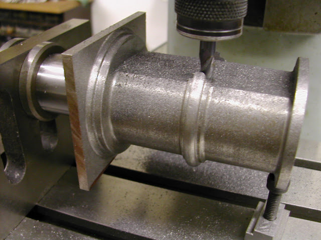

                                          For what its worth I have just found this pic which may be of interest.
                                          This is a cylinder for a table engine which is made from solid. All the outer ops were done to the bore using the expanding mandrel – in this instance it has been transfered from lathe chuck to angle plate on the mill.
                                          Just thought that it might help – but hopefully not – to add to the confusion
