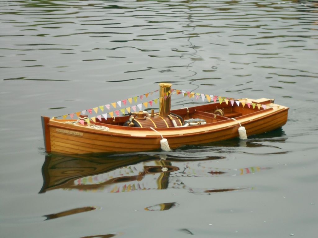

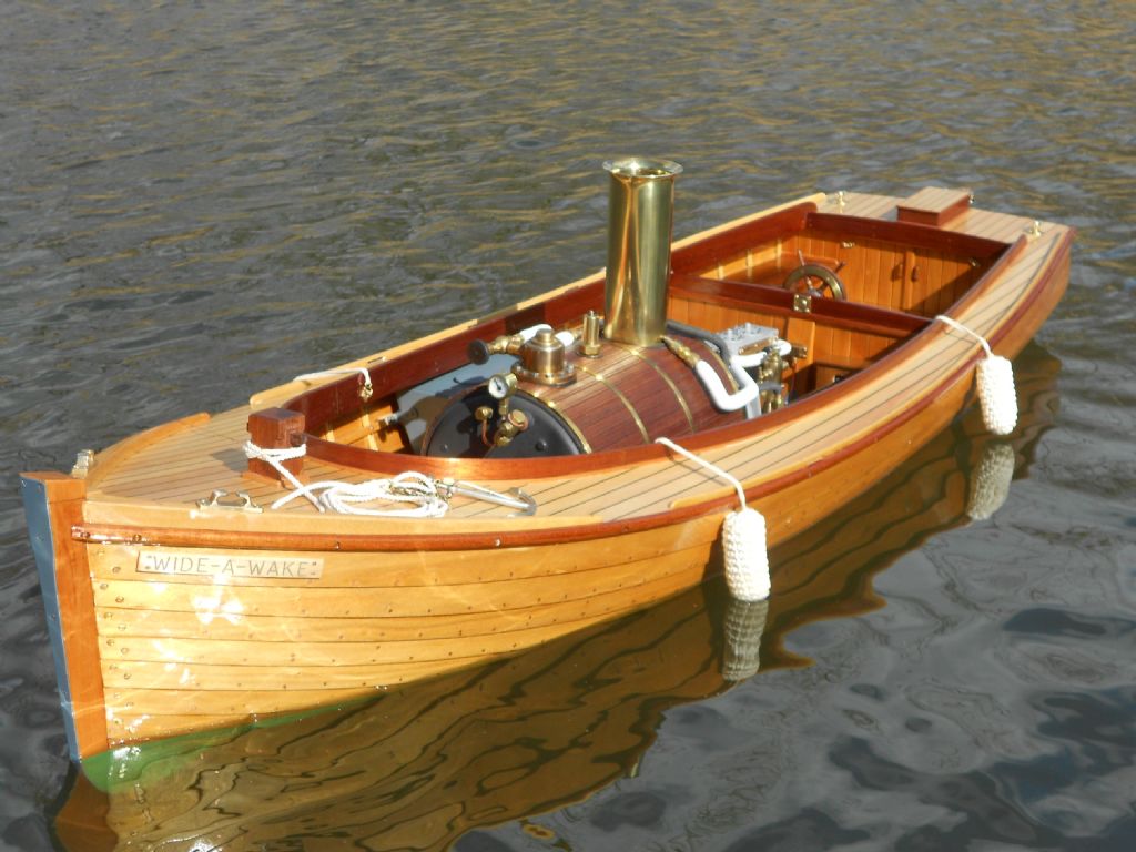

                            BOB – Here are two pictures that help show the difference of weight to a waterline.
                            This was taken for the ME mag just after the WaW was finished but before the 'official launch'. It has some water in the boiler but not at working level and the water tanks are empty.
                            This however was taken on the day of launching proper but with the boiler and water tanks full. You can see the difference that made on the waterline. There is no ballast in this vessel.
                            Sorry to rain on your parade but hope that's of more use
                            Regards – Tug

                                            Bob, I put the two pics up for nothing more than to show the difference a slight increase in weight can create to a waterline. The model was serialised in ME and also a full build log was on MEM here which describes all the wood processes.
                                            Though you obviously have a desire to make it yourself, personally, if I were you, I would look into obtaining a fibre glass hull and fitting that out with your steam plant. You will still have an awful lot of very enjoyable work to do to accomplish that.
