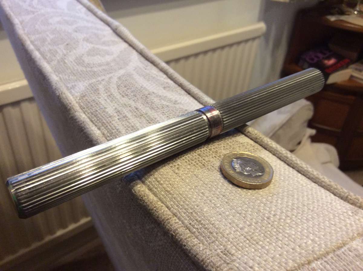

                I have to admit that knurling stainless is not my most favourite job but for a particular job I do on 16mm dia is to cut it IMG_3484on the shaper as it needs to be quite long. but IMHO if you do knurl it conventially do it in the shortest possible time to prevent work hardening.

                                              For press-in guitar bushes in stainless you can plane them with a lathe tool set sideways. I turn a shallow runout groove and use a simple index using a change wheel. I’ve made bridge, tail piece and tuner bushes using this method. It’s slower than a rotary knurl but reliable.
