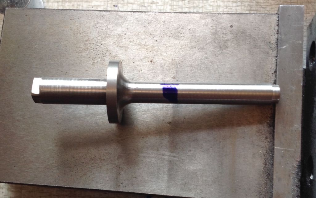

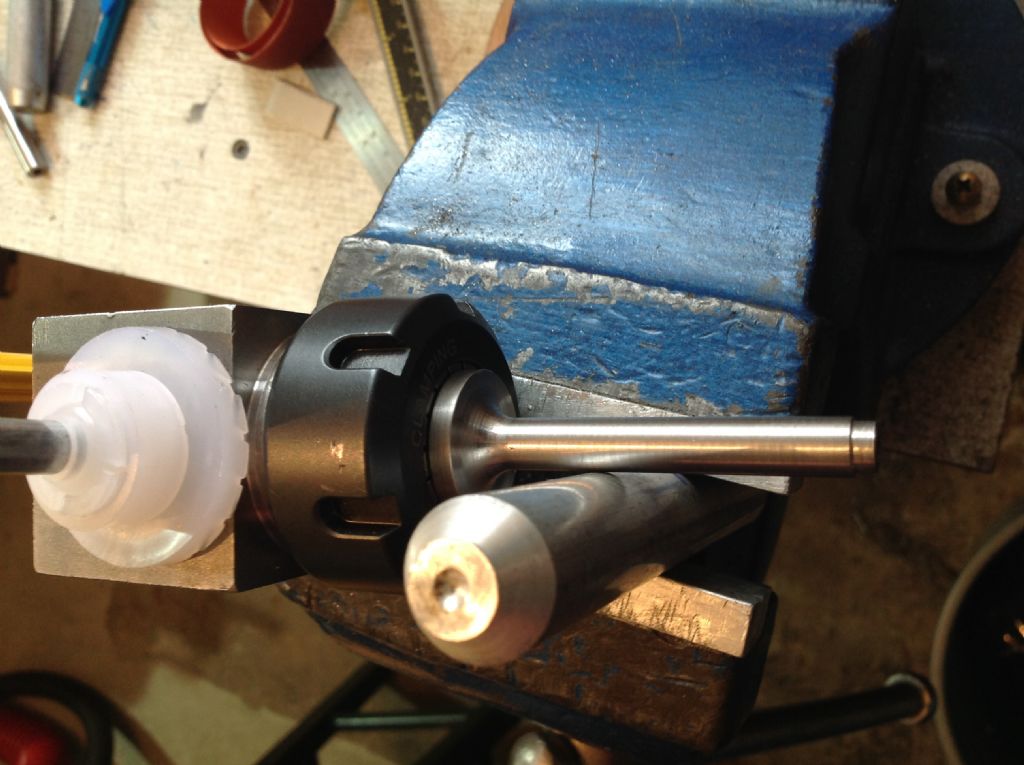

      I have to put a 45deg bend in this part where it meets the pin. The 10mm shaft that's in the collet has to remain true as it will run in a bush, the 25mm collar stops me using a normal 2 pin approach (I think).
      Heat or not?
      Would you build a differnt jig?
      How would you do it?
      Edited By Paul Ainsworth on 19/10/2019 10:37:26

          Assuming that the large pin in the vice is where you want the 45 degere bend and that in fact its a radiused bend (large pin ) then a second pin snugly against the radius of your 25mm collar should hold it all.
          Needs to be firmly mounted in your new jig. Lots of heat away from jig, quickly inserted and pulled around with some form of lever pivoting on your large dia pin? (Just like a copper plumbing pipe bender with shaped pressure plate to protect the part being bent)

            If so, I suggest that you abandon the collet idea (it is likely to get too hot), and find two steel tubes, one large, one small, to fit over each end of the part. The fit needs to be loose enough to fit easily over the small end even when it has expanded with heat (say 1-2mm clearance); the tube for the larger end can be a light push fit, or if looser than that, make a slot along it so the vice will close it onto the part to hold it firmly in the vice. The larger diameter tube will be held in the vice horizontally (so the full length of the tube is held firmly with the part inside it). Then heat the length to be bent with a fairly large flame (a big propane job or oxy-acetylene), and when the relevant length is nicely red-hot, slip the short tube over the end of the part which is sticking out, and pull it towards you keeping the newly-bent section horizontal (or it might slip round in the vice).
            Depending on how accurate your 45 degrees needs to be, it would help, before you start heating, to mark a template (eg cardboard) with the required angle as a guide to the pulling operation. To get the angle exact, if your first go is not good enough, it would be best to wait until the whole set-up has cooled (eg overnight) before you heat the bent section again, otherwise the whole thing is going to get much too hot – vice as well. It might be possible to tweak the angle a degree or two when cold, using the same tooling, if you handle-tube is long enough, the vice is firmly bolted to the bench, and the bench to the wall. The more you can concentrate the heat on a short length, the tighter the radius will be, and the harder you will need to pull.

              Use heat & don't use the collet.

                Better photo without collet, bend needs to be on blue mark in line with one of the end flats.  303 stainless

                  If the first attempt ends in disaster, somehow, I suggest that your second should delay machining the flats until the bending is done. That way you line the flats up with the bend (easy) rather than bending a red hot bar in line with flats you can't see.
                  303 should bend OK with my method, but don't cool with water or anything else. Just allow to cool. And the blackened surface will respond to fine abrasive just like mild steel.

                    As for the bending I think I would have roughly encased everything that is to stay the same in some sturdy structure. Then cast in a lump of low melting point metal for a perfect supportive fit. Possibly complete with a bend radius and direction guide – maybe an external flat on the casing parallel to the flat on the part for direction reference.
                    Then I'd go with brute force sliding pipe extender or press for the bend. The 3xx series is quite ductile, and 10mm should be within manual range even cold.

                      Make a dummy split collet, clamp it solid in a vice and use a oxy propane pepper pot burner to heat it up and the bend to suit. Afterwards pack in dry sand to allow it to cool slowly.

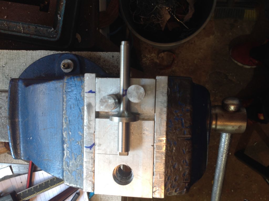

                        Revised jig, I'll see how this goes.

                          New jig worked a treat, thanks for advice fellas. Steep learning curve this stuff as I only started messing with metal recently.

                            Just the sort of jig used for production work in a forge!

                              The end result
