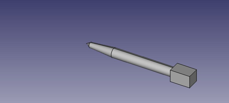

                    Simple tools are a popular starter choice. A centre-punch can be made entirely on the lathe. As an exercise, Aluminium, Mild-steel or Brass will do. If the punch is to be used, turn it from Silver Steel and heat treat to harden.
                    At first avoid unknown scrap because a lot of it doesn't machine well/ Ordinary mild-steel is OK rather than good. Most brasses machine well. Otherwise, when buying metal, look at what the spec says about machineability. Of the mild-steels EN1A is good, EN1A-Pb (leaded) is even better. 6061 Aluminium is good.
                    The centre-punch consists of a parallel turned section, a shallow taper, and a blunt point. For extra fun. it's conventional for the end hit with a hammer to be squared off.
                    First attempt might be to reproduce the approximate shape with a reasonable finish. Second attempt is more difficult: it is to make the item to size from a dimensioned plan. Most metal working lathes should be able to get within 0.02mm without too much trouble.
                    Being a metric fanboy, I've dimensioned the plan in millimetres, but if your lathe is Imperial, note they are all common inch sizes. 3.17mm is 1/4", 25.4 is 1", 12.7 is 1/2", 19.07 is 3/4" etc. The lesson here is how to understand a plan, which might be faulty or dimensioned in unexpected units, then planning a sequence of cuts, and then doing them accurately on the lathe and perhaps other cutting tools as well. A centre-punch isn't critically dimensioned, so mistakes are allowed, and tolerances low, but many other jobs need more care.
                    Don't get too hung up on accuracy: most model engineering uses a technique called fitting in which a hole is drilled or bored to nominal size, and a shaft is turned to fit it, cutting first by measuring slightly oversize, and then shaving off more off the diameter step by step until it fits the hole: the exact measurements don't matter much.
                    Don't think the centre-punch is too simple – not difficult, but harder than it looks.

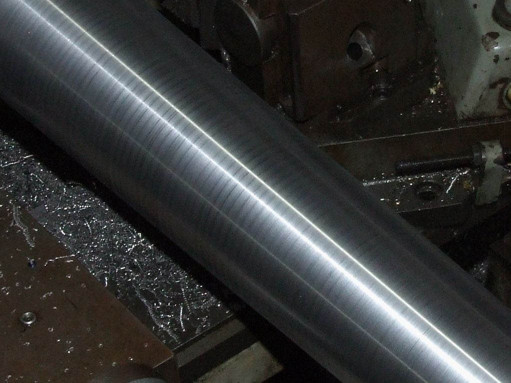

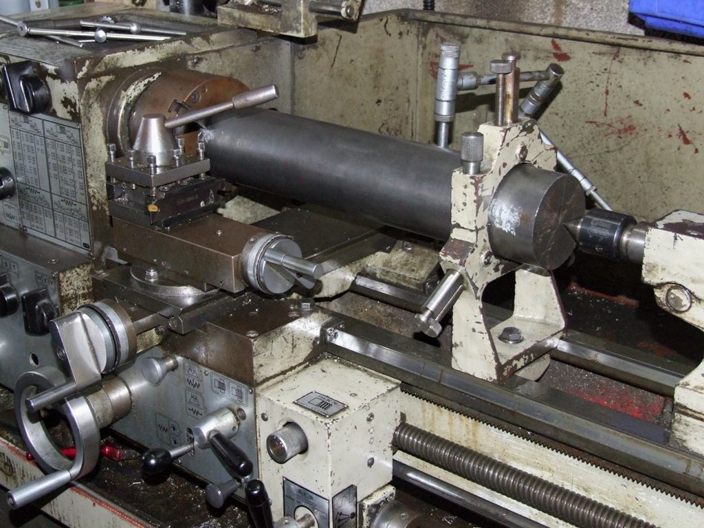

                        Anonymous
                          Posted by Steve F on 30/05/2022 10:57:00:
                          …be careful of the stuff on Ebay. I have had some pretty rubbish stuff arrive…
                          I'd concur, for steel in particular the supplier matters. I bought this lump of 4" diameter steel on Ebay as it was cheap:
                          It was to be used as a former for bending sheet metal so quality didn't matter. Just as well, as the finish was poor:
                          For smaller diameter (less than 1" diameter) I buy a standard 3m lengths from metals4u. For larger diameters, and specialist alloys, I buy from m-machine in Darlington.
                          Andrew
