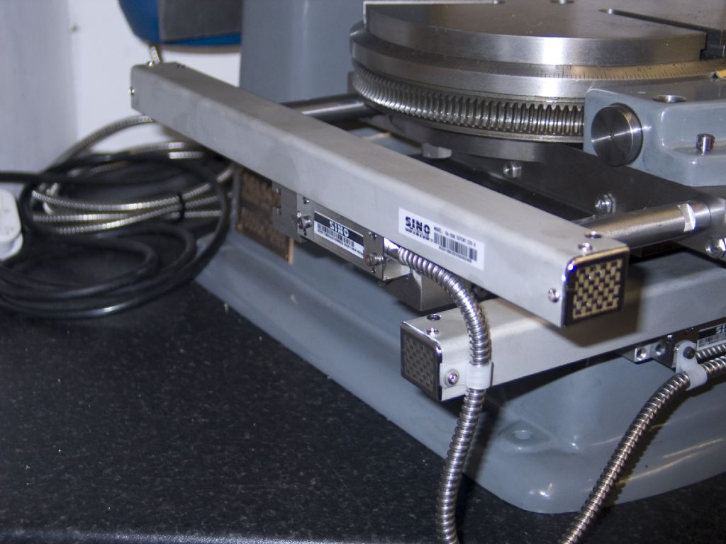

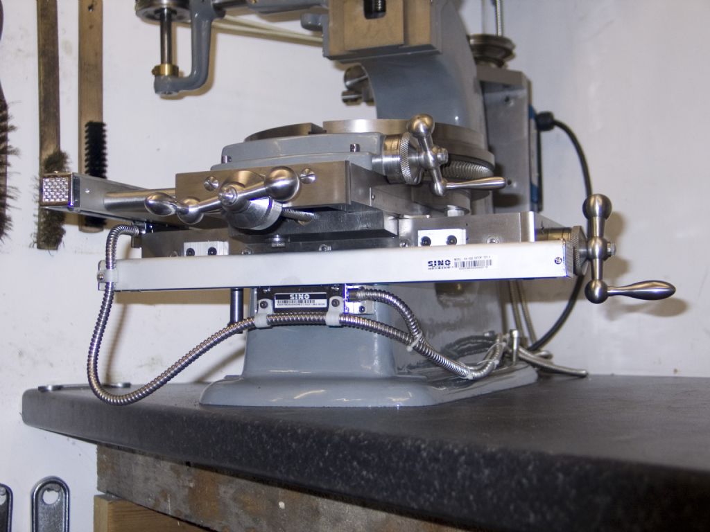

              I didn't bother with a DRO on the Z axis of my Boley & Leinen jig borer, I just did the X & Y axis.
              For the Z axis I did however add a conventional micrometer depth stop which serves its purpose very well.
              Phil

                      The guy I bought the DRO kit from is called Colin Robinson, his company is called C B R Electronics in Nottingham.
                      He also sells on ebay as username "3977colin".
                      The kit has performed without fault since I installed it, you need to make sure and ask him for the slimline scales as they take up much less space.
                      Glad you like the micrometer depth stop, I do use it a lot.
                      You need to make sure the gib on the Z axis is not loose, if it is the head can tip over when you come down onto the micrometer as it is offset to one side, other than that it is very simple to use.
                      Phil
