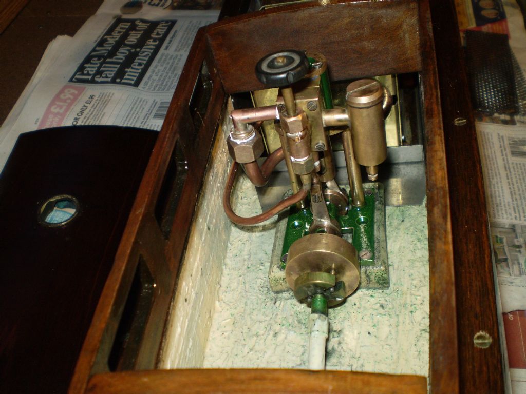

                  Ive got one of these engines in a steam boat, I took measurements from it when I stripped it down to have a go at making one.
                  #565192

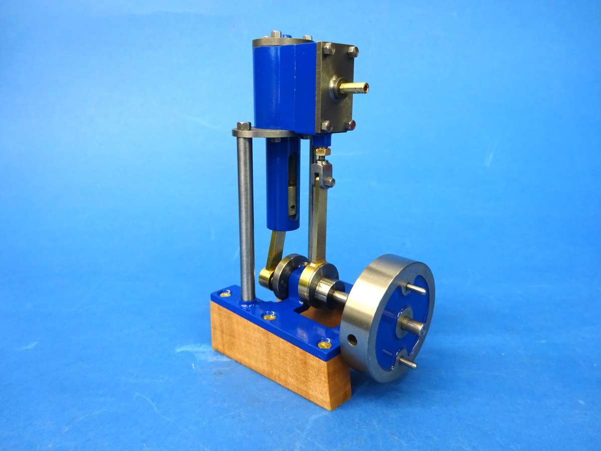

                        So here are a few shots of the finished engine
                        Quite pleased with how it turned out and an enjoyable little one to make and would certainly suit those with smaller machines. It would be possible to do it without silver soldering the base for those that don't feel upto it by using a bit of JBWeld together with the screws to keep things held together.
                        A few video clips now, there is a bit of vibration as the speed starts to increase but it works through that and smooths off at the top end, I could not see any signs of balancing in the photos I based it on so did not include any but the flywheel could be played with id desired.

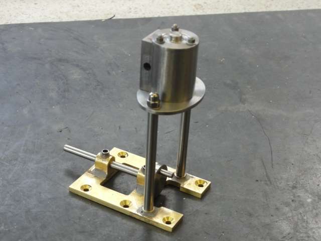

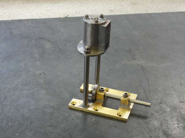

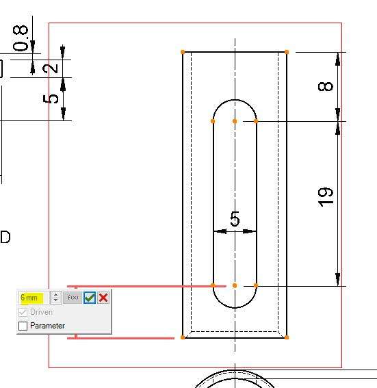

                                      I’ve made a start on this engine and have got to the point where I’m about to cut the slots in the trunk guide.  I am puzzled by the dimensions on the drawings.  The overall length of the guide is shown as 33mm but the length of the slot is shown as 19mm between the centres of 5mm dia plus 8mm each end between the centres and the ends making a total of 35mm.
                                      Am I missing something or is there a miscalculation and I need to make a new 2mm longer guide.
                                      Jim
                                      #791417
                                        The slot is not symmetrical vertically, so 8mm at the top but 6mm at the bottom to make the 33mm total. I think that in the photo I am milling the slot with the top towards me which makes it look symmetrical as some of the guide is hidden by the vice jaw,
                                        6mm
                                        #791418
                                        Jim Nic
                                          @jimnic
                                          Just as I thought, I was missing something and making incorrect assumptions.
                                          Thanks for setting me straight.
                                          Jim

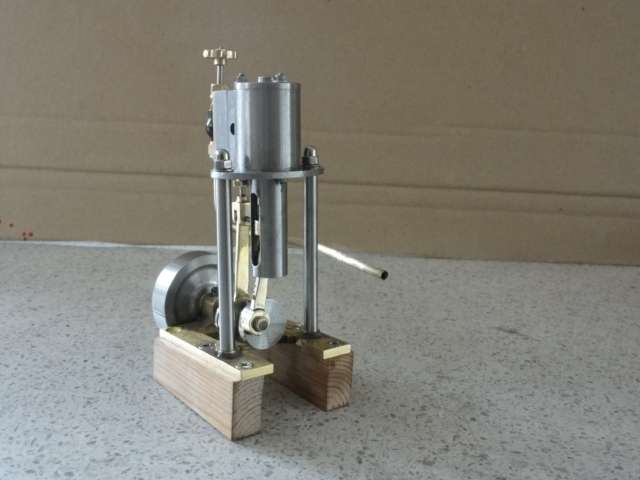

                                            Although not nearly as rapid as Jason, steady progress is being made.  Having messed up the first cylinder while milling it into a circular form, a second was produced and assembled with some other pieces into the family shots shown here.
                                            Family 1
                                            Family 2
                                            I underestimated the size of this model, it is a good deal smaller than I thought.  However this brings its own challenges and I am enjoying making it.

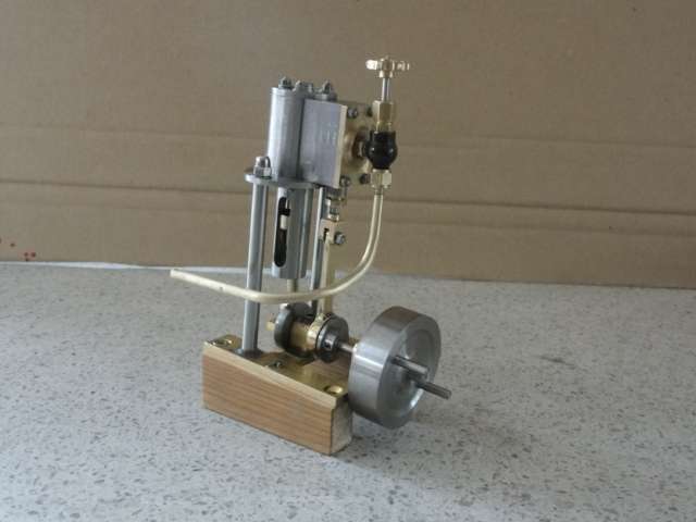

                                                At last, after diversions for life, gardening and DIY manufacture of the the Eclipse is finished.
                                                Family 3
                                                Family 5
                                                I have had it running and it’s a very smooth fast engine.  Unfortunately the camera played me up so no video.  It is now disassembled for painting and a movie of it on it’s proper stand will definitely be along shortly.
