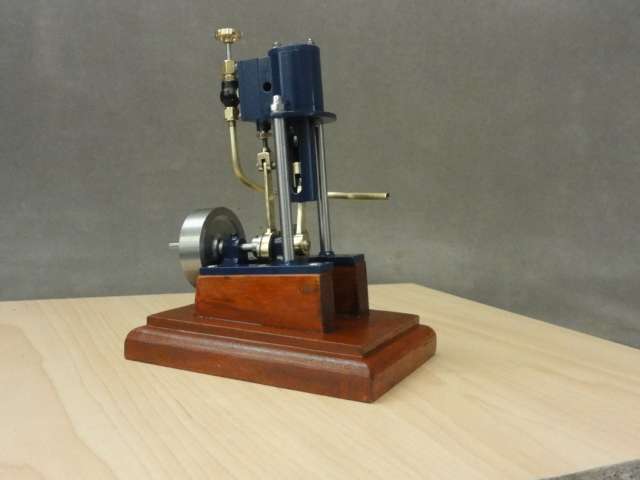

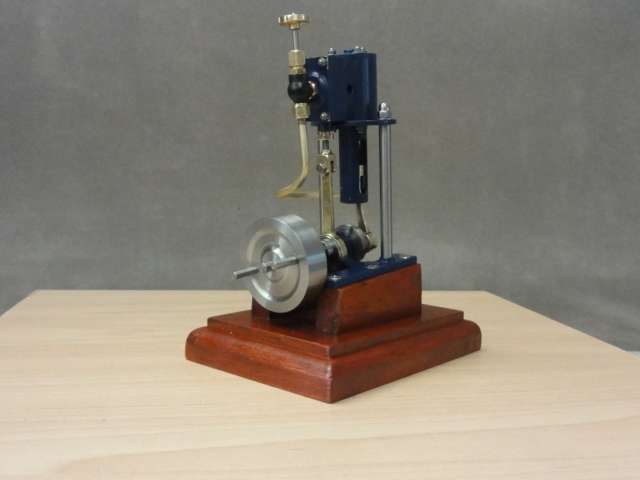

      At last my Eclipse is finished. This was built from Jason B’s drawings which he made from an old Basset-Lowke magazine advert and adapted to metric units.
      Painted 1Painted 2
      Although it has been a few months since I started work on it actual production hours were in keeping with the engine’s size (flywheel dia 35mm).  My smallest engine to date and a very enjoyable project.  Most materials, even the air control valve, were from stock in hand so the only purchase was 2 “O” rings for the valve rod and the piston rod.
      It runs a treat and with 35PSI of air I have seen 3200 RPM on it.
      Thank you for the design Jason.
      Jim

        That has turned out nicely Jim.

          Yeah, looks good Jim, nice to see your active, well done.
          I like the display presentation tilting the base supports “marine style”.
          Jason’s article in M.E. magazine was a good read I enjoyed it
          Atb Geoff
