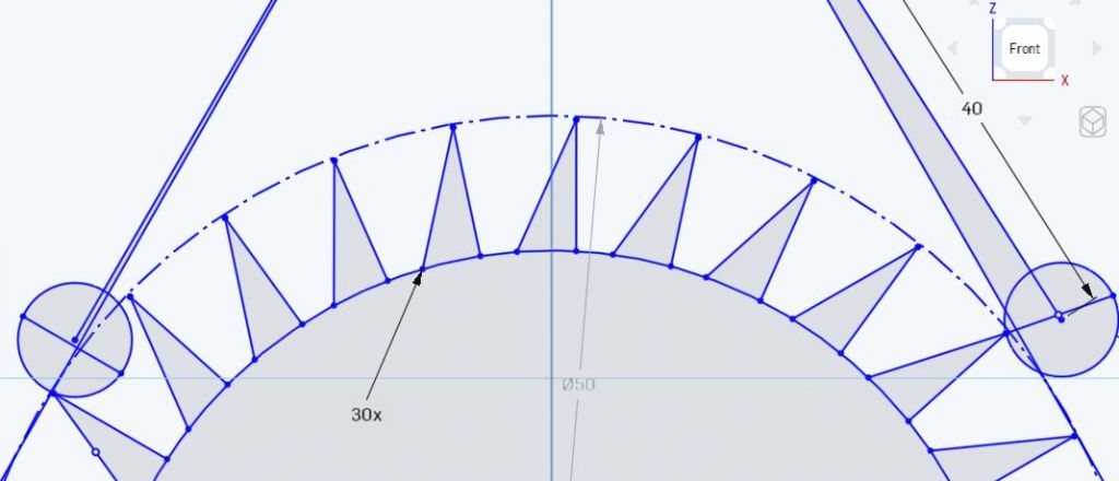

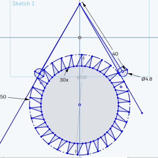

              Thank you for the ongoing advice, suggestions and comments, which I have been reading and trying to apply. Below are two pictures of my latest version. A few key details:
              • The functioning portion of the pallet is half of the diameter of the pallet less half of the drop
              • The operating faces of the teeth are a smidgen under 90 degrees to the tangent drawn from the pivot point of the pallet arms to the OD circle of the escape wheel.
              • There are 30 teeth on the wheel.
              • The wheel is 50mm OD
              • The pallet arms are 40mm long.
              I think that, unless it is clear that I have made a glaring mistake somewhere, the next step would be to construct a test version.
              Regards,
              James.
              Edited By James Alford on 24/05/2016 08:06:09
              Edited By James Alford on 24/05/2016 08:07:01

                You could study the active tooth face flank by drawing an arc from the pivot just touching the left hand pallet where it's up against the tooth locking the wheel. That's the path the pallet will follow when the pendulum carries on swinging after the impulse.
                Edited By Ajohnw on 24/05/2016 09:48:46
                #240018
                Russell Eberhardt
                  @russelleberhardt48058
                  That should work James. Any slight errors can be corrected by rotating the pallets slightly.
                  Russell.
                  #240128
                  James A
                    @jamesalford67616
                    Thank you for the feedback. I shall leave this part of the overall clock design as it is for now and make small changes and adjustments once I have actually started to build it. I shall now move onto other parts of the design.
                    Regards,
                    James.

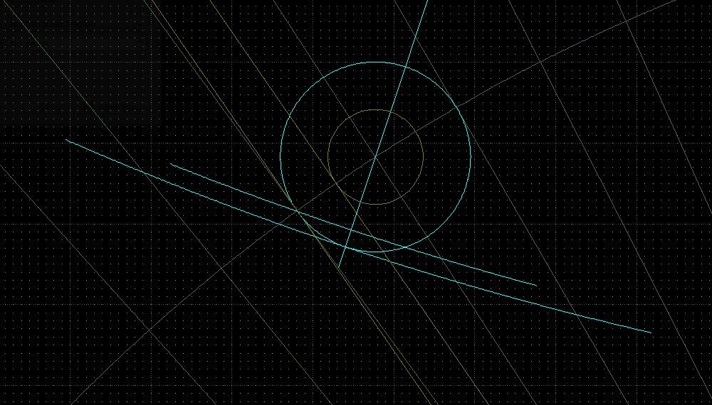

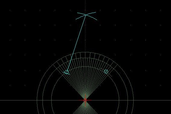

                      I've made a start at drawing one. 60 tooth, 2.25mm dia pallets. 2 degree impulse angle I've allowed 2.35 for drop. No teeth yet but the long radial lines are for the flanks and the short ones 1/2 the tooth angle.
                      The whole drawing
                      An enlargement of the left pallet at lock with a rad showing it's path as the pendulum swings further after an impulse.
                      The rad is not far of a straight line. Yet to find out how to get an angle out of the cad package and haven't got me head round what it will look like when the other pallet is at lock – pendulum swinging the other way. Suspect I will draw it again. I saved the angled rays separately 'cause they took a while to do.
                      To construct it I put the pallets where they should be ( I hope ) and then worked out from the pallet diameter the pivot needed to be to get the impulse angle. Then struck that as arcs off the centre of both pallets. It should save trying to rotate the wheel but results in the pivot being slightly off 90 degrees to the wheel.
                      I worked out what the rad of the locking pallet should be and drew that so that I could lock the pallets to the intersect of the rad and the 1/2 tooth pitch angles.
                      Edited By Ajohnw on 24/05/2016 22:17:51

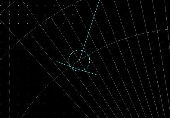

                        I add a 1/2 pallet diameter circle to see what the flank looked like parallel to to a tangent from the centre of the wheel to that circle. That's in dark yellow. I also added a rad showing where the extremities of the pallet go when the pendulum continues to swing.
                        surprise The flank at that angle looks about right to me. It's not far off radial. Any thoughts?
                        I'm using LibreCAD. I tried the other I mentioned but it got upset adding constraints to all of those lines at an angle. It is an easy to use package though. LibreCAD isn't looking too bad in that respect either. One minor problem. When I had the reference point on the centre of the wheel I should have clicked Lock Relative Zero to stop it moving that style of reference around when ever I drew anything. When it's off the reference becomes the end of the last thing drawn which is how these packages are often used.
                        Actually the faint dark brown should be dark yellow but I doubt if the package picks up my unusual colour management correctly so may not display correctly here.
                        Should have drawn the arcs in that too. Easy to fix, select, hit delete and draw them on the correct layer.
                        In this case the flank angle is 1.5 degrees of radial.
                        Edited By Ajohnw on 24/05/2016 23:32:06
                        Edited By Ajohnw on 24/05/2016 23:42:47

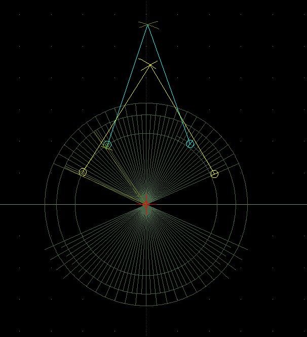

                          Just tried drawing in a larger tooth span.
                          The flank angle stops the same. As it should done this way. Just checking.
                          I haven't worried too much about the tooth span on these. blush I think it's an odd number but it would be a lot clearer if the teeth were drawn in. So next job. Currently LibreCAD can't repeat shapes at angle or holes in a circle unless I am missing something. Other than that I'm pretty impressed with it. The various snapping options work well and the ability to snap on points and set sizes with a mix of mouse or typed in numbers is useful.
                          devil I have a feeling that I will span near 180 degrees. Do it again now and check my calc of the wheel dia as it looks like it's slightly in error. I'd allowed 0.1mm lock and no level of zoom shows it. Could be down to line thickness but more likely me.

                            #240356
                            Ajohnw
                              @ajohnw51620
                              It seems that LibreCAD has a copy and rotate n times facility which would make the drawings I have done so far a lot easier. So it can do pcd's etc.

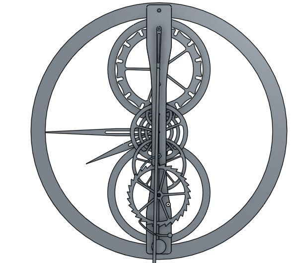

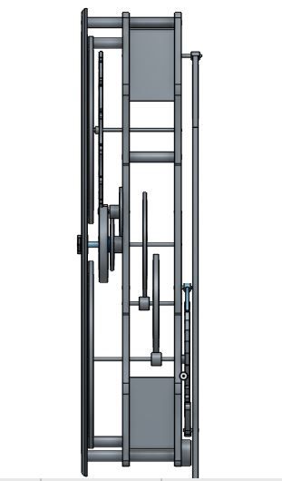

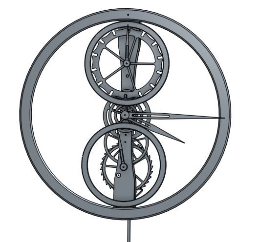

                                          After what seems like forever, I have finally finished a design for a clock powered by an electromagnetic solenoid and magnet.
                                          In the design, the batteries will sit in the box that is sandwiched between the frames at the top, whilst the circuitry to control the solenoid will be in the bottom box. The electromagnet sits between the rear plate, at the bottom, and the pendulum, with a magnet attached to the pendulum.
                                          I have found a circuit diagram for a comparator circuit that is designed to impulse the pendulum once its swing is below a certain point.
                                          The bottom of the three dials is a seconds hand, with the top dial, driven by a Geneva wheel, shows the days of the week, split into morning and afternoon.
                                          There is still some detailing to do: the pendulum rod is shown as a square section and it is shown suspended on a pivot rod; it will be a round rod and will probably get a conventional suspension.
