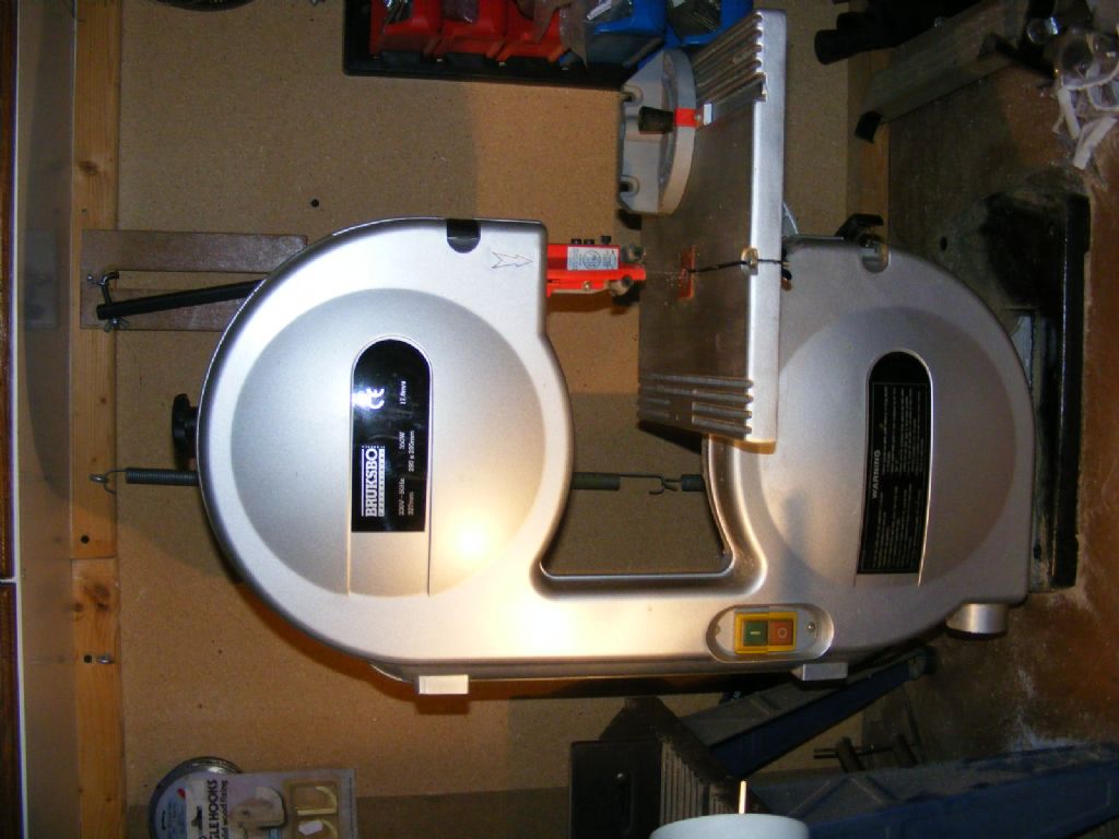

      About 19 years ago I bought a small bandsaw for woodworking. I was living in Sweden at the time and the saw was a Chinese saw badged "Bruksbo" for one of the retail chains. The saw has been used for cutting wood and plastic materials. It has not been used much but it is very good for cutting out intricate shapes. I am sure the same saw must have been sold here in the UK badged for retailers here.
      The saw is shown above.

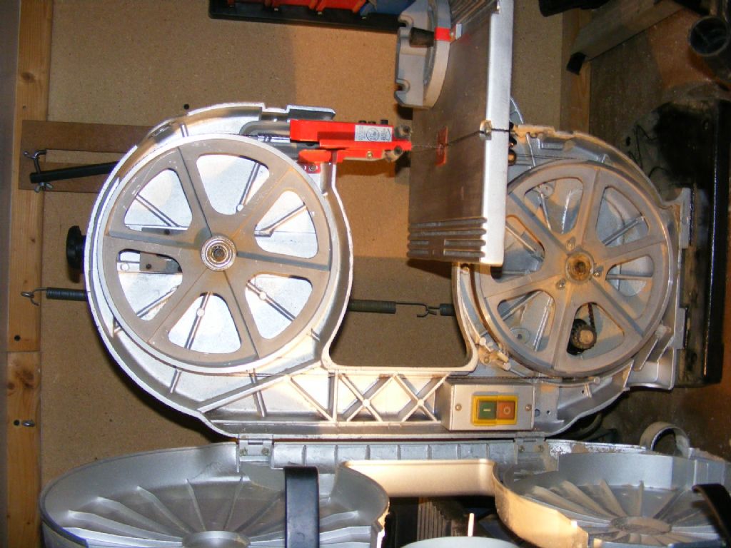

      I was using it yesterday and it suddenly started making a grating noise. On opening the cover it was apparent that the plastic tyre on the upper wheel had disintegrated into three pieces. It had become brittle with age. The tyre was about 3 mm thick, 12 mm wide and the upper wheel has a diameter of 237 mm. The photo below shows the saw with the door open.
      I have made a temporary repair by sticking the three pieces of broken belt back onto the wheel using double sided carpet tape. This seems to be working OK but I would like to buy two new tyres in order to replace the two original tyres
      Does anyone know of a UK supplier of bandsaw tyres for these small hobby bandsaws?

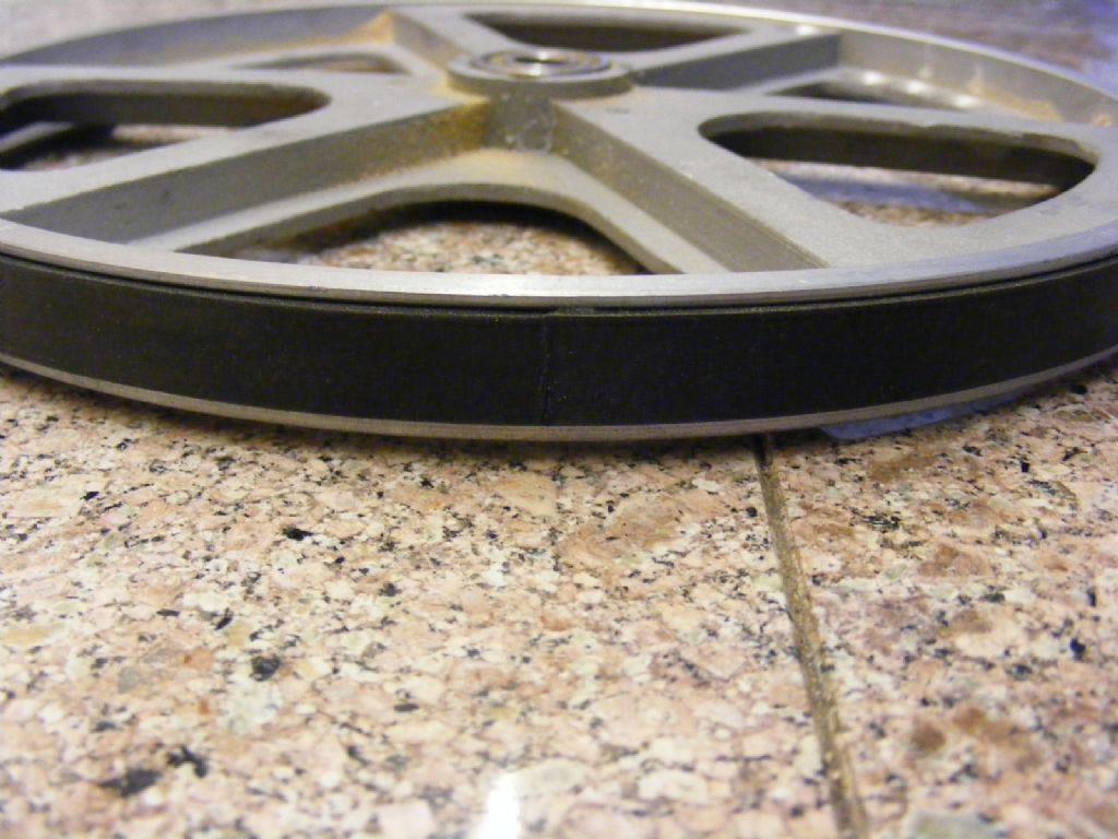

                        Peak4 – I like this idea but to wrap around a 237 mm wheel I will need a strip 750 mm long. I cannot find the cork gasket material in a sufficiently long length. However, I have found solid neoprene rubber strip that is self adhesive and available 12 mm wide and 3 mm thick in 5 metre lengths at a sensible price so I am going to order some and give it a try.
                        Brian – I shall wrap some insulation tape around the existing temporary solution to try to improve matters pending the arrival of the neoprene strip.

                                    I have made a new tyre out of solid neoprene rubber strip 3 x 12 mm. This was spliced with a scarf joint and bonded using cyanoacrylate adhesive. This photo below shows the join. Double sided carpet tape was then used to bond the tyre to the wheel.
                                    The new tyre seems to be working well and the bandsaw is now back in use.
