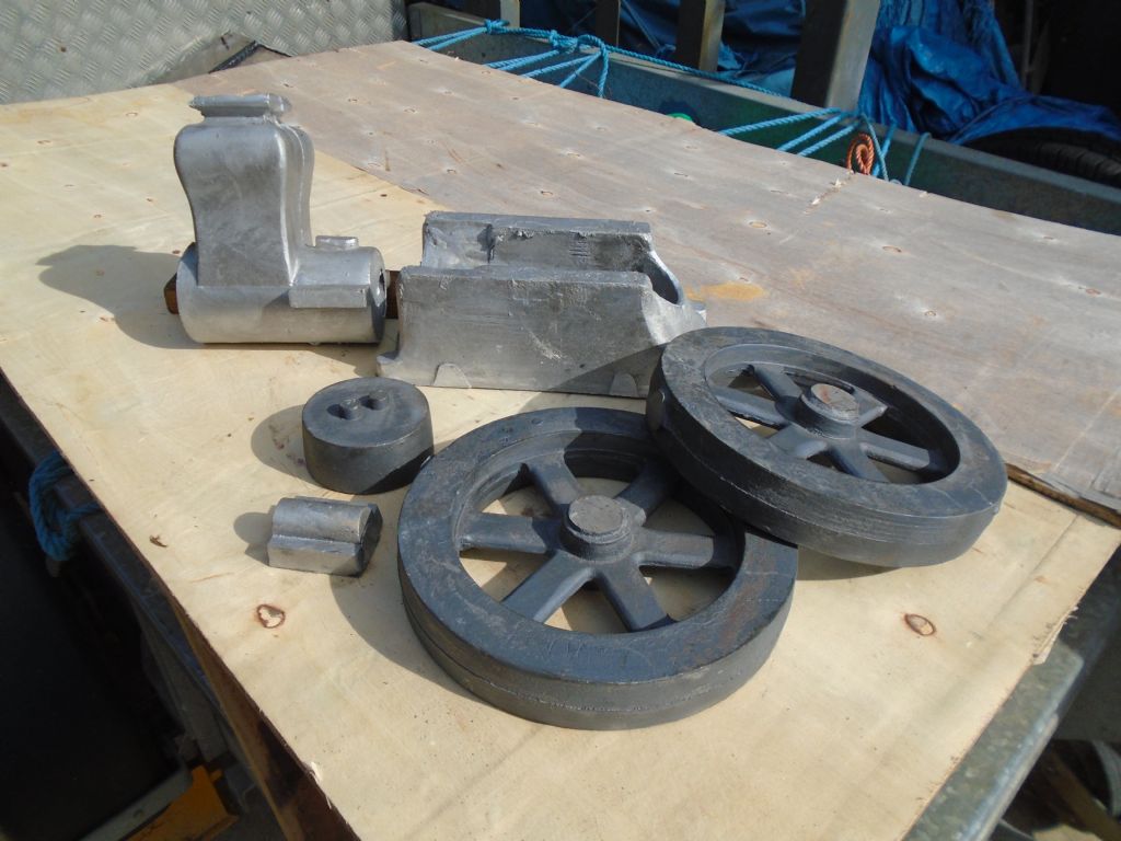

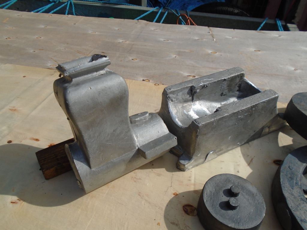

        I have just aquired a set of castings to build the "Bamford tulip top engine", almost identical to the engine that Ronnie Bickerton built a few years ago,
        Is Ronnie still about ?
        Unfortunately I have no drawings , so any dimentions would be very helpful, like bore and stroke, cam gear dimentions etc, all I know is the flywheels are 8" diameter,
        Any help would be well received,
        Thanks,
        Richard.

            Jo on Modelenginemaker forum bought a set from Adrain at Engineer's Emporium a couple of years back who had bought a few sets said to be cast from Ronnie's patterns and I think he also got the patterns. She said she would do him a set of drawings, though nothing has materialised and she was just going to base them on an RLE .
            It's not that good a representation of the Bamford, better described as "inspired by" rather than a scale model. There was a two page article in Stationary Engine mag which is also reproduced in their book on models but no sizes given
