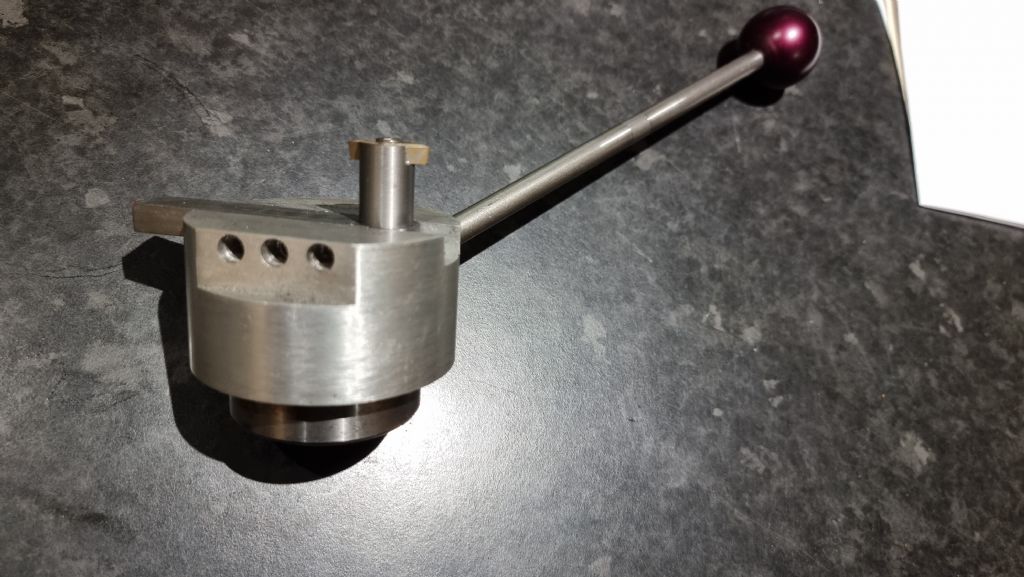

  • #655451
    Tony Hoggo
      @tonyhoggo42183
      I made these ball turners a few years ago, just a project, had no real use for them, but they have come in handy a few times. I wanted one I could mount in the tool post and be used either in front of or behind the chuck. The first welded up one was a trial to see how well it worked, it worked extremely well, so, I made a few design changes and machined up the final. These were made on the lathe as I didn't have a mill at the time.15625981_220352588415814_3621266173501245755_o.jpg15591255_220352618415811_2523932182159452129_o.jpg31369694_2040980742828628_8702552182144106496_n.jpg15665747_220804405037299_2357798175826586051_n.jpg15675618_220352638415809_2969969817501947607_o.jpg
      #21046

          @bernardtowers37738
          If simple balls are to be turned they are ok but if accurate balls Arte needed say for trackrod ends etc a tool slide needs to be addedimg_4171.jpeg
          #655560

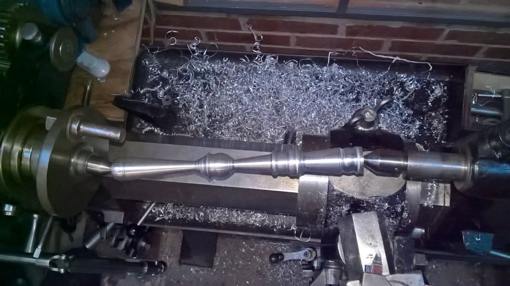

          vic newey
            @vicnewey60017
            My 1895 vintage lathe has a powered ball turner, it can be set to turn ovals, spheres and even a ball in the middle of a length of metal bar. Here is a 90 second video powered ball turner
            #655561

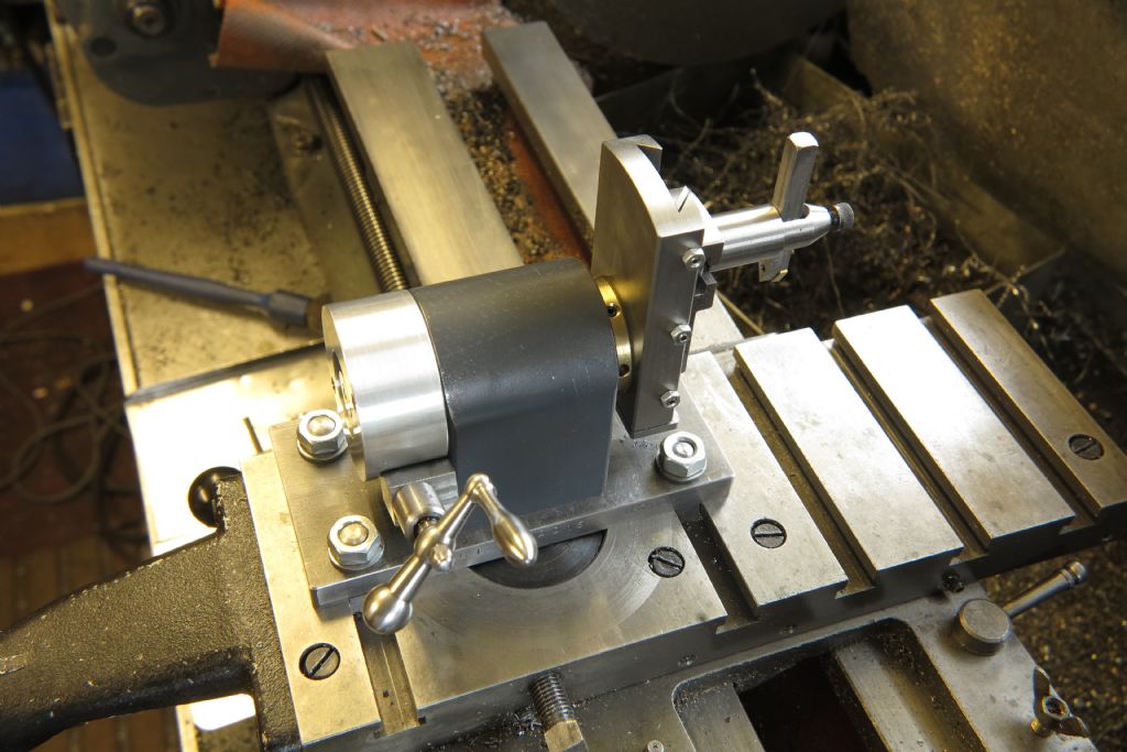

                #655564
                Steviegtr
                  @steviegtr
                  I made this one a few years ago. Specifically for the Myford super 7 . It fits in place of the compound & then locks with the wedges. I also made it so the cutting tip can be rotated. I noticed a lot I had seen would not get right into the root where the mandrel holds it in the chuck.
                  Steve.

                    @tonyhoggo42183
                    Posted by bernard towers on 07/08/2023 20:25:54:
                    Bully for you. Mine does what I want it to, that's all that matters to me..

                          Robin
                            @robin
                            Posted by vic newey on 07/08/2023 20:46:25:
                            Exquisite smiley
                            There is a Holtzapffel lathe, with lots of the kit, up on that auction site. Made for a Victorian gentleman hobbyist wood turner, but who would want it now you can't get the ivory?
                            Robin

                                  #655619
                                  vic newey
                                    @vicnewey60017
                                    Posted by Steviegtr on 08/08/2023 12:04:04:
                                    Just had a watch of some of your video's. A great old lathe you have there. Plus a ingenious ball turner.
                                    Steve.
                                    It is an interesting machine for sure, the ball turning can be set fast or slow via settings of worms and wheels etc. and a superfine mirror finish is possible.
                                    I have experimented turning a ball in the middle of a length of metal with an extreme taper either side for which the headstock was swivelled over 7 degrees for this, it can actually swivel 20 degrees. I must experiment more
                                    Edited By vic newey on 08/08/2023 12:29:33
