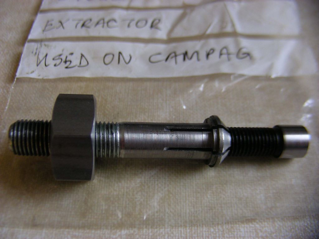

                                  Posted by Nigel Bennett on 10/05/2022 12:33:02:
                                  Getting the old ones out of a hub wasn't easy and for Shimano ones later it was virtually impossible – by design, presumably.
                                  This prompted me to dig out the extractor I made up years ago:
                                  The slit cone is inserted into the cup and expanded behind it by the cap screw which is tightened from the other side (the cap screw head has been turned down to fit the hole through the spindle). The cup is then extracted by tightening the nut – a suitable washer is interposed.
                                  I remember being told then by my LBS (local bike shop) that replacement cups would no longer be available.
