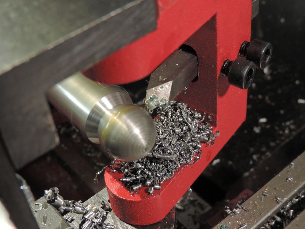

What are these Ball and Radius Turning Tools like to use in real life?
Require careful setting up or you get quite a big neck. Work fine if you are careful.
Thanks Neil, what brand did you purchase?
I made my own much more substantial and ridged. It is loosely based on a design by the late Steve Bedair. Google will find it.
You can also use a boring head mounted in the toolpost to make a radius tool , the fine adjustment makes setting up a bit easier .
