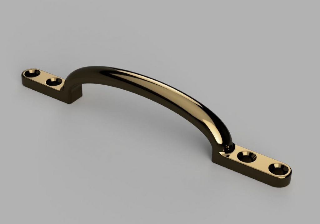

      Got a bit further with the Baldwin, namely cab windows and window handle model rendering below, the castings now exist for the conduit fittings and I'm getting on with the bodywork. The panel under the tank is now fitted.2021-02-09-10-00-52am handle v3 render.jpg

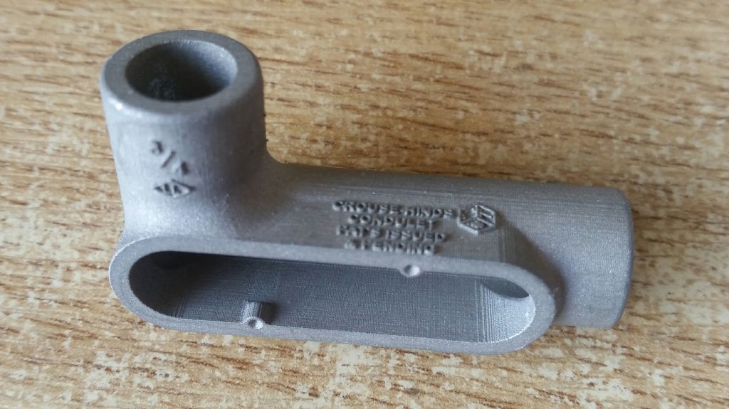

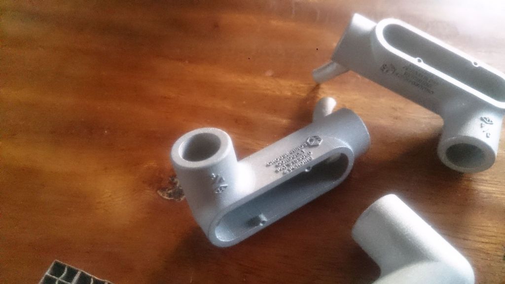

          Conduit castings  They are designed to take 8mm heating pipes for the conduit.

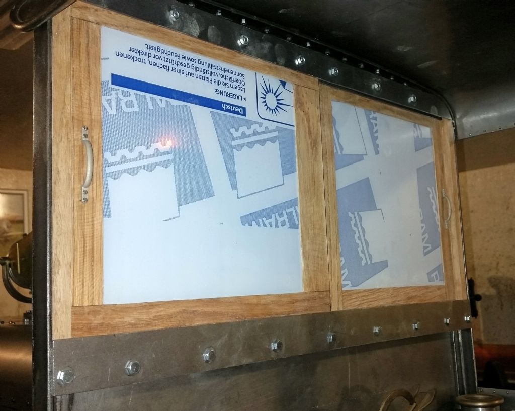

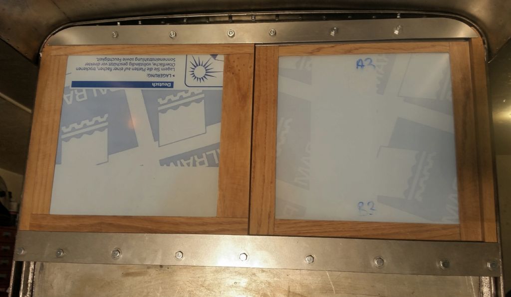

            Oak cab window frames

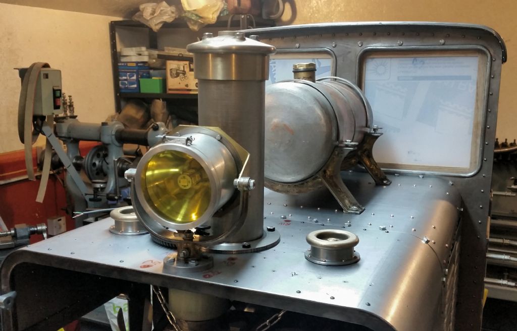

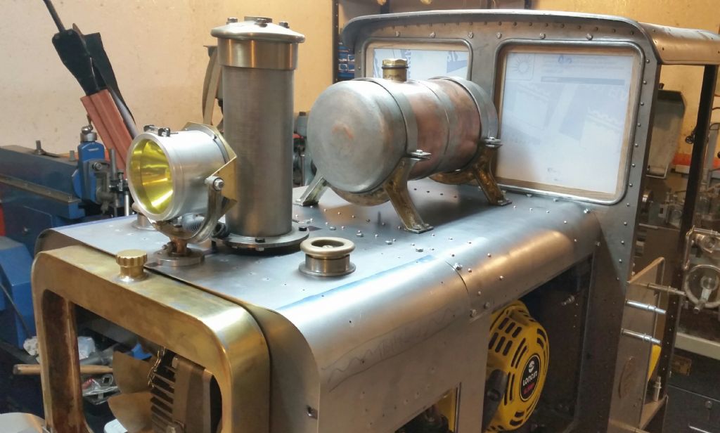

                    Have got a bit further over the last four weeks. The conduit castings and handles arrived today, the latter have been fitted this afternoon. A revised under chimney panel is fitted with a load of M2 button heads, along with the chimney, lamp and front sand fillers.  I was impressed with a roll forming tap used to tap the body frames under power.  Never used one before, but they're brilliant.

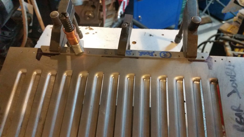

                      Drilling the doors for the various strips which need riveting on.

                          Cab window handles seen previously as a render now exist in white bronze.
                          #535875
                          Steve Addy
                            @steveaddy35670
                            Window handles fitted.

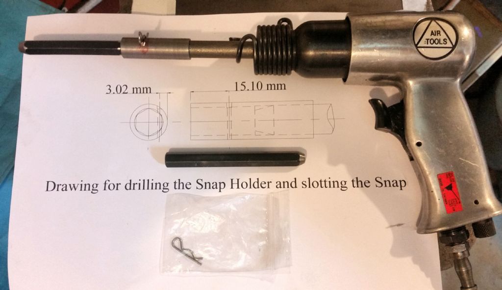

                                  I've modified an air chisel hammer this last week to drive rivets. Seems to work with snap heads with a 1.7 times diameter stick through. The drawing seemed to be overkill, but at least I got the hole and slot in the right place for it to fit together nicely.
