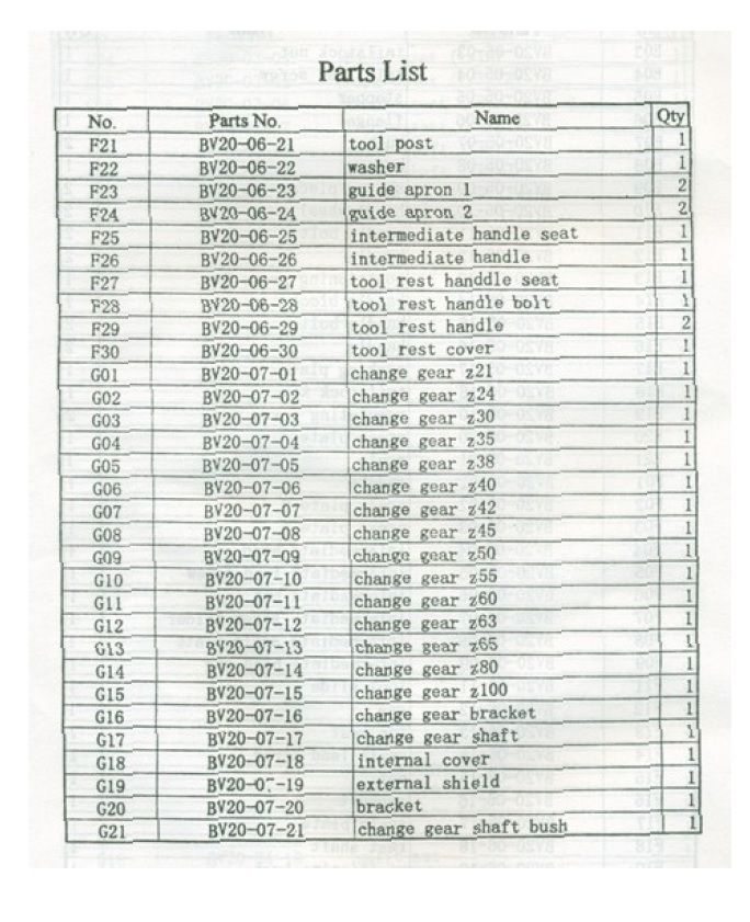

                                I've already given Dick a possible source for a complete set of gears, above. I still have digital copies of the lathe manual supplied with my lathe and another for an identical lathe from a manual site on the web.
                                The gears are listed in the chart below and are described elsewhere in the manual as being MOD 1.5. Pressure angle of choice, if you are going to the trouble of making them, likewise the width. Just have to match the one on the gearbox output shaft.
                                Vic – one manual I have suggests it's possible to introduce an 18 tooth gear in the train as a tumbler reversing gear so that the leadscrew turns "the other way", Then you can turn right hand threads away from a face at any speed you like.
                                Dick, you ask about the ELS. I did a series of videos on YouTube about fitting one to my lathe. Introductory video here. It's not difficult but neither is it cheap! Probably more expensive than buying/making the gears and banjo, but far, far more convenient.
                                Here's the relevant page for the gear tooth counts:
                                change gear list

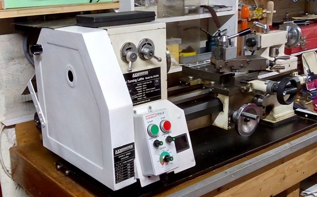

                                  Posted by Dick Briggs on 13/07/2023 12:46:00:
                                  ……..Also, I wanted to ask for recommendations on fitting an electronic speed control? I believe these lathes use an induction motor so require an inverter to control speed, is there a budget option for this? It should in theory be OK as it has a reduction box, so torque shouldn't be an issue, the Drummond was just used for basic turning and had a washing machine motor so fitting a speed control was easy and cheap.
                                  You'll need to change the motor to a 3-phase one matched to an inverter. People like Newton Tesla do suitable packages (like the one I fitted to my BV20) although some mechanical modification was needed to the motor mounting. It works really well. Don't know how 'economical' it is these days though.
                                  I've done plenty of screw cutting on mine, with fair results overall. There's no auto knock off on the feed or screw cutting indicator, so you just leave the lead screw permanently engaged, stop and reverse on each pass (having taken the cut off of course), You just get used to it.
