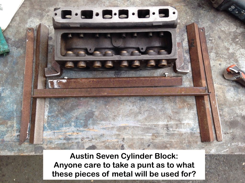

                            I am thinking it might be a stand for working on the engine.
                            Phil
                            #287962
                            Richard S2
                              @richards2
                              I'm thinking the framework is to assist in positioning/installing the Head when the Engine block is in the car?.

                                Richard, the head is so light that it just slides down on the studs. I used to lift out the engine and gearbox in one piece without a hoist – not sure I could do that now though.
                                Geoff what have you done to the 3rd manifold stud from the front ???

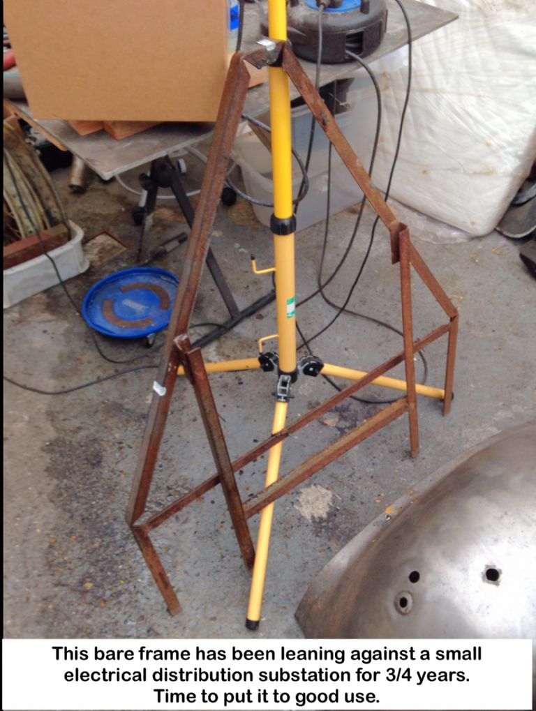

                                  It's a replacement chassis out of heavier gauge angle than the original A7 one

                                        Keep the guesses flowing smiley
                                        One is hinting on its usage.
                                        BobH,
                                        As received.
                                        Obviously threads in the block stripped, so re-tapped and a stepped stud fitted, all standard procedure with parts available off-the-shelf from suppliers.
                                        About to be sidetracked by investigating induction heater for persuading rusted/stuck fasteners to bahave.
                                        Geoff – Finish editing the video first though.

                                                The original ones were made from high tensile steel an so far non has made a decent copy.
                                                Posted by Neil Wyatt on 09/03/2017 15:35:17:
