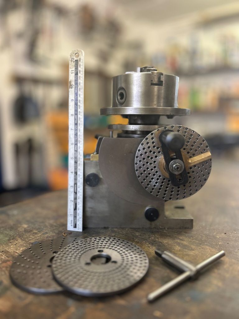

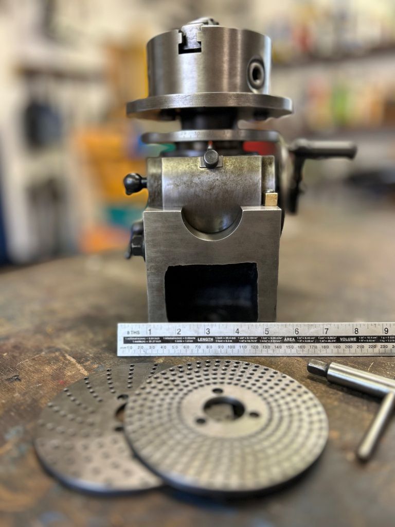

      img-9306.jpgI posted yesterday about a dividing head I wanted to get back in working order. It needed a part mending and a couple of other bits locating or making. This is now done and it is ready to use.
      It was suggested in the replies that for tables, I would need to know the maker because table are specific to the unit.
      I had assumed that tables for a DH with 40:1 reduction ratio would work for all dividing heads using the same ratio.
      As I have never used one, could someone point me in the right direction for tables please?
      img-9305.jpgMany thanks.

          I find it simpler to do the calculations as you may not have the plate with the number of holes specified in the table.
          For a 40:1 dividing head, divide 40 by the number of intervals/teeth etc you wish to machine. Reduce to an integer plus a fraction. The integer part is whole turns, the fractional part leads you to the number of holes to advance in addition.
          So, for example, to do 24 teeth on a gear, 40/24 = 1 + 16/24 = 1 2/3. The plate hole circle needs to be a multiple of 3, for example, 39 is a commonly available circle, so 1 turn plus 2/3 x 39 = 1 turn and 26 holes.
          You'll never need a table again.

            You’re right, Jim … they do; provided that the set of plates has all the right numbers too.

              What you have is commonly known nowadays as the "BS0" as it is (probably) a copy of the Brown & Sharpe one.
              There are copies of the B&S tables on the 'net and plenty of others too. For many divisions there is more than one way so tables may not agree exactly but it is also good to know how to calculate yourself. (there is one mistake in the original B&S tables but I can't remember what it is as it is a count nobody much uses)

                Try THIS calculator. put in 40 for the worm and all the plate holes you have, comma seperated. click update and you will have a table of all the possible divisions and all the impossible ones as well!!

                        Yes, might well be a BS0. If the ration is 40:1, copy the table and change all the 90s mto 40s.
                        Note the number of holes on each of the plates that you have, and, with a bit of luck, they will appaear on the spreadsheet.
                        From this you can construct your own chart, showing the divisions available to you.
                        IF it is BS0,and has a 40:1 ratio, maybe some kind person has one and will send you a copy of their chart.

                            A 40:1 table will work for all basic 40:1 dividing heads in terms of the mathematics. What matters is whether you have the appropriate hole count in your plate selection. Even if you don't you can easily make one by printing a paper template of your hole pattern onto a disc, centre-punching the pooints and drilling them free-hand. Any error will be divided by 40.
