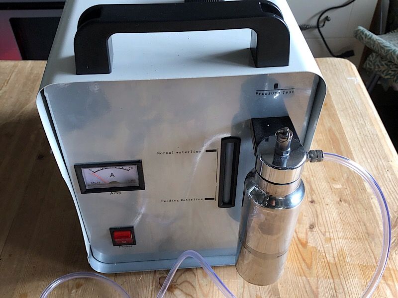

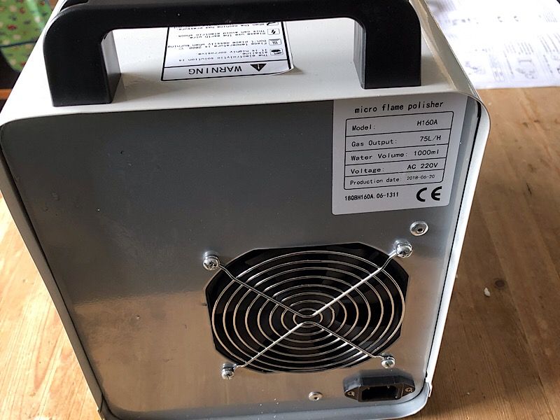

        Has anyone got one of these hydrogen generators i bought it for acrylic edge smoothing but seems it can be used for small repairs on jewellery etc
        it came with some naoh 500grms.the instructions say make up a 15% solution..so that’s 150gr of naoh to 1 litre of water?
        anyhow does anyone use one and have any operating tips?

                I have an Aqua-Flame unit, which is very similar to a Microflame.
                John is correct in stating that the flame is virtually invisible. Fortuitously, the ratio of oxygen and hydrogen produced is just right for burning, and doesn't have to be changed, but, although the flame is very hot – approaching that of oxy-acetylene – it is relatively low in energy. To counteract this, it has something called a booster tank.
                Output from the generator is fed through the booster and then to the torch. A liquid is placed in the booster to achieve two things, a) to counter the effects of a blowback, and b) to change the flame temperature. If the booster contains water, then pure oxy-hydrogen is burnt, but if it contains a suitable chemical, the flame temperature and calorific value, is changed. I use methylethylketone (which, I believe, is used in dry-cleaning) to reduce the temperate to about 2000C and increase its calorific value.
                Flame size is determined by the size of the torch tip, which is rather like a hypodermic needle, and not by a regulator valve. The flame produced ranges from about 3-4mm wide and 80mm long for the biggest tip I have, to about 0.5mm wide and 2mm long for the smallest one. I am able to hard-solder the tiniest chains with the small tip.

                  Well i filled it with my mix of 150g naoh and 1 litre of water and filled the booster with methanol as directions and it certainly works well.
                  as said teh flame is very hot and virtually invisible though it polished some 15mm Perspex edges very well..
                  How long should i leave the electrolyte in? And if it should be removed can i save it and reuse?
                  It was only £110 delivered from Belgium by ups

                    I would expect it will not change – need CO2 to change it to washing soda. You will get 44 litres of hydrogen from each 18ml of water in the electrolyte and only need to replenish the electrolysed water as the level drops.
                    You could work out the hydrogen generation rate from the number of coulombs passed, but measuring the water level might tll you the same thing.
                    Looks like a useful piece of kit for the right jobs.

                            it certainly looks well made
                            its like a small welder 30cm x 20 x 20cm and weighs 5 kg empty
                            i’ve only done edge polishing but the flame looks good enough for precision heating of small parts/jewellery etc
                            it runs for about 20 seconds and then switches off on a pressure switch then cycles on/off as you use the produced gas
