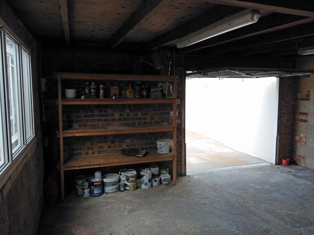

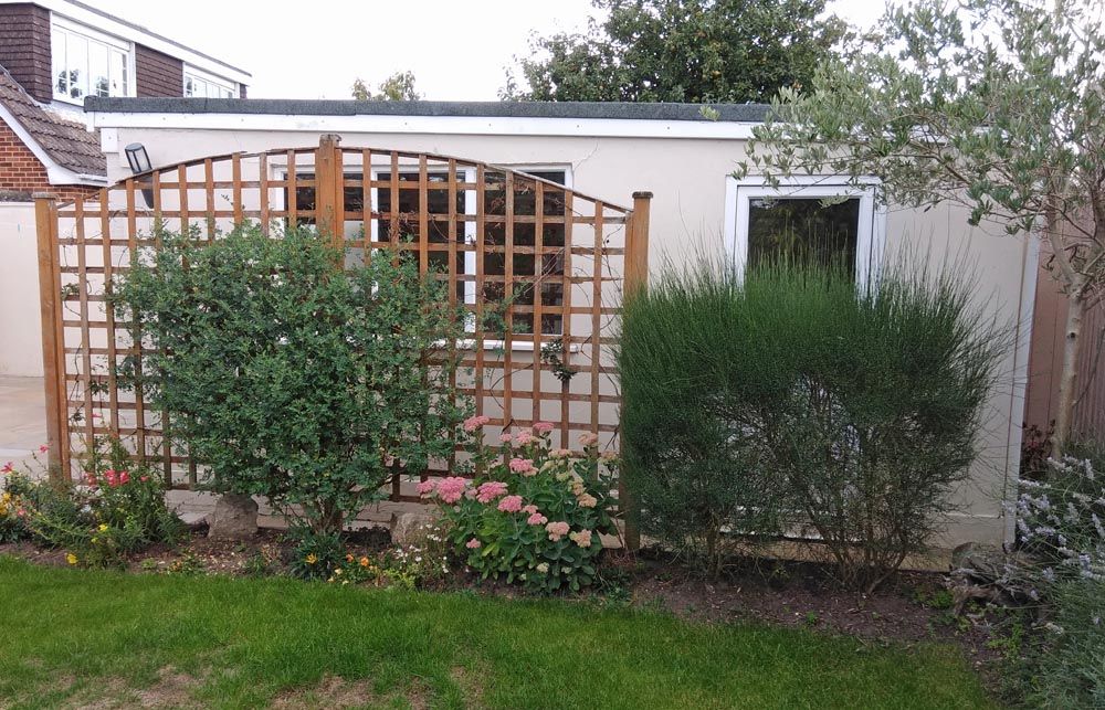

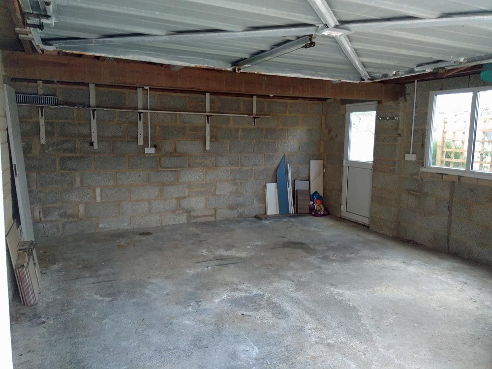

      We have just moved to sunny Christchurch in Dorset. The new workshop is considerably bigger than my last home, being 5m x 5m.
      The plan is to replace the up and over door with a 2/3 1/3 side hinged door.. The walls are single skin, mostly concrete block but with a brick front, semi detached on one side – all painted now. Reading the various threads on the forum have led me to plan to batten the walls and infill with 25 mm polystyrene, then use a polythene vapour barrier and line out with OSB painted white. I'm less clear on what to do with the ceiling. I'm currently inclined to go with Celotex (or similar) fastened to the rafters (thus making use of the reflective surface to enhance lighting). I understand that It would be a good idea to ventilate the area between the Celotex and the roof boards – how would I go about this? Any other comments on the scheme would be most welcome.
      Cheers,
      Rod
      #26191
      Roderick Jenkins
        @roderickjenkins93242
        Advice and comments please

          1 inch of insulation isn't nearly enough. Minimum of 4 and I'd prefer 6in. Then you can happily heat 24/7. The underside of the roof shouldn't need ventilation provided your vapour barrier works. I suggest having a close look at he floor to make sure it is on a dpc and think about boarding it out for a bit of insulation.
          #372241

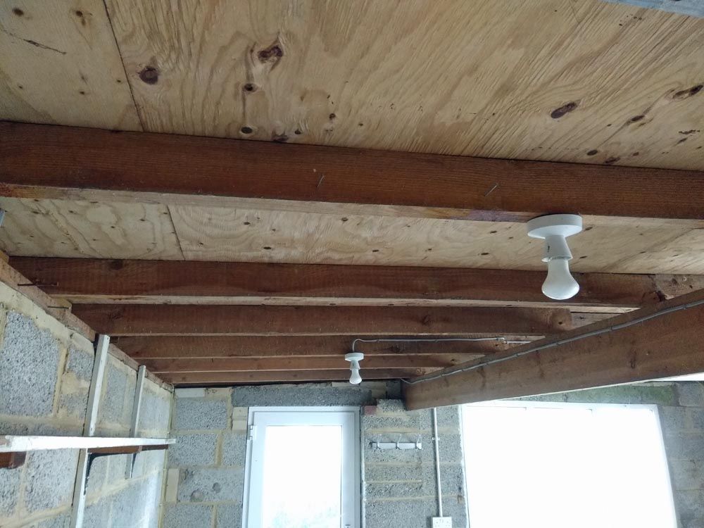

            For the walls I would try and go for 50mm Celotex/Kingspan rather than 25mm, not much more costwise and will take the same effort to fit but will keep you a lot warmer. If you can get the formwork OSB with one smooth surface that paints up better and does not collect the dust.
            For the ceiling I would go 50mm Celotex/kingspan between rafters which will leave you a 50mm airgap above. Then 25mm Celotex under the rafters so the whole area is covered, Ali tape on the joints and that with the foil face will give you your vapour barrier. I'd probably ply over that too which I what I have on mine.

                I agree with Jason about using ply rather than OSB, much better finish and much easier to drive screws into when fitting shelves.

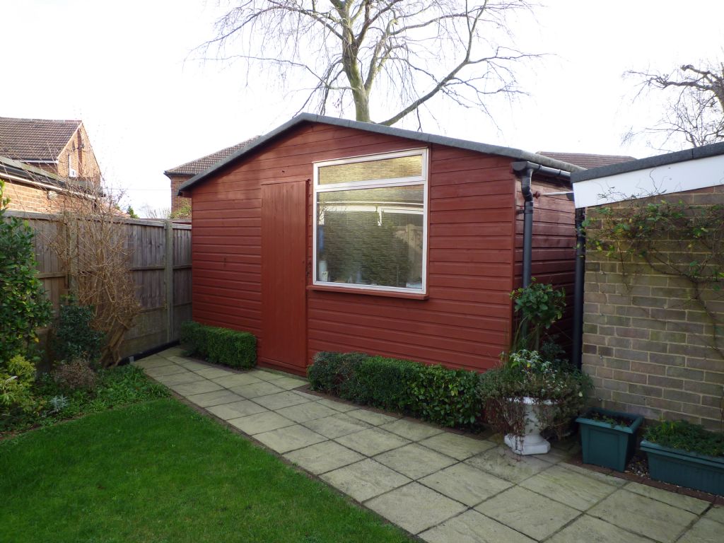

                              Can't do the maths for you Ian, but can say from experience that insulation works! This is my workshop:-
                              I built it from scratch over 35years ago, it is still standing and the routine maintenance includes re-roofing 3 times and regular coats of timber treatment on the outside. It is plain timber with no vapour barrier or other lining. The walls have 2" rockwool insulation and the roof has 4" rockwool, heating by a wall mounted 1kw thermostatically controlled fan heater. which doesn't run very often. The inner walls and roof are lined with printed hardboard sheets to hold the insulation in place (with hindsight thick ply would have been better) There are a couple of high level ventilation grilles that I open in the summer. The windows are a couple of second-hand double glazed units.
                              No rust, although I keep the machinery oiled, warm in winter and cool in summer (except this year when it got up to about 35C) More info *** HERE *** if interested.
                              Edit: Add photo
