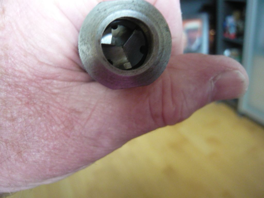

      I've had this for years, having rescued it from the firm I used to work for.
      It came with a second hand lathe and wasn't part of the tooling that the firm wanted.
      There are 3 cutters inside and it appears to be for machining the ends of bars using the adaptors (1 missing)
      If anyone has more information then I would be most grateful.

          Looks kind if like a tapping head. what does the little sign on the box say?

            Can't really tell. can you take a pic looking into the business end? is it perhaps a capstan fitting for reducing the end of a bar before the next tool threads it, bit like a small chip stream roller box?

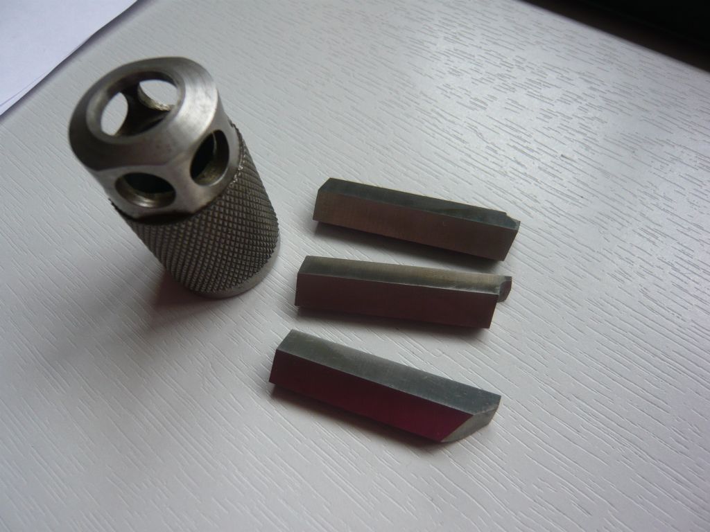

              Many thanks for the replies, I wonder if Phil has hit it on the head.
              Here are another couple of pictures.
              The discs with holes locate into a recess inside the part with the holes around.
              Brian

                Yes, I think that is what it is, although with different grinds on the tool, you could radius, chamfer, etc. It's unusual. No makers name?
