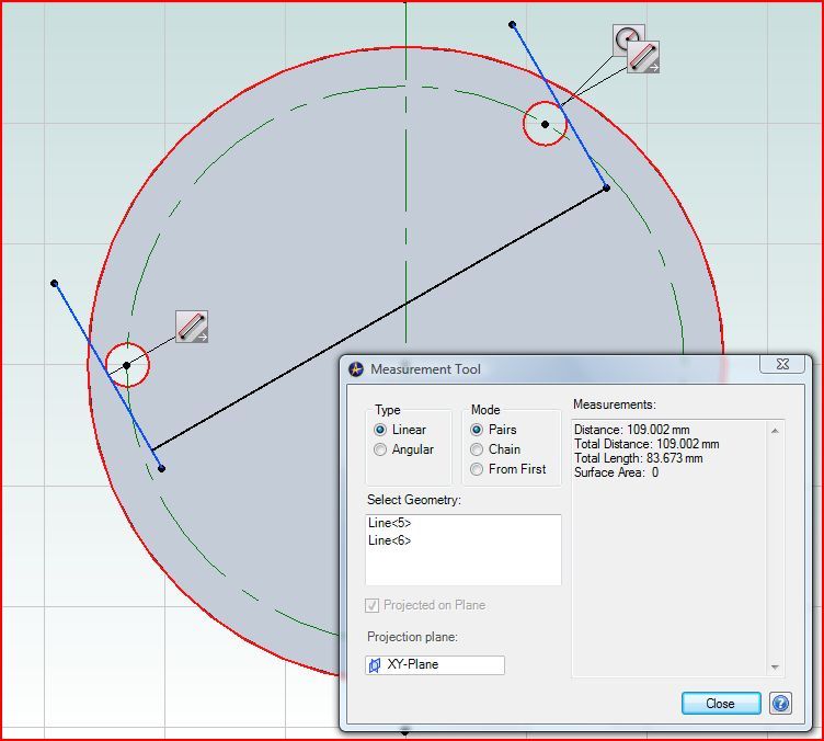

        i have measured mounting on my clarke cl430 lathe.
        diameter is 132mm,
        from outside edge to bolt hole edge is 3.76mm
        bolt hole is 8.95mm
        i have halved bolt hole size and added it to mounting edge to hole edge measurement and got 8.235.
        taking that away from mounting size gives me 123.75..
        am i right that is my pcd?
        thank you
        #160047
          I make it 115.53, you need to take the dimension away twice.
          J
          #160050
          mick70
            @mick70
            thank you once again for your kind help.
            #160051
              As a check put your digital callipers in teh holes and measure the distance between outer edges, should be about 109mm
              Or try one of the many online PCD calculators
              http://www.eicac.co.uk/PCD-Calculator.html
