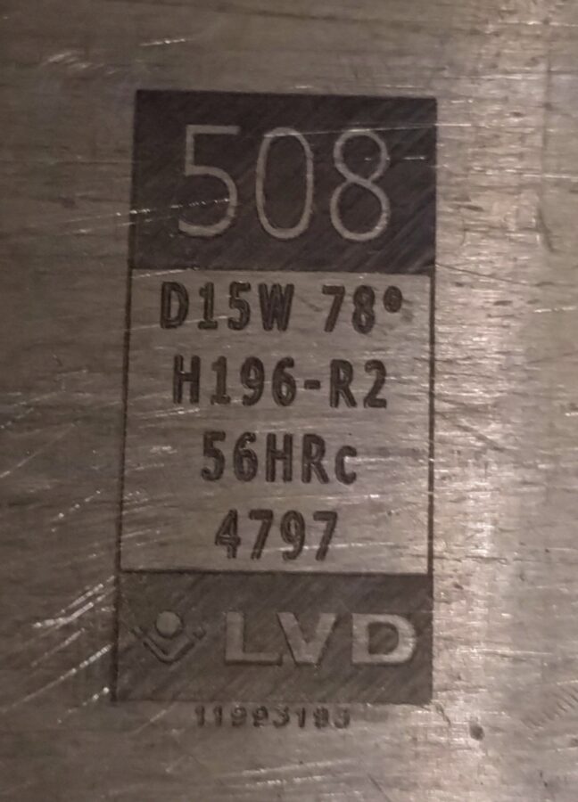

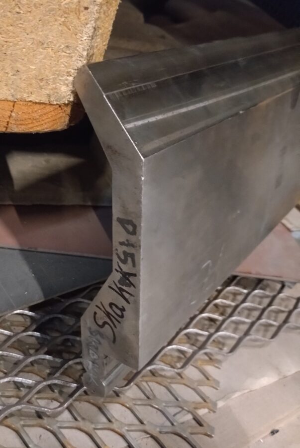

      So they threw out a bent die for the press brake and I couldn’t avoid noticing the marking:
      Anything you can harden to 56HRc should be useful material, right? But what could it be? O1?

            It looks like a guide rail, so probably at 56Hrc already.
            Ask Lefebvre, Van Neste and Dewulf what it’s made of.

              I know it’s impossible to identify the actual steel, but perhaps we could ballpark it? I agree you can get simple carbon steel up to 56HRc, but it would be pretty brittle at that point and not very suitable.
              When I get my furnace fixed I can test it more thoroughly but it’s nice to know roughly what I’m dealing with.

                Likely to be a high alloy steel. A common type for this application is chromium-molybdenum alloy e.g. 42CrMo4.
                Depends on what material the die was being used for. The hardness value on the die is likely to be what it is, not the maximum the steel can acheive.
                A scrapman with a spark spectrometer or it’s modern replacement the X-ray fluorescence “gun” will be able to tell you what it is.

                  You are missing a fundamental part of steel heat treatment, first the steel is heat treated to it’s maximum hardness, say 62/65RC and then tempered back to the desired hardness, in this case 56RC. This figure is not particularly brittle.

                    At that hardness I’d guess steel is more like D2 or some version of CR12.
                    D2 is tricky to anneal if you wanted to machine it. It should forge OK but stiff under hammer. Good for tooling and even knife blades.
                    (I refer to the android app: Knife Steel Chart from zknives.com)

                      Something like D2 or CR12 sounds like good candidates. I guess it’s worth hanging on to even if it’s a bit large and unwieldy.
