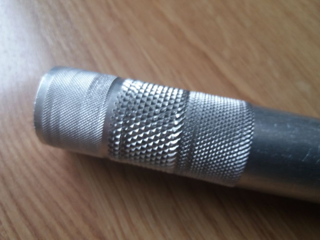

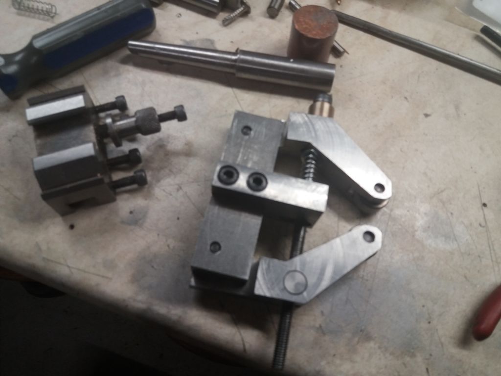

      I needed a knurling tool to knurl a 2 inch diamiter knob a few weeks ago and my M Type Drummond lathe isn't strong enough to use a push type tool and ended up getting if done on a friend's lathe. I had a think and thought I can make one to use on my lathe and here is my efforts.
      I had bought a push knurling tool at the Doncaster show and robbed it as it had three pairs of wheels in and only cost £10.00. The screw was a 130 mm long capscrew and a spring to support the top arm in a rough set place. There is a bronze washer to help the spring slide and a bent 6mm washer at tbe top of the spring to help it slide over the bolt slot. It works very well.
      David

        Andy Carruthers
          @andycarruthers33275
          Thanks for showcasing your knurling tool David, your design may very well solve an issue as I am considering making a new knurling tool myself
          #422072
          larry phelan 1
            @larryphelan1
            I made a knurling tool some time ago, not nearly as good as yours, but same type, mainly because I did not like the push type. I think they are too hard on the lathe, much better to operate under and over.
            Looking at your model, I am tempted to make something like that to replace my rough and ready unit.
            Very nice job !

              I have finnished it and oil blacked it and here is a picture now.
              David
              #422179
              Plasma
                @plasma
                Nice job, very similar to the one I use and so much easier to control depth of knurl etc.
                Plasma
