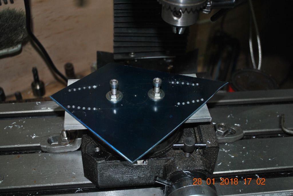

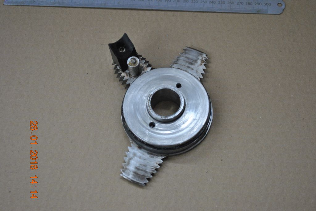

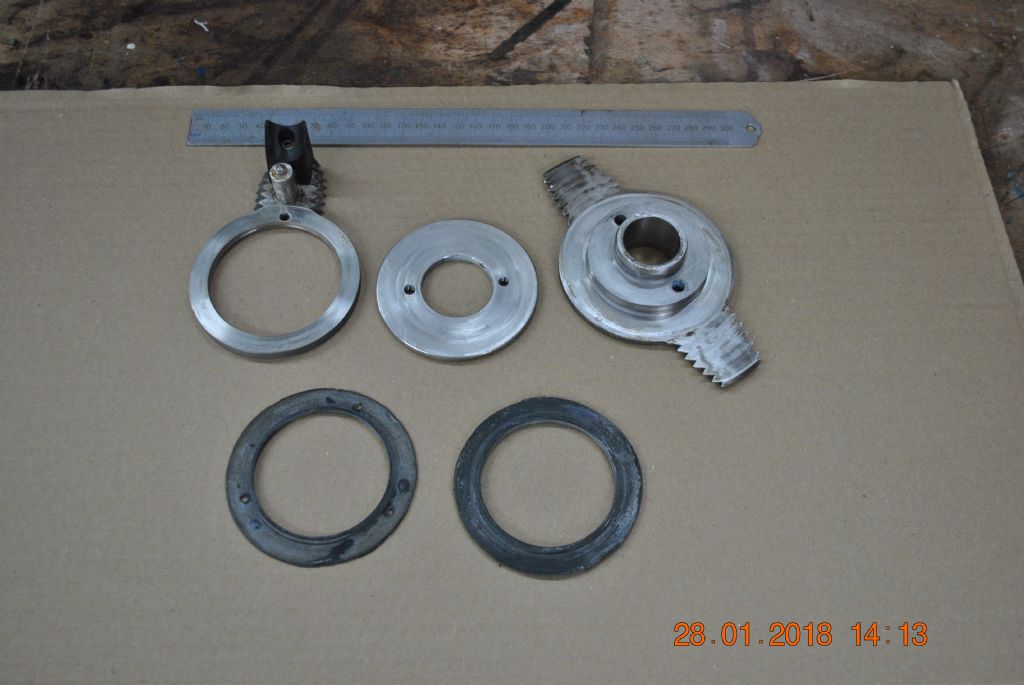

      However, I now have decided I really do need a new rope cutter. See 2 pictures I have researched the steel & had a Rockwell test done & it seems they are just made mostly from 6mm * 100 gauge plate. Not even hardened.

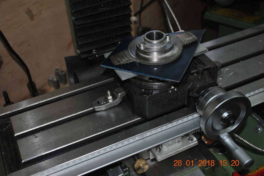

      I have set up my rotary table with a piece of aluminium as a protector – see picture& have clamped the first cutter to a piece of 3mm steel to make a pattern & as a test. I intend to drill 3mm holes in the roots of all the teeth & log the position on my DRO. Then I will machine the outer circle & then the splay of the cutter edge along the outer edge of the 3mm holes.
      After that it is a problem.
      I hope to tip the table on edge, like cutting gears, & using a double angled slitting saw I should be able to cut the teeth, just following the holes. The teeth already having been eased by the 3mm holes. They do not have to match exactly – just cut rope etc.
      Then mount it on a face plate on the lathe & cut the inner circle which is the important part of the cutter as it runs on the bush or the shaft. The thick central part is a simple turning task.
      Is that the way to do it or is there a better way & should I be looking for anything special with the gauge plate to enable easy machining

      The cutter in pieces
      parts
      The cutter assembledassembled cutter

            Your proposed method of manufacture sounds fine if you don't run the cutter right through so you end up with a bevel edge.
            However….. Are you really sure about your material? Gauge plate will have no resistance to corrosion in either fresh or salt water. Many years ago I was involved with development trials of 'Spurs' rope cutters for the RNLI and the metal parts of those were a cast stainless of a grade similar to 316. The original bearings were a fairly soft plastic consisting of 2 washers and a thin strip, the washers were put either side and the strip around the inner diameter, lifespan was a couple of months! They were soon changed to a moulded section in two pieces if I remember correctly of some Kevlar incorporated material which got us 12m. I can see your thinking re using a high carbon steel for hardness but I will be very surprised if the thin section of the sharp edge has not disappeared in a couple of weeks through corrosion. By the time you have made the blades and had them heat treated I imagine you will be looking at £100 they will definately need renewing or at the least resharpening in 12m time ad finitum, that doesn't make £475 sound too bad! As you mention a sail drive and that is probably not going to be in regular use you also run the risk of corrosion scale on the faces of the blades that need to pass each other jamming the shaft!
            With your machinery what is stopping you machining back the faces of the existing blades a little (ok that will thin them and reduce strength but you probably won't need to take much off to true them up, the edge can be put back on with a die grinder) then making new 'bushes' accordingly to position the blades? At least they are a reasonable grade of stainless and are not rusting away!
            Paul.

                            I don't see that the teeth need to be precision. Holding an angle grinder in a jig with a table and guard would allow you to cut and sharpen teeth.

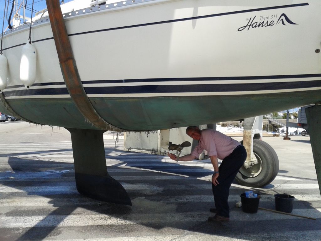

                                  Posted by Journeyman on 29/01/2018 17:36:25:
                                  Not being a sailor I had no idea what this was so I had a quick Google and all is now clear! Apparently your original had unhardened 316 stainless blades *** LINK *** Now I am off to find out what a "saildrive" is
                                  By fluke I have a picture of myself pointing at the plug in the bottom of the saildrive i had to have the boat lifted in Cherbourg because I had water in the oil. It turned out that I had used a copper washer on the plug & should have used a simple O ring.
                                  If you enlarge the picture you will see the Brunton self pitching propeller ( note the blades have flopped down)& just in front of it you might be able to make out the Ambasador rope cutter
                                  saildrive
                                  The cutter is very effective. On my 2 solo round UK trips I hit nearly a dozen badly marked crab pots, 3 off Blakeney in one night. It cut them with ease. I have caught nets & that has been cut OK . Polythene is a problem & i did collect a very large sheet that stopped the engine completely between boulogne & dieppe. It did manage to cut some of it & i got prop turning to get 1.5 Kts but needed a diver to remove it. The cutter did chop a lot of it. It is also effective for cutting the long strands of sea plants that fishing vessels dislodge . One gets a lot of that around the Channel islands

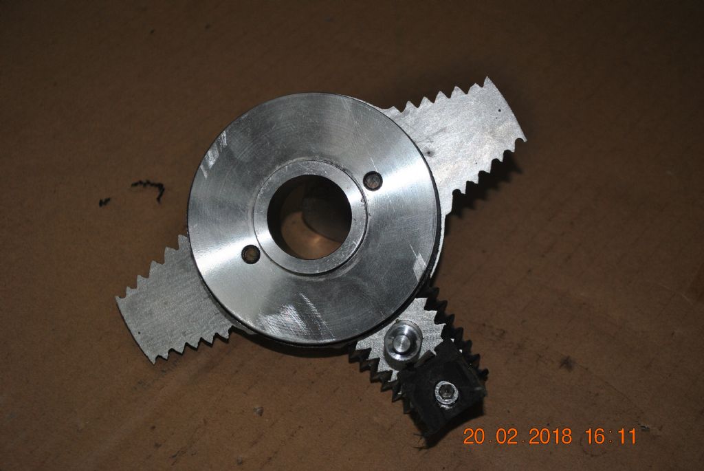

                                        So to do that, here is a picture of the finished article.
                                        A brand new professional made one is now £ 590-00 inc VAT. This cost me £ 44-00 for material, £ 18-00 for a milling cutter ( still Ok) a broken 3mm drill bit & some wear on a couple of cutters plus about £ 4-00 worth of tufnol & a £ 1-00 of bolts
                                        I did find it odd that HSS cutters were the best for machining the stainless steel. Especially the boring bars which I ground from blanks. That was quite an enjoyable achievement.
                                        I learned a lot & if I made another (or a couple for friends) I would have them laser cut & save a lot of time.I have been offered the use of a 6 inch rotary table & a good solid one would have helped a lot
                                        So here is a picture to prove that I did it !!!!!!!
