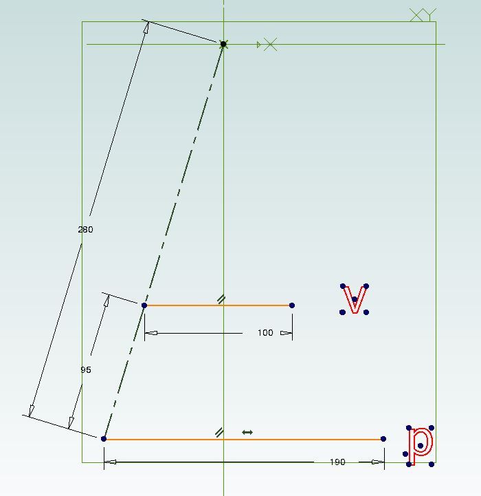

      Hello. Just joined and looking for some comments on a valve actuating mechanism idea. I want to make an O gauge live steam loco that does not have to resemble any actual loco but can pull a train. I want the piston valve directly over the top of the drive cylinder. But that requires an elaborate linkage system. The idea is to have a pendulum lever which drives the valve shaft from the drive shaft. I graphed it out and with a drive pistion stroke of 190mm and a piston stroke of 100mm and an axis difference of 95mm there is a pendulum length of some 280mm . The pendulum arm would have pin holes elonged 12mm to allow it to rock. Maybe this has been tried before but i cannot find any examples. So please advise. I could send CAD if that would explain it better. cheers Jack
      #33778
      John Bramwell
        @johnbramwell55907
        Comments sought on simple valve mechanism idea.
        #525890
          John, a picture may help, have a read of this to see how to add one to a post, just a screen shot of the basic concept should do.
          I think I get the idea of what you are suggesting but at the moment the valve and piston will move in unison but you want the valve to lead the crank by approx 120deg to get the timing right.
          Also are those sizes right, they sound big for Gauge O
          Edited By JasonB on 09/02/2021 13:07:00

              This is the picture that came to my mind from the description. Green pendulum pivoted at the top has it's other end moved 190mm by piston rod. The valve rod being nearer the pivot will not move as far.

                A 100 mm piston stroke on an O gauge loco?
                If O gauge is 45 mm , full scale the loco would have a stroke of TEN FEET! (Larger than the driving wheels, unless possibly a Crampton. )
                As Jason says, your figures are much too big for an O gauge loco.
                Perhaps you need to revise them?
                Howard
                #525917
                  Figures are probably what John has used to model the layout on paper.
                  There is also no real need for an elaborate linkage system to get the valve above the cylinder, just mount a traditional eccentric on outside of wheel and then have the crank pin go right through that. Then simply angle the piston valve hole so it aims at the ctr line of the axle then all you need is a simple clevis to join valve rod to eccentric rod.
                  If you were really clever then have a slot curved slot in the eccentric where the crank pin comes through and it could be made into a slip eccentric so engine will run either way
                  Edited By JasonB on 09/02/2021 14:39:54

                    Sorry guys the CAD dimensions are x10 what i want to build. But you advice is very helpful. In order of posts': yes I have the valve piston moving in sync with the power piston I have them both down the same end at the same time both fully open, But that means it would start to open a lot earlier wouldnt it?…I realise now that you can have two cranks off the same side of the flywheel by extending the pin of the bigger one then having an arm on it. The angle of this arm would determine the timing. I like the Caladonian, will work out how to limh to my screen shot but its a bit obsolite now. Thanks again. PS how does a10mm stroke sound for an O gauge?
                    #526061
                    John Bramwell
                      @johnbramwell55907
                      Jasons diagram has it exactly. Except for some f!exibility in the joints to allow for the arc (11 units at the p shaft). I was thinking slots or !inear beatings. You see how simlple it is for a novice, one piece. As for the timing, if the stroke is 99units and the port is 33 units and the piston just goes from one side of the port to over the port then to the other side of the port the opening stats at 1/3 of 180 =60 degrees. A wobbler engine has !ess i think.

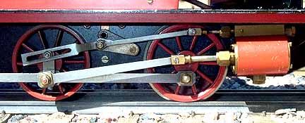

                            Or as an alternative what about the slip return crank as used by the Hackfly locomotive?
                              No reason why not, though perhaps a bit fiddly in 0 gauge and of course only suitable for outside cylinders. It depends how well it fits in with the overall design. It is sometimes overlooked that valve gear is three-dimensional, and has to fit in the space available.

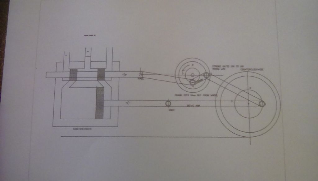

                                      Ok. Here is the basic design of the pendulum vale actuator. Some of you thought that there was no lead but as you can see it has a modified valve piston and cylinder which is full open at TDC. So cracks open at 90 deg BTDC. The valve chamber bolts onto the power chamber. The shafts are conneted to the pendulum by slots to allow for vertiacal displacement. Will it work? John

                                        John,
                                        I am not knocking what you are trying to do, but I don't think you quite understand how the valve works, and you need to go back to first principles.
                                        It isn't simple, and there is too much to go into here, but you have to consider both the opening and closing points, and what the exhaust is doing, as well as the steam.
                                        It is well established that for the basic form of valves without lap or lead, the valve and piston need to be 90 degrees out of phase.
                                        The linkage you have shown will match the stroke of the piston to the stroke of the valve, but they are in phase with each other.
                                        Edited By Redsetter on 16/02/2021 13:43:08

                                              It might be worth drawing your valve gear at different positions of the crank and comparing the valve openings to the Dockstader simulations. Several of them use an oscillating lever similar to yours, but derive their action from the vertical movement of the crank which is automatically 90 degrees out of phase with the piston.

                                                  Didnt have much luck with Dockstader but found J,Y Jins computor simulations (https://www.youtube.com/watch?v=ed3vMFQNzCc) Timing realtionship between valve sheet and main piston of a steam. And his cylinder is the same as mine so this supports Redsitters advice. Please have a look at this and tell me what you think. I still think my design will run because the steam will push the piston in the right directiion which is the absolute basics. And if i build it and it doesnt work then it is not too hard to change it to put a crank in the wheel axle at 90 deg to drive an adjustable eccentric.

                                                    Your diagram shows the piston in a position where the inlet is fully open when the con-rod is horizontal. Your wheel should be rotated already past the horizontal before the valve opens otherwise it would try to stop the rotation. That's is where the timing comes in.
