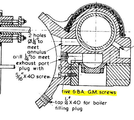

      I have reached the stage of machining the valve chest on my engine and I have some questions I hope you can help with
      On the drawings there are 5 holes drilled through the cylinder base into the bottom of the valve chest from underneath, what do these do

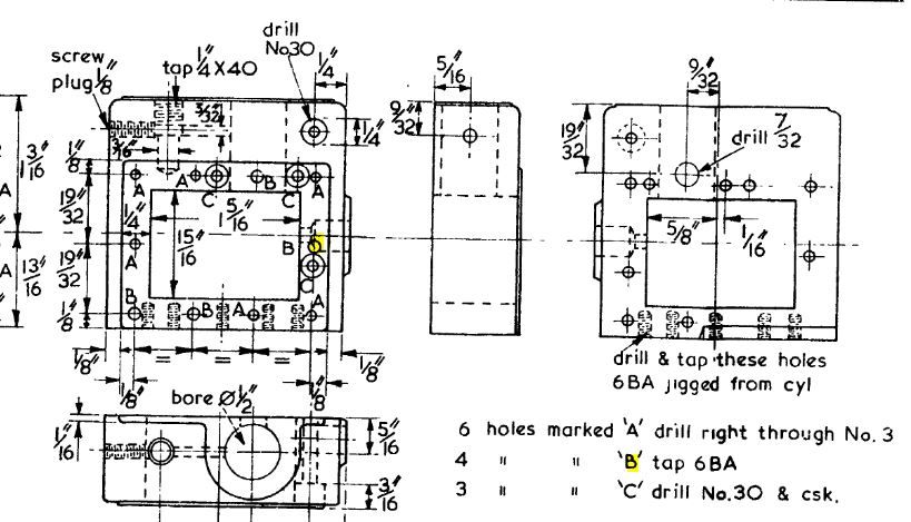

      Same for the 3 5ba csk holes and one of the holes appears to be drilled through the valve stem but there is a lack of hidden view of the end elevation on my drawings

          Not made it but the 5 holes are for screws to permanently hold the chest vertically down.
          The 3 CSK holes permanently hold the chest horizontally.
          Looks like it is a "B" hole which is a blind stud hole that is near the valve stem not the through "C" countersunk hole
          The chest would not have been a separate part on the original but doing it separately makes it easier for us to machine the ports and port face.

            I believe the original had cylinder and chest cast as a single unit. So these are 5x6ba gunmetal r head fixings to hold the chest down.
            there is a clear section in the centre of sheet 6
            the view  of the chest bottom left on the sheet shows they clear the spindle. 6 holes”a” to fix to cylinder etc
