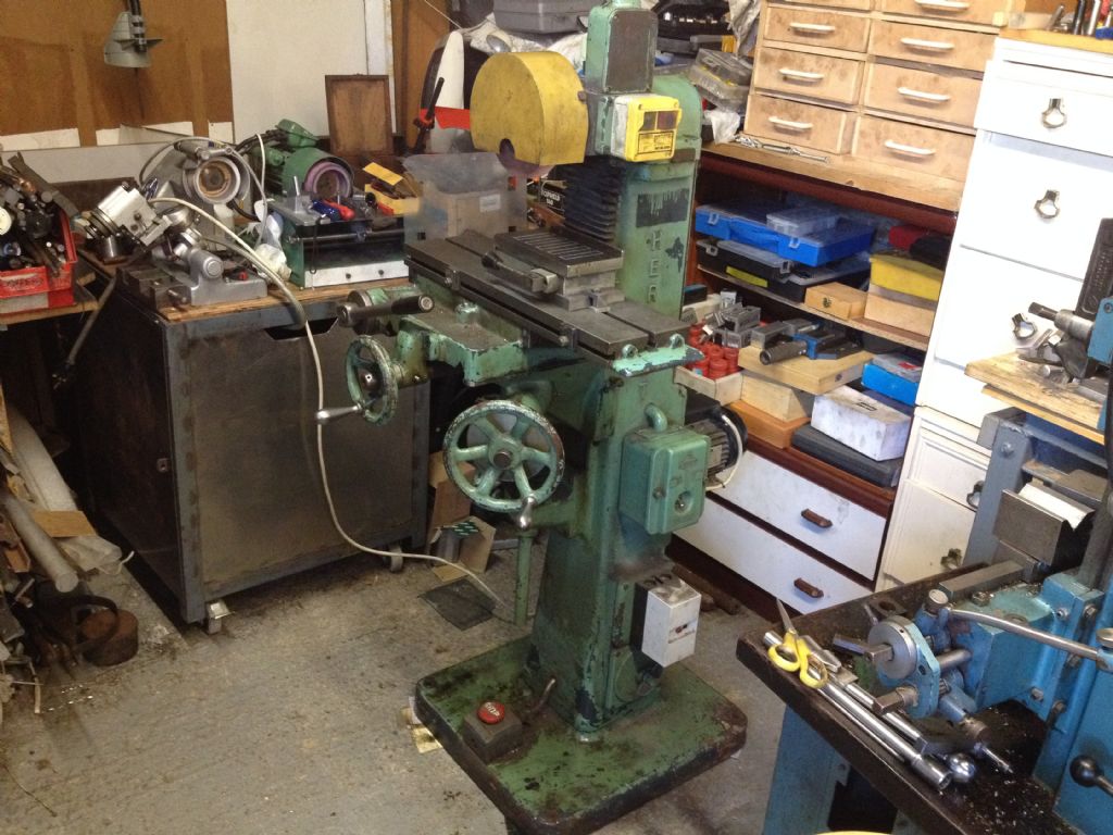

      I was fortunate enough to acquire an Alfred Herbert surface grinder and I would like to find out more about the machine – there is no manual and a search of t'interweb gives no results.
      Does anyone recognise the machine?

          Yes, great little grinder. Used to take 40 thou cuts on cast iron using a silicon carbide wheel. Don' t oil the slide ways, I think they get covered in grit and turn to paste.

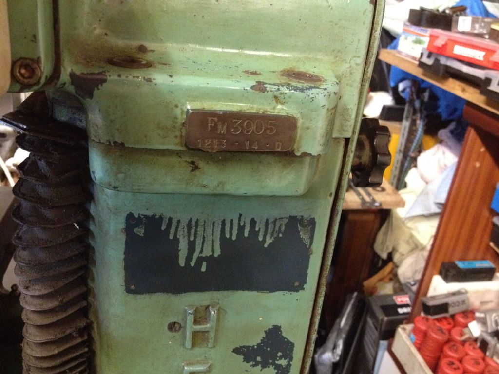

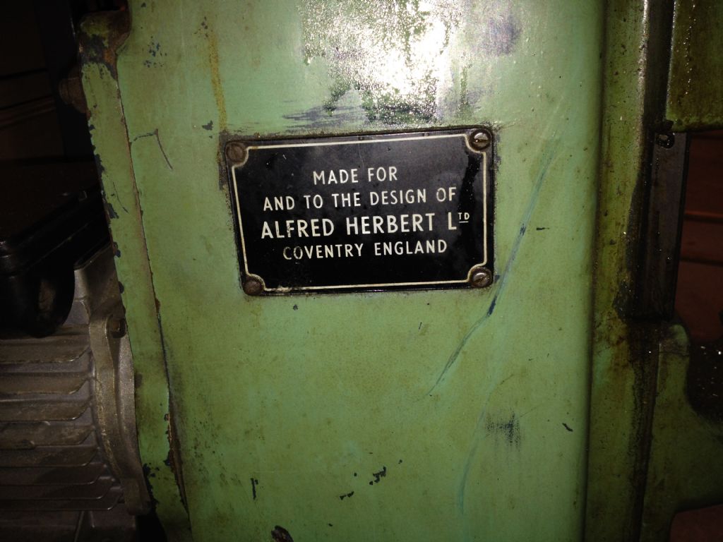

              It`s a nice simple grinder by Edgewick (Alfred Herbert) designed primarily for grinding chasers for the Herbert die holders and now very useful for model makers. Bet you that the X axis is worn to resemble a banana.
              The interesting thing is the plate in the middle photo in which we can see that the grinder was not made by Herbert`s themselves but by another unknown company.
