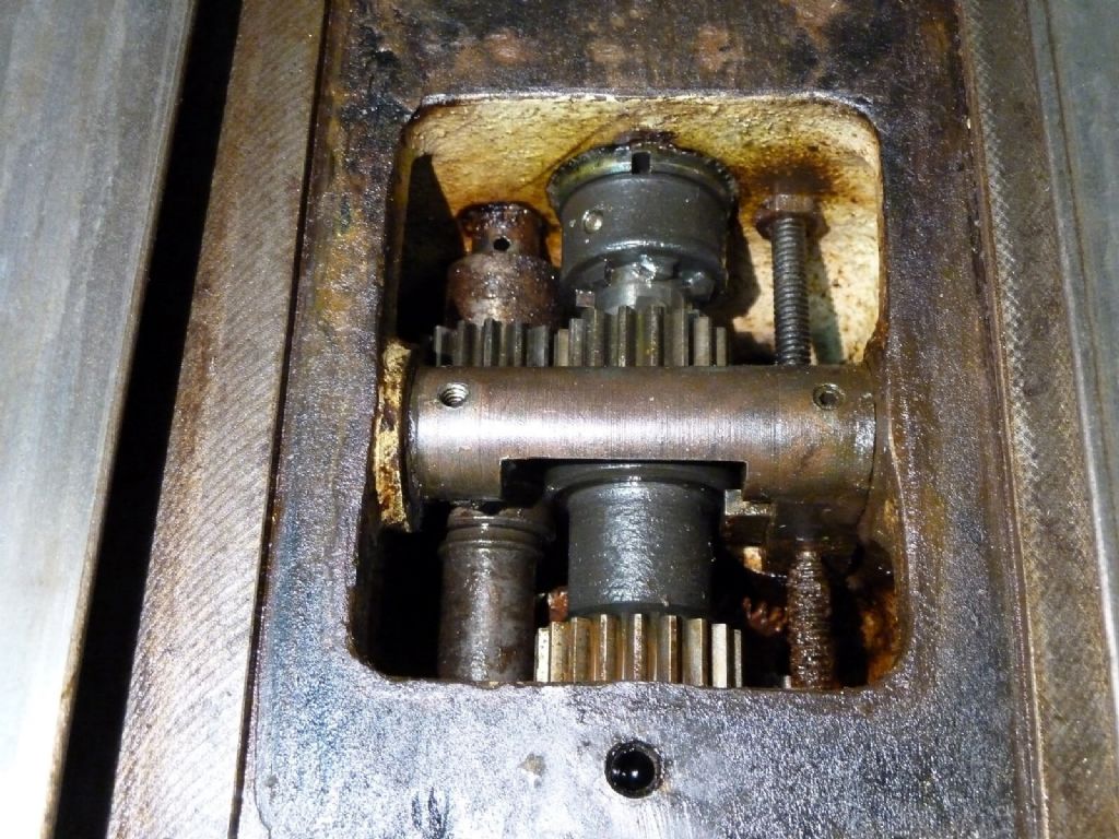

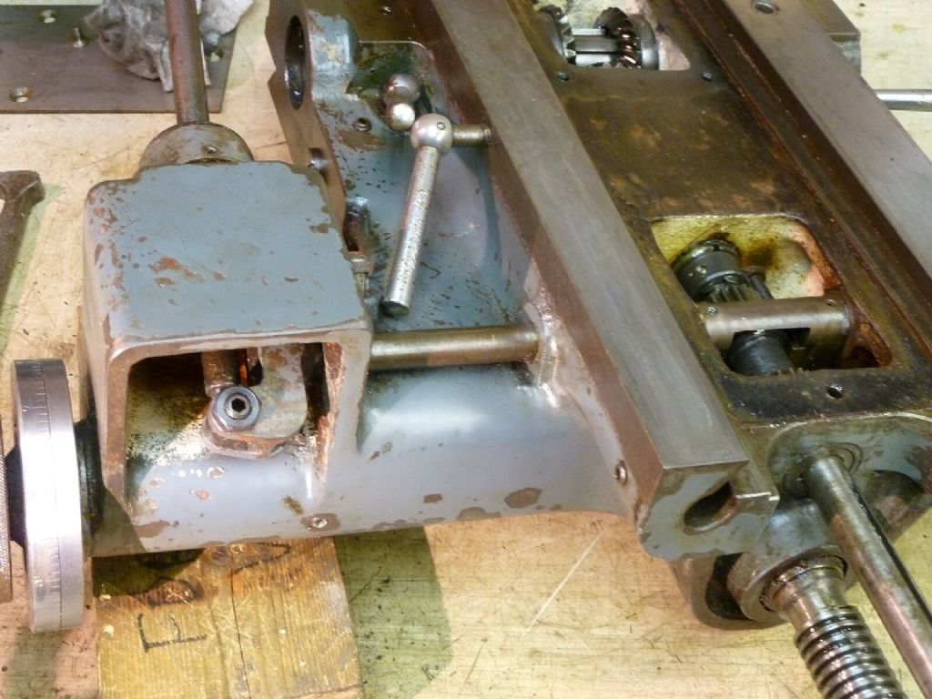

                                I have just uploaded several photos of milling machine being stripped to its carriage in an album called Alexander miller. The last photo shows it stripped down to only its carriage still attached. I need to know how to get the carriage off in order to address the problem of why it is jammed.

                                      Mark, the problem I have is access to likely culprits. If you look at the photos I uploaded you can see exactly where the carriage is on the machine. It can move further down (maybe 4&quot, but no further up. I can't see a key in the leadscrew that is currently exposed – unless I have misunderstood?
                                      Having had all of the machine apart, how did you get the horizontal spindle unit off the machine? I have loosened the collar behind the main bearing (pictures in the album) and removed the grub screw from the gear wheel, but the whole thing remains as solid as a rock! If I ever get the carriage moving I was thinking I would need to get the horizontal spindle unit off in order to remove the carriage from the machine – is that correct?

                                                I have added a couple of pics to my collection. The first shows that the key is firmly in place in the vertical power feed shaft and bevel gear. The second pic shows that I have got the horizontral drive unit rocking having removed the gib strip, and the leadscrew bracket at the back, but it still feels like some way from coming off?
                                                As to the basic problem of the jammed drive – I think I have one option remaining to me. If I understand correctly, the only thing that stops the carriage sliding up and off the machine is the nut in the bottom bracket at the front of the machine? There are two capscrews into the side of this bottom bracket which I suspect hold the nut in place? If that is the case I could release those capscrews and the carriage would slide up, complete with nut – if it wasn't for the motor feed bevel gear that would get in the way? So I would first need to figure out a way of removing this motor drive gear, which I suspect was never intended with the shafts still in place.?
                                                I appreciate that this may sound rather radical , but unless I can get the carriage off – then it can't be repaired – and the machine simply becomes a source of spare parts!
                                                Desperate times!

                                                      There are not many clues to this problem but the biggest and most significant is that when the carriage stops it does so with an abrupt and very solid clunk. You can feel this clunk primarily through the vertical handwheel, the drive select lever and the automatic feed cancel lever at the opposite side of the machine. To free it off when it was completely jammed involved working the feed cancel lever back and forth and same with the select lever whilst simultaneuosly turning the handwheel back and forth. Finally it released and the carriage could be lowered back onto its stop.
                                                      So I think it is definitley to do with the mechanism that lives within the carriage and turns the vertical leadscrew. I have actually tried turning the vertical leadscrew by gripping the leadscrew itself, but that makes no difference – it still stops with a clunk at the same point. So I am unable to turn that vertical leadscrew enough to get it clear of the nut I'm afraid – so the carriage remains on the machine.
                                                      I have actually loosened the Y leadscrew bracket but not removed it yet – I'm awaiting a result on moving the carriage.
