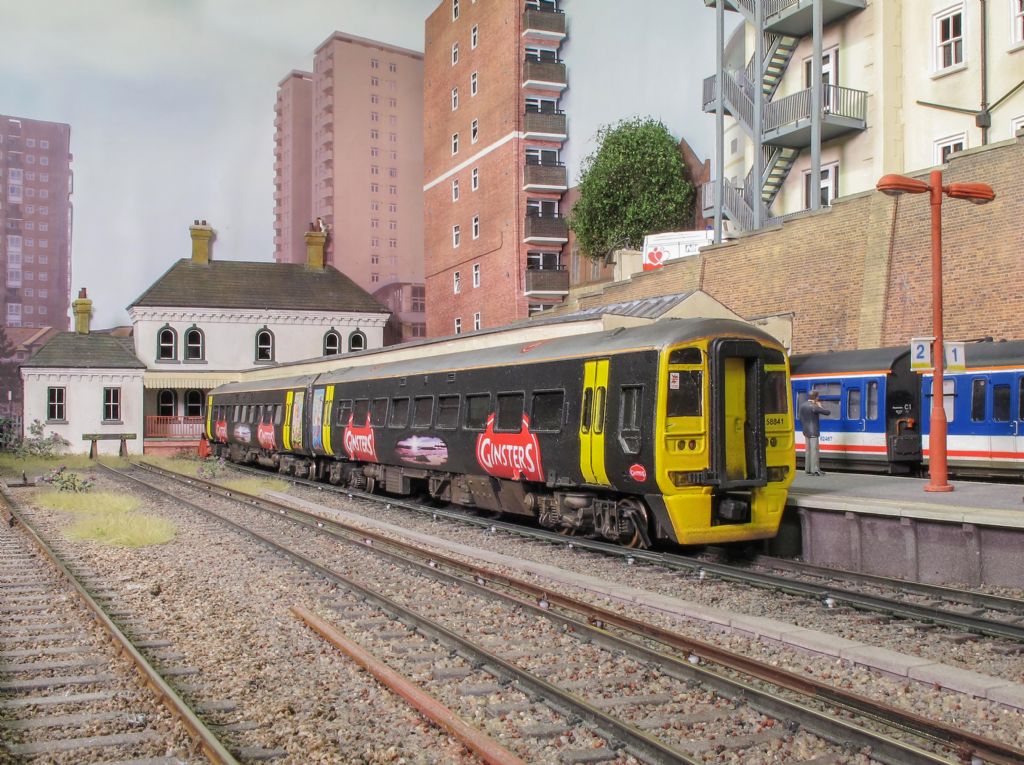

                      +1 for Vallejo, been using them for years. I find the model air spray without problem straight from the bottle. The standard Vallejo paints I thin about 50/50 with their thinners. The 4mm scale Ginsters livery Class 158 in the photo was sprayed and weathered with a mix of model air and std Vallejo. The finish was deliberately dulled down using Johnsons clear acrylic floor polish. Just remember with acrylics they dry extremely fast so you must be scrupulous with cleaning your brush after use. I normally use an Iawta Neo and the cleaning regime is. Empty out any remaining paint from the bowl. Wipe out any residue. Fill bowl with airbrush cleaner and spray that at max pressure/flow until spray is clean. Take airbrush apart and clean in ultrasonic tank. allow to dry and re-assemble and its ready for next time.
