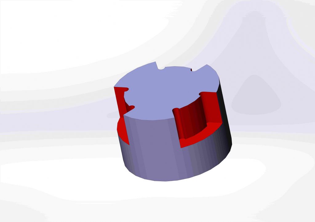

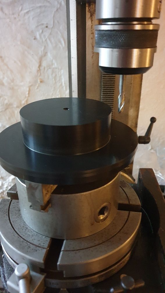

        I have to machine a Delrin bar end to shape three recessed areas that will couple with a socket. The diameter of the bar is 80 mm and the recessed areas are 8 mm deep and spreading through sectors of 60* and 17 mm width.
        I am mounting the bar on a rotary table and I was thinking about machining it in a mini milling machine.
        I don't have much experience with milling and when I was thinking about how to set the work, I was wondering what would be the best approach:
        1. Setting the RT horizontally, part vertically, and then mill with an end-mill from the top of the part while rotating the table.
        2. Setting the RT vertically, part horizontally, and then mill with an end-mill from the side of the part while rotating the RT.
        Please, could someone share wisdom with me and advise regarding the best approach and the reasons?
        I am think about firstly using a 6 or 8 mm cutter and then later use a 2 mm mini-cutter to work on the corners that are left rounded (either depending on how I approach the part).
        Thank you very much on advance.

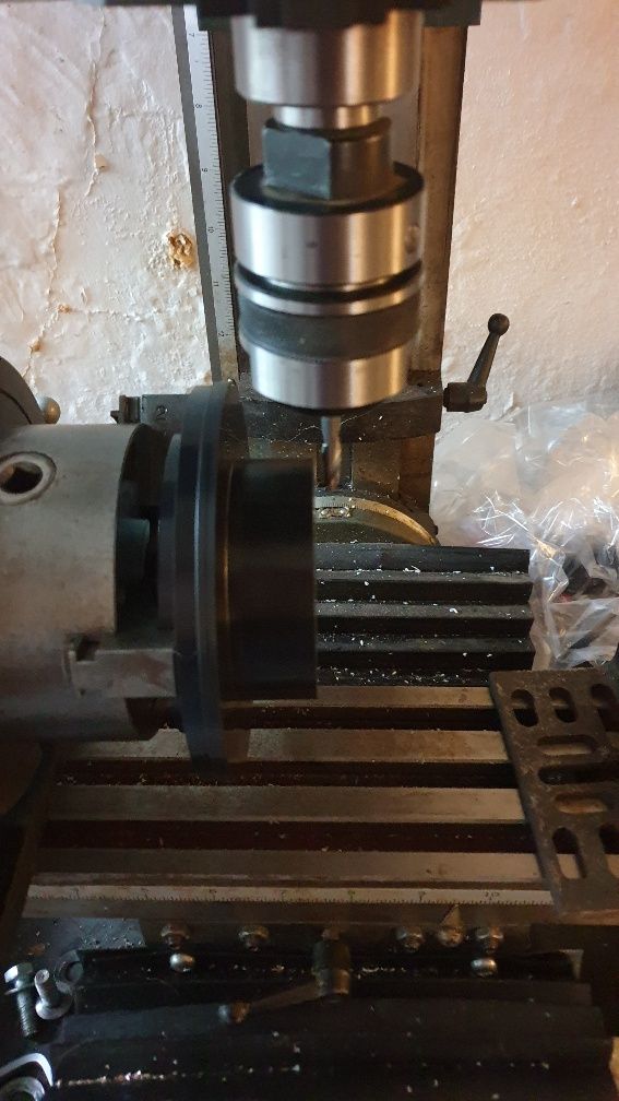

        #520628
        Brian H
          @brianh50089
          Just a personal opinion but I think it would be better as per your suggestion No 1. Your idea of firstly using a 6 or 8 mm cutter and then later use a 2 mm mini-cutter to work on the corners that are left rounded.
          Please let us know how you get on.

          #520633
          Ramon Wilson
            @ramonwilson3
            Agree with Brian – though either would be a suitable approach the vertical way will enable you to see the radial positioning easier. Given the size of the pockets though personally I would use a smaller cutter for the initial cuts 5mm diameter at most but preferably 4mm
            Don't forget to off set the mill table by the cutter radius once you have moved the RT radially.

              #520635
              Adan Santander
                @adansantander89729
                Brian, thank you very much for your advice. With learning in mind, please, could you advise the reasons (control, finish, stress, …)?
                For the sake of clarity, here are two pics depicting 1 and 2. Please, do not pay attention to the slot cutter,. it is the only one long enough I had for the photo.
                1
                2

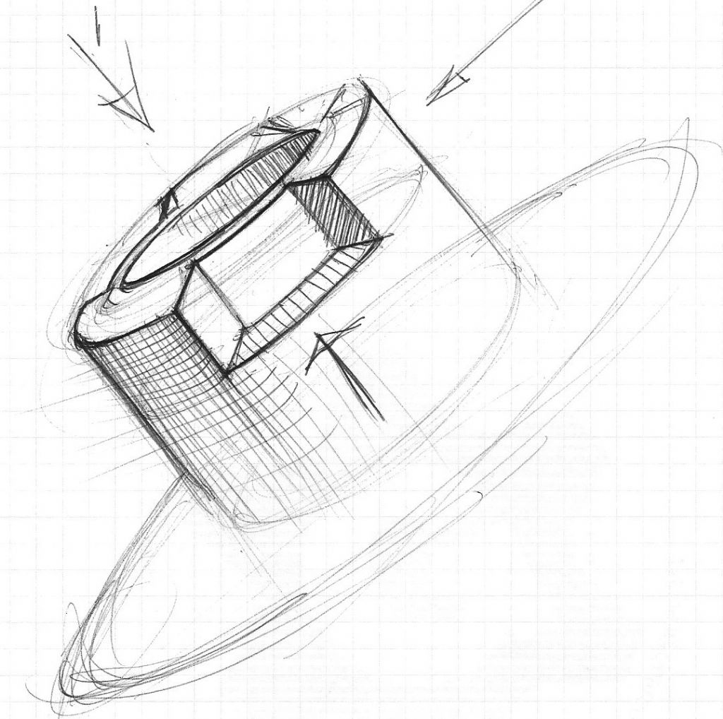

                          The difficulty with the part is the solid centre. If it were possible to remove it, machining becomes easy. If it is crucial for the part's function, consider removing it, milling the three teeth and then gluing in a disc to replace it. With a hollow centre, the part is just like a dog clutch, see:

                                DC31k, indeed. I have updated the sketch to represent the part better. The centre is bored but there is a 2 mm wall at this end and, to make it more complicated, the other end bore is tapered. I guess I could glue the 2 mm straight wall section. I think I will leave that option in case something goes wrong.
                                It made sense to me to machine the slots first before boring the centre in the lathe. Also, a lot easier to align the centres in the mill as it is using a centre finder.
                                Martin, that's brilliant! Thank you very much for the sketch, very illustrative. I am ordering a 4 mm extra long (75mm) end mill and will hopefully machine the part tomorrow or the day after.

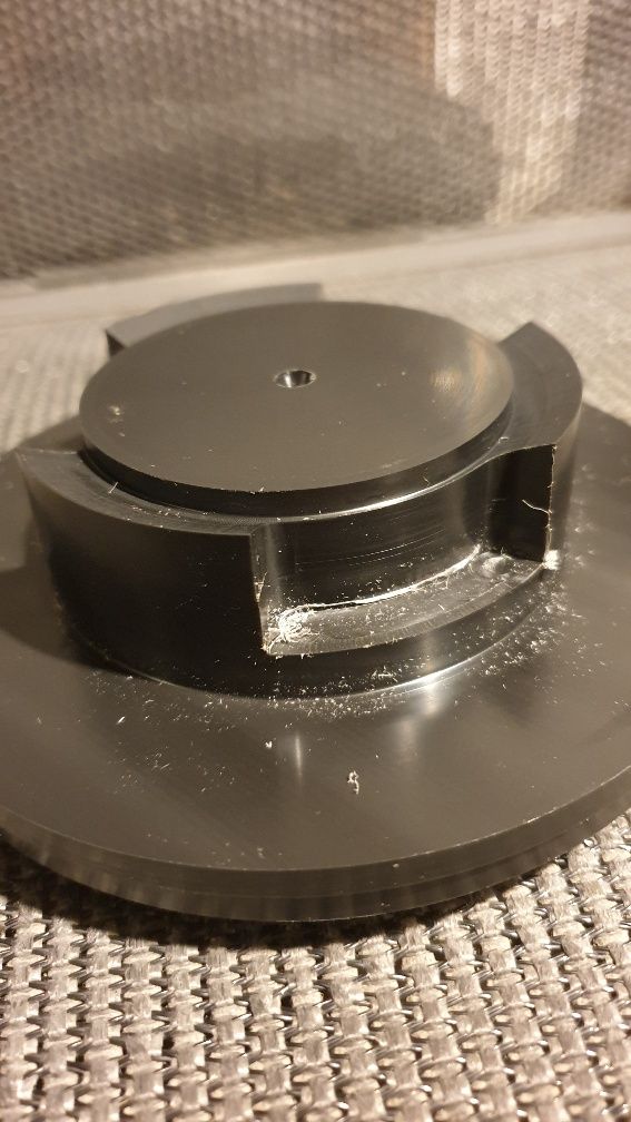

                                    #520871
                                    Adan Santander
                                      @adansantander89729
                                      Thank you all for your advice. I would say a success.
                                      Jason, I could not do the drilling. Run out of vertical space for the chuck and drill. It would have helped no doubt.
                                      Have to dull the corners… like a knife.
                                      Edited By Adan Santander on 18/01/2021 19:44:03

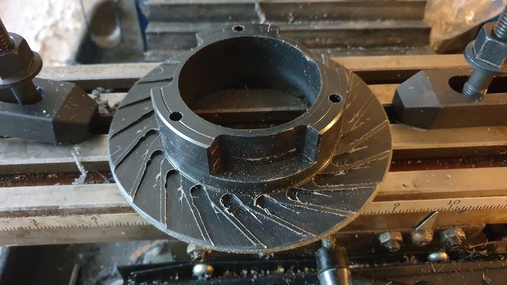

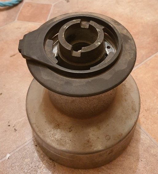

                                        #521789
                                        Adan Santander
                                          @adansantander89729
                                          I thought I would post the final part ready to install.
                                          Again, thank you very much all for your sound advice.20210122_155946_resized.jpg

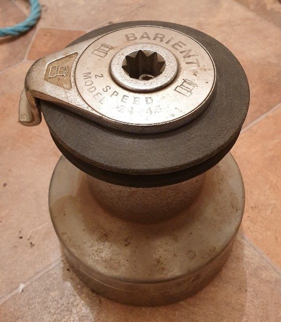

                                          mechman48
                                            @mechman48
                                            Is that an impellor with the vanes removed; or a flinger disc for a road salter spinner?
                                            Just curious.. thinking
                                            George.
                                            #521896
                                            Adan Santander
                                              @adansantander89729
                                              It is the top jaw of a self-tailing sailing winch.
                                              The lower jaw is preloaded with a spring and the helix in the top jaw bites in the rope.
