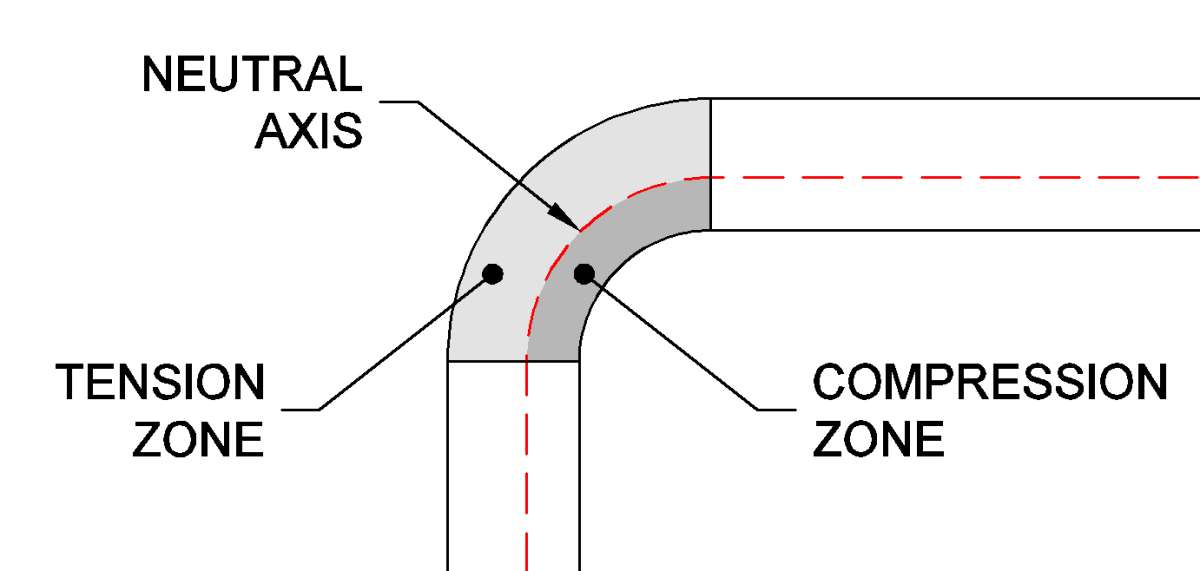

        On Bo’sun Said:
        Good morning Nigel & Dave.  Just curious, but why does a knot weaken the strength of the parent rope?
        1. Tension.    When a rope is bent, the outer side is stretched whilst the inner side is compressed.   The outer bend, in tension, carries most of the load, whilst the compression side is mostly idle.
        2. Leverage.   When a rope is bent back on itself to form a knot, it behaves like a crowbar, multiplying the force applied at the bends.
        Both weaken the rope by concentrating forces – the load isn’t distributed equally.
        NeutralAxis1
        The form of a knot determines how stressed the rope is, so some knots weaken rope more than others.  Also, in applications like lifts where knots are forbidden, designers are very careful about passing ropes over pulleys because small diameter pulleys stress and weaken rope much faster than large diameter pulleys.
        Many serious accidents winding coal and men from collieries during the 19th century due to not appreciating just how quickly wire rope wound over a pulley onto a drum was weakened compared with doing straight pulls.  Straight pull tests suggested Victorian wire rope would last decades but, in practice, a few years in a colliery broke some quickly.    Cure was to: increase pulley and drum diameters; determine formula indicating life of rope as modified by bending, and changing the rope before life expired; and – very important – regular close inspection of the rope – any sign of damage meant it was due for replacement.
        Damaged ropes are unpredictable, all bets are off!
