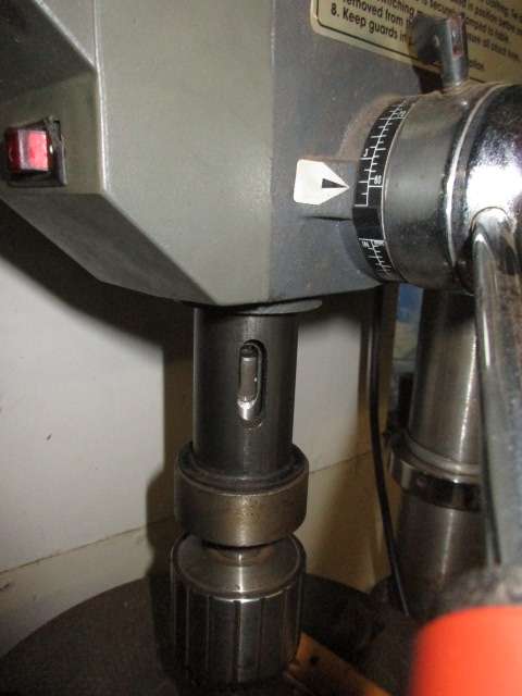

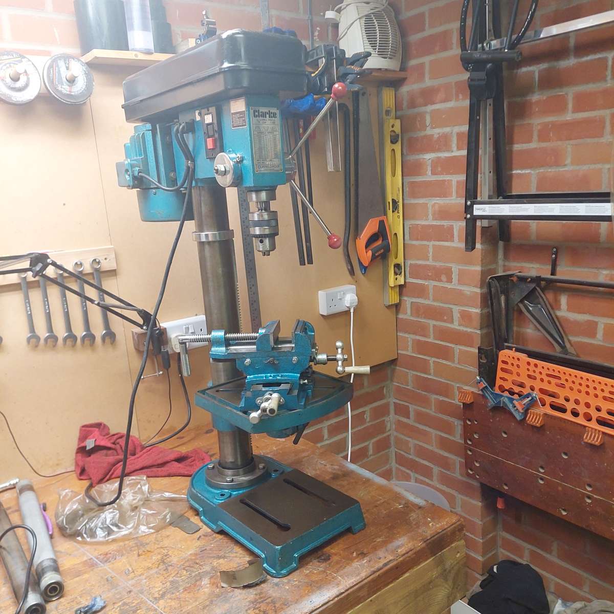

      I picked up this Clarke drill and the vice for £90 a few weeks ago. I’ve just cleaned it all up and noticed there’s no bolt to lock the quill.
      In the past I’ve used such a bolt to help with lining things up and I’m also wondering with this vice whether I can do some very light, not super accurate, milling.
      How would you go about adding some sort locking mechanism?
      What about something dual purpose to extend the quill a little for milling?
      Thanks20250721_17462020250721_174613

                                      I added one to the same casting May moons ago. From memory:
                                      Remove the top casting, strip the quill out.
                                      Drill a 3mm hole around where C1 is in the speed chart (remove the chart first) That should be above the lower quill support ring in the casting by ~2-3”
                                      with hacksaw slot from the bottom of casting to the hole.
                                      on each side around where the quill support ring is drill and tap a couple of holes. Then bolt a pair of 25mm angle or box section bits sticking out the front to the casting.
                                      Add a bolt across them with a nut handle to tighten.
                                      Clamped my quill absolutely solid with very little tightening force, YMMV.

                                        #808556
                                        John Purdy
                                          @johnpurdy78347
                                          Beeza650
                                          I don’t use the drill to mill for all the reasons stated, but I find a quill lock very convenient for lining up the drill on the work piece. Here is how I added one to my drill which is very similar to yours. To add it I removed the quill and drilled and tapped, (in my case 5/16-24 UNF) a hole through the front of the casting, then turned up the brass locking screw and cross drilled the head for the 3/16″ dia. steel tommy bar which was “loctited’ in. Before re-installing the quill I made sure any swarf from the drilling or tapping was cleaned out.
                                          Drill Lock 3
                                          Drill Lock2
                                          Drill Lock
                                          #808574
                                          John Purdy
                                            @johnpurdy78347
                                            You say you think in your opinion the return sprig is too strong. It is easy to change the tension. Just loosed off the two nuts on the silver cup opposite the quill handle so the cup can be moved to the left so the slots in it disengage from the tab on the casting (making sure you hold the cup or it will spin around), now rotate the cup to a new position where the tension is to your liking, and re-engage the slots with the tab. Once satisfied redo up the nuts.

                                                  #808735
                                                  John Purdy
                                                    @johnpurdy78347
                                                    Yes, the screw presses directly on the spindle to lock it. That’s why it is brass, so it doesn’t mark the spindle.It holds the spindle from moving with only light finger pressure, even at full extension against the maximum return spring force. Note from the picture you can see that the bottom couple of threads are removed so any mushrooming of the bottom from tightening it won’t prevent it from being screwed out of the head.
                                                    No problem if it un-winds, just wind it back up to the point where it feels right to you and re-engage one of the slots with the tab.  If the tension is too light the spindle won’t fully retract when the handle is released, conversely if too strong it will be hard to lower the spindle to the full depth. I have mine set so when the handle is released with the spindle at full extension it just retracts to the top on its own.
