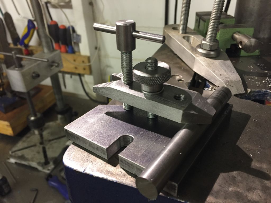

      Obviously we all use a drill press vice or clamps to hold work safely on the drill press table, don't we?
      The picture shows a useful tweak for when that isn't wanted. It's simply an aluminium post that's got an M12 thread up the lower end and a bolt to fix it to the table. It stops hand held items from whizzing around if the drill grabs and only needs to be done up hand tight, so it's simple to adjust.
      The good thing about this example is that it wasn't even designed for the job. I'd used it as part of a jig when holding things in a hex collet block on the milling machine to drill holes at 120° intervals around their peripheries. When I get around to it, I might make a custom T bolt for it, but for now it works perfectly well with the hex-headed bolt and washer.
      Picture's a bit limited, but I just snapped it on the phone tonight after using it.

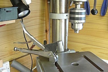

          #369654
          Bazyle
            @bazyle
            My drill vice handle is nowhere near long enough to reach the pillar. About 25 years ago the mole grip style clamp suddenly appeared on all the stalls at the ME show and I got one that has never left the drill table since. I vote for it as the most useful tool in the shed especially as being clamped to the table it never goes missing.
            #369667
            Journeyman
              @journeyman
              I went for the mole grip idea as well. There was an article in MEW 202, May 2013 on how to convert an old wrench. Not too much work but the finished article is quite cheap to buy!
              My effort above and documented build *** HERE ***

                #369674
                I.M. OUTAHERE
                  @i-m-outahere
                  I also use some of those toggle style clamps but there have been times where i have found i can't get one fixed to the table where i need it as the piece i'm drilling gets in the way but they do have the advantage of stopping the part lifting as the drill breaks through .
                  I like marks idea as it is simple to use and the post can be made shorter to allow the workpiece to overhang it if it's mounted in a vise .

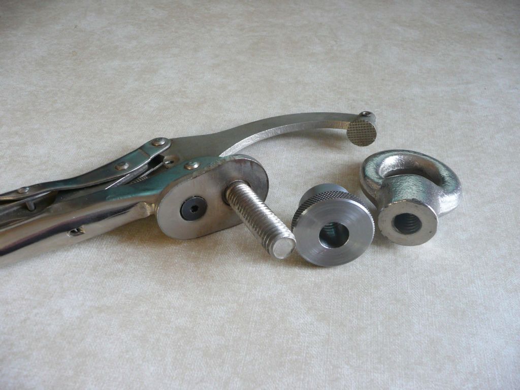

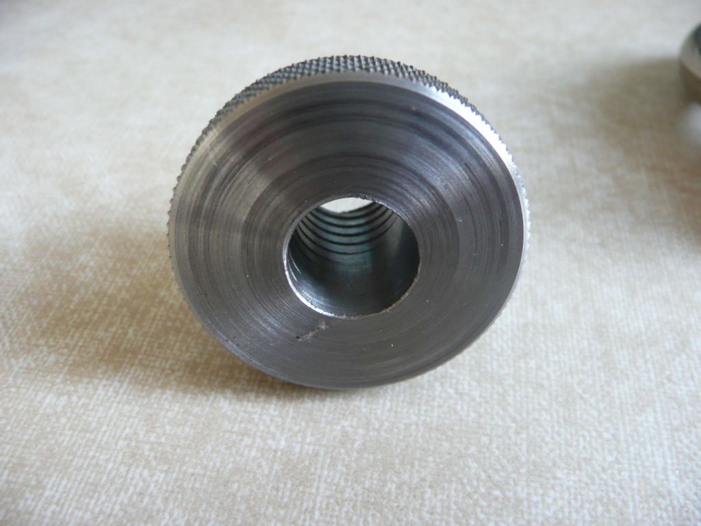

                    #369679
                    ega
                      @ega
                      I bought my clamp rather than convert an existing one and found the standard ring nut slow and awkward to use. The problem was solved by making a quick nut; close inspection of the second picture will show the relief to the thread which allows instant tighteneing and loosening.

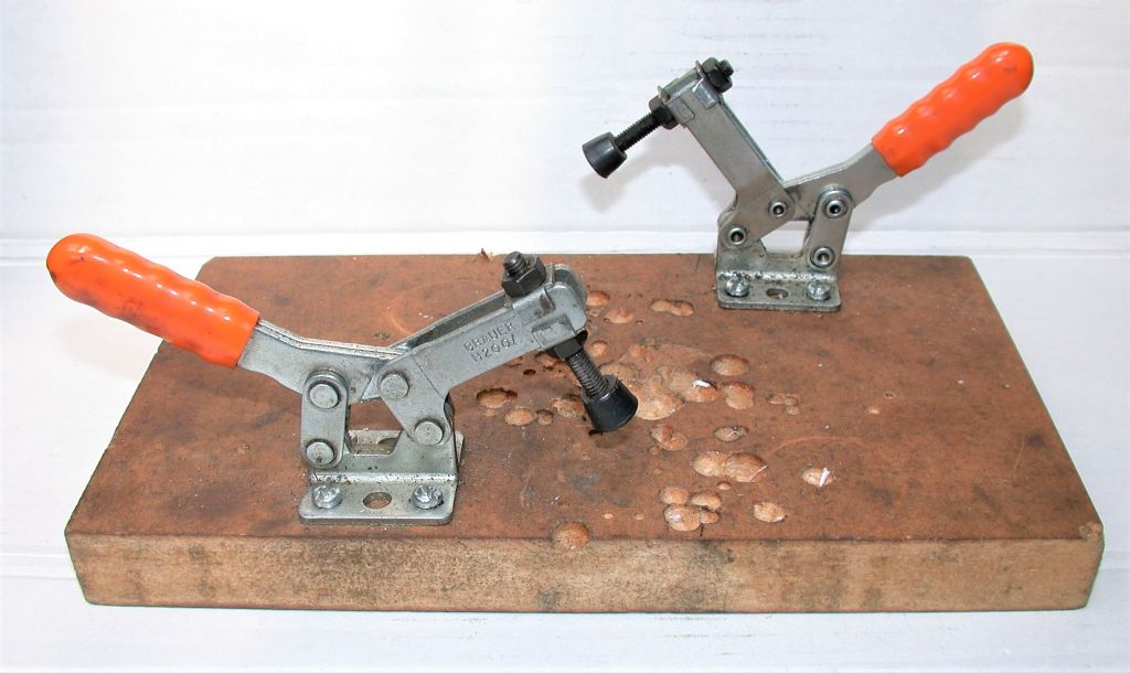

                                        @robbo
                                        This is a useful gadget for holding small, and especially thin, pieces. Very low-tech.
                                        When the base is drilled out get another bit of mdf and make a new one.

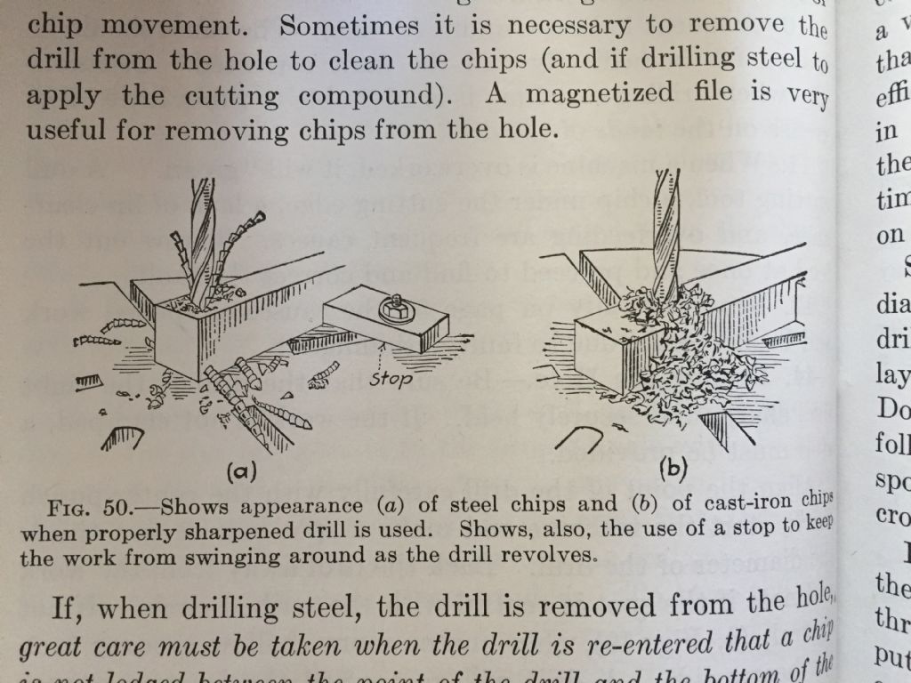

                                        #370211
                                        David T
                                          @davidt96864
                                          I came across this in Burghardt's Machine Tool Operation. It must be the only book I've read that doesn't insist on the work being firmly clamped down.
