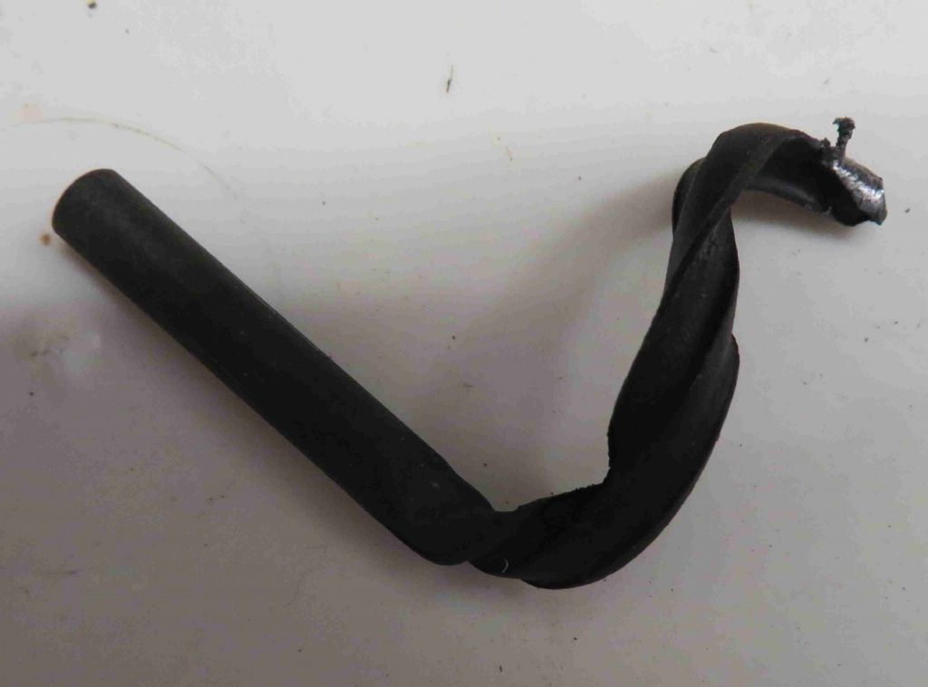

                                              Cornish Jack
                                                @cornishjack
                                                This is the product of trying to drill a hole in work-hardened steel with a Fobco Star – the 'thinned' point being produced by thermal distortion and the shape by crap manufacture!!
                                                Rgds
                                                Bill

                                                    #368221
                                                    Trevor Crossman 1
                                                      @trevorcrossman1
                                                      Posted by Cornish Jack on 20/08/2018 18:28:11:
                                                      Rgds
                                                      Bill
                                                      THAT looks more like an old fashioned stick of liquorice rather than a drill. I have broken many drills over the decades, but have never been able to bend one that much !!
                                                      Trevor.
