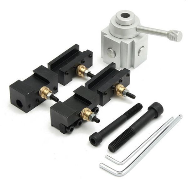

                                  Martin Hamilton 1
                                    @martinhamilton1
                                    I also use one of the cheap quick change tool posts from this supplier on the Sherline, this is a copy of the A2Z tool post that is no longer made & was popular on Sherlines. If you look on Youtube the A2Z tool post is used on a number of Sherlines. Again this tool post works fine on Sherlines for such a cheap price around £26 with 4 holders, with extra holders available @ just over £4 each. Again i have had no problems with this tool post on the little Sherline, probably a little fragile for the more larger much heavier lathes but great on Sherlines.
                                    Edited By Martin Hamilton 1 on 29/05/2019 16:43:12
                                    #448727
                                    Austin O’Hara
                                      @austinohara24453
                                      Posted by Martin Hamilton 1 on 29/05/2019 16:40:09:
                                      Martin, on the BangGood site there are two such QCTP's. Is the one shown below ( ID: 1195154) and priced at £42 the one for a Sherline?
