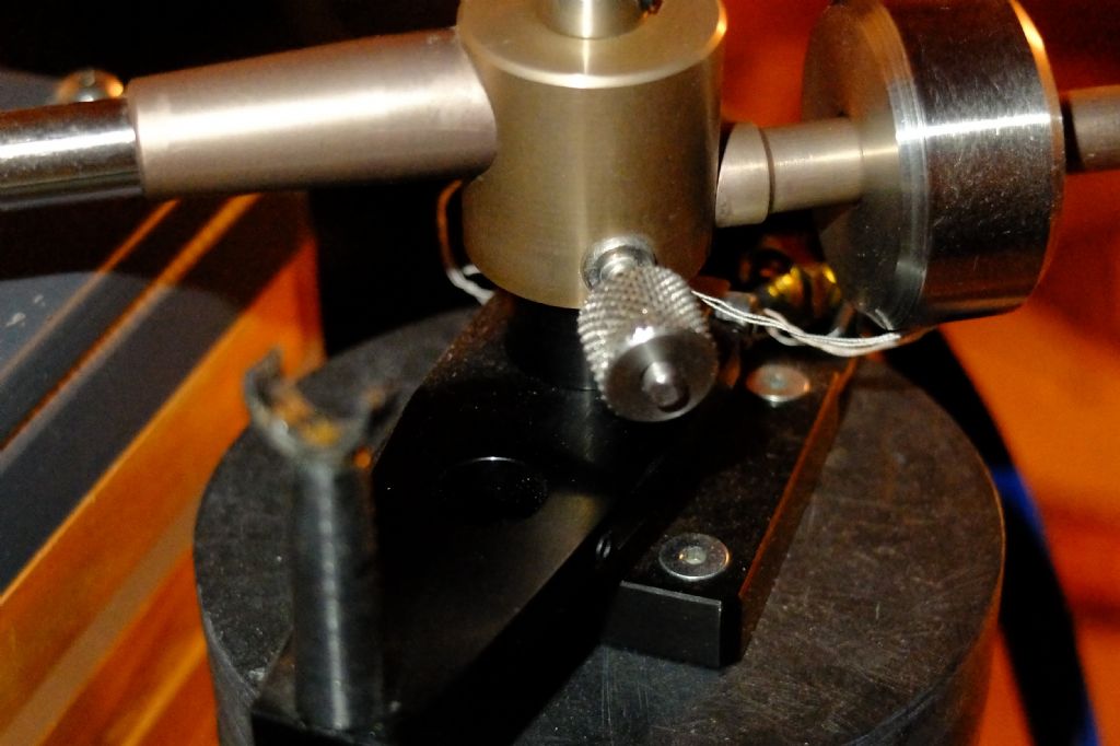

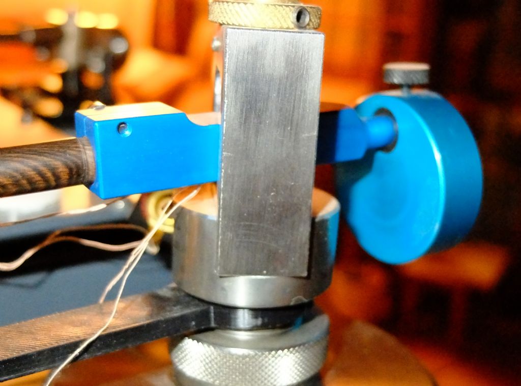

                                    Go ahead with anodising, it's not too difficult!
                                    I remembered that (quite some time back) I put a picture from my first trial in my album. A small test piece, coloured with magenta Inkjet ink. I added now another two, showing parts from my tonearms. The blue parts are also done with inkjet ink, blue this time
                                    The parts on the other arm are coloured with products from The German firm 'Electronic Thinks'
                                    Black and Titanium colour, which is more like dark Bronze.
                                    **LINK**
                                    Here you can get all what you needs for your anodising projects.
                                    Btw. I made some tests with those textile colours, but no success. It seems that only one of the different Dylon (?) products can be used, and it seems this one is difficult (or impossible) to find.
                                    OK, here then the pictures:
                                    Sorry for the dust, i did my best to clean all before taking the pics, but with flash one sees the smallest speckle…
