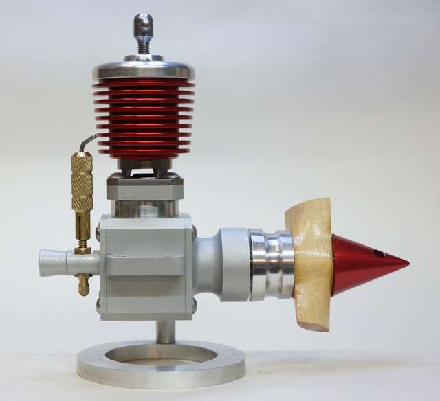

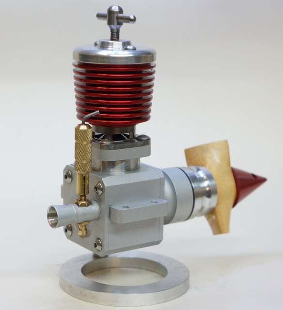

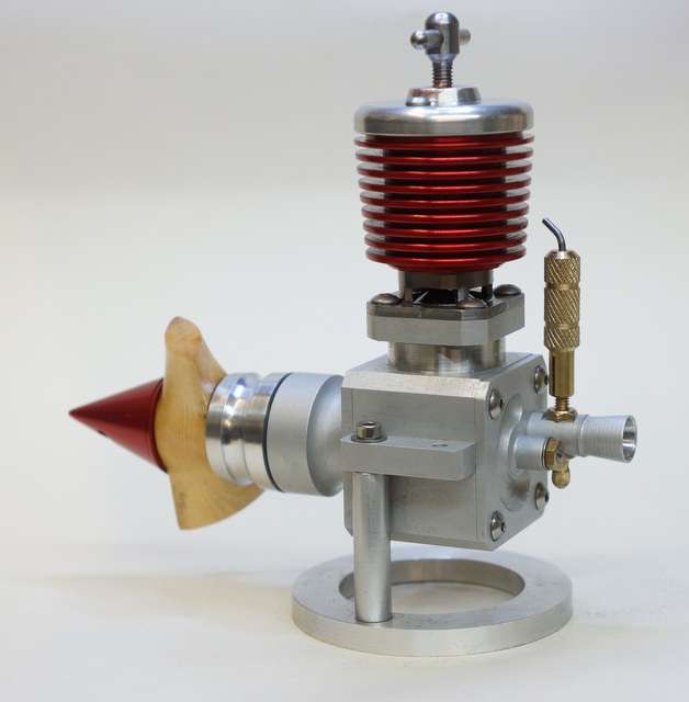

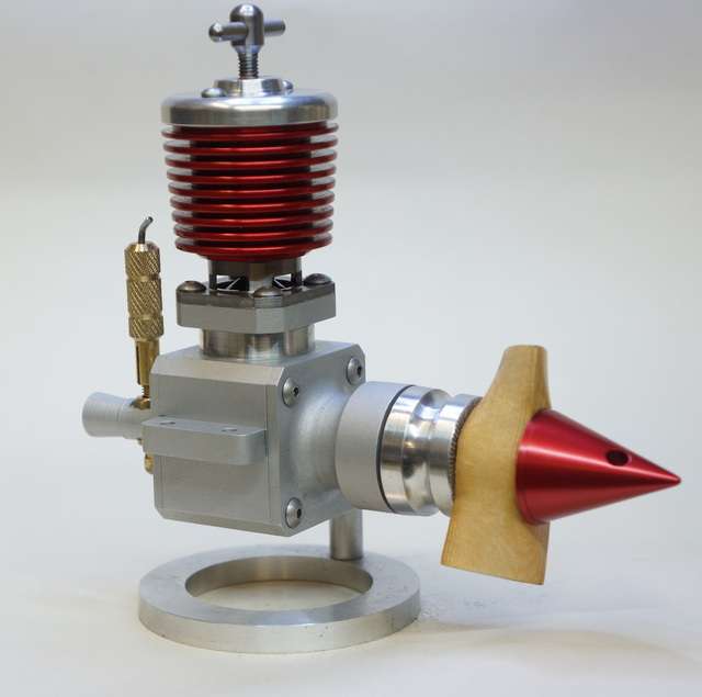

      This is a momentous occasion for me, as it is the first Thread I have started with the new Forum.
      I think it might be helpful to say how I intend to go about the necessary moves to get my text and photos on the Forum, to see if it actually works.
      Photos are taken with a camera, then transferred to my PC and into Picasa for storage. Selected photos have then been reduced to 600 pixels and exported to my Desktop, with the intention of drag and dropping them, hopefully in the correct order, into the Post.

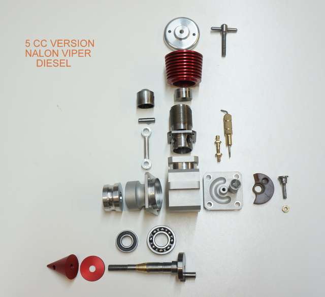

      The idea of a 5cc version of this engine developed from my posting of the original 2.5cc engine which I made during 2023. This led to an exchange of e-mail with Ramon Wilson, who kindly offered me an almost finished centre crankcase of a 5cc version he had started, but abandoned. This I accepted, together with a set of drawings marked up for the 5cc dimensions. However, Ramon being a youngster, works in Metric and I prefer Imperial, so rather than add another set of conversions, I printed off another set of drawings and did the conversions, one at a time, as I got to start each component.  This worked out OK for me.  An accurate measurement of the finished engine gives a swept volume of 4.97 cc.
      With the set of drawings that are/were, available from the Model Engine News site, there are two versions of the Cylinder. One being claimed to be a later modification. This has integral steel cooling fins, plus larger transfer and exhaust ports, Timing is slightly different with this version also. Just to make things interesting, I decided to make a third version of the Cylinder, by using the new  port dimensions and timing, but keeping the Aluminium cooling fins. The Cylinder would then have a 26 TPI thread screwcut above the exhaust ports to allow the cooling fins,with the same internal thread, to screw onto the Cylinder, thus doing away with the long 4 holding down screws. The Cylinder flange has been increased to the same shape as the crankcase, giving positive location and the ability to screw it down with shorter screws. Additionally I also made the seperate Aluminium head which the steel fin version requires, but this becomes a dummy head that I have left polished, as a contrast to the red anodising of the fins. I am very pleased with final appearance and cannot wait to hear it scream..  At the moment the engine is fitted into the test rig awating its first run, but the outside temperature is minus 3C and I am certainly not opening the workshop door to avoid being asphyxiated.
      I will post again after I have had it running.

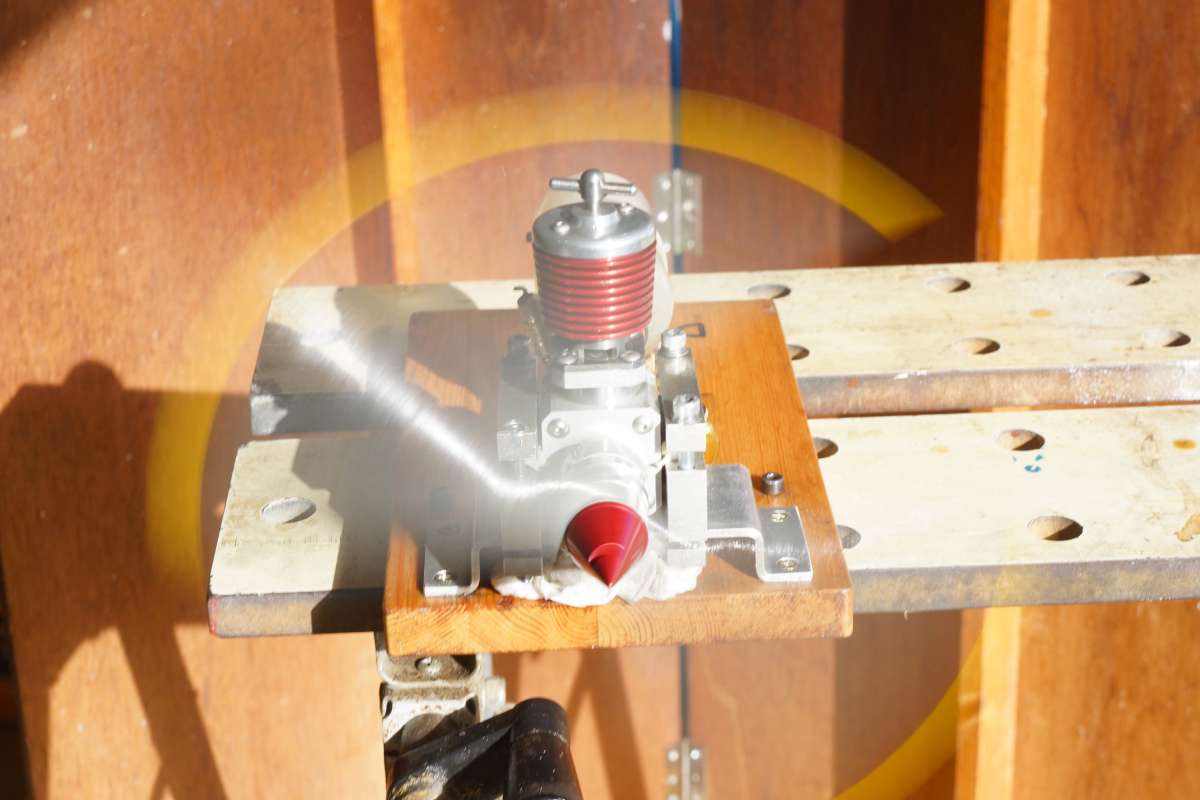

                                    Ramon,   For the record, I did have a 2 minute run ,with the door shut. Could not resist hearing it run. Started easily, set it rich and burrp, burrping. Making a lot of smoke,so before I got choked I pinched off the fuel tube, revs went high  and then sudden stop.Prop would not turn past BDC. Took back plate off and discoverd the Disc spindle had unwound inwards and was bent, presumably by hitting the crank pin. Could not see any damage to that, so have made new pin and it is all set up to have another run,with door open, I hope today. I later found the nut and star washer that was supposed to lock the Pin on the floor. I have now replaced it with a Nyloc nut.
                                    Will report later, perhaps after I have had another session.

                                              Now that the weather has warmed up somewhat, I have had the chance to get some running time in and now have 45 minutes recorded. On one occasion, when running at full chat, around 10,000 RPM plus,the exhaust oil suddenly turned dark brown and with a strong smell of burning castor. I shut down and when cool, took the back off, but could not see any problems,so re-assembled, Subsequent runs have not repeated that, so I am mystified as to what happened, Fuel used is Model Technics  2000.  It is a noisy,thirsty engine and quite powerful and with the 4 way exhaust very dirty.
                                              Attached is a photo of it doing 10,000 plus RPM.DSC04513
