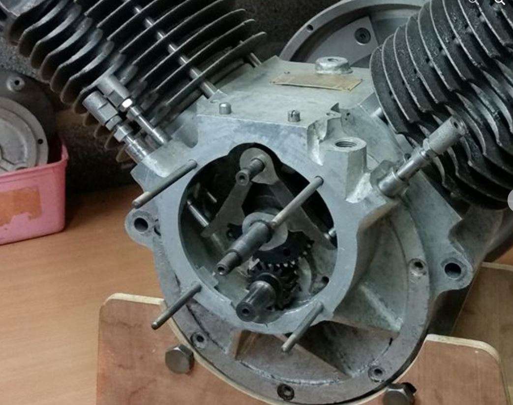

                      I have a feeling the lever type cam followers come into play when working out what is going on as if the tappet were just radial to the cam axis it would not work as you can’t get the cam to actuate both valves the same relative to TDC.
                      Have you asked on something like the GN Cyclecar FB group from which I sniiped this

                        Ooh, nice one. So the later model Harley Knucklehead etc cam timings might be a reference point. I still would focus more on valve events than LSA. If you want to spruce the performance up a bit, take a look at the Andrews specs for the old cast iron Harley Sportsters from 1957 to 1984 or so. They were the fastest bike on the road when they came out. (Yeah yeah, Vincents blah blah but they were dead by 1957. And no Vincent ever equalled the Sportster streamliner’s 265mph that Cal Rayborn did.)
                          cam
                          Elegant in its simplicity. But also got me scratching my head. Those cam followers appear to contact the cam above the centreline, so looks like there is 90 degrees or camshaft rotation between the two followers? So one cylinder would fire 180 crankshaft degrees after the other one? Then a looong 540 degrees until the first cylinder fires again? Kind of a “big bang” timing, as used by some racing bikes in recent years to get unevenly spaced power impulses to allow rear tyres time to cool down and regain shape between cycles. Harley tried it on their XR750 dirt track racer but abandoned it. Seems to work better on the 4 cylinder bikes.
                          None of which has anything to do with Lobe Separation Angle between the intake and exhaust lobes of course, but very interesting nonetheless.

                            Hmm, but then the crankshaft would have to have two separate crankpins at 90 degrees from each other, or the piston would be in the wrong position when that shared cam lobe came around from No1 to No2 cylinder 180 crankshaft degrees later. Which has been done on modern Japanese V twin cruisers, but no idea if the GN had such a thing.
                            Unless they have been extremely cunning and used one cam lobe to operate the intake valve on one cylinder and then the exhaust valve on the other cylinder. Then they could use the more conventional single crankpin and 270/450 firing intervals. ???

                                That is what I was saying Hopper, the levers put the followers at a different angle to the cylinders so they are not 90degrees apart
                                I also thought about the cam opperating different valve but on that engine the outer two rods go to the inlet and the inner two (Behind gear?) to the exhaust. Though that is only overhead inlet valve. If there were rockers for each on the head then you could probably cross the valve rods over. Think we need a photo of the engine in question.
                                It’s a single crank pin with knife and fork bigends

                                  Looking at other photos on the FB page, the OHV engine runs the pushrods parallel, not crossed. The rocker arms are just offset to match the pushrod location.
                                  Now, looking at that video I posted a link to, it looks like the followers are spaced apart perhaps at 135 degrees, not 90 as it looked in the other photo? So 135 degrees of cam rotation gives the requisite 270 degrees of crankshaft rotation equal to one revolution of 360 minus the 90 degrees the cylinder is offset. The next firing interval is the long one, 450 degrees, ie 360 plus the extra 90 degrees around to the next cylinder.
                                  270/450 is the firing interval of the new modernday Triumph Bonneville twins, so it is quite do-able. Triumph though keeps the cylinders parallel and uses two crankpins with a 90 degree offset, aka 270 degree offset if you measure it that way. Gives a beautiful V-twin loping exhaust note out of a parallel twin. And like the 90 degree V twin, has virtually perfect primary balance so runs very smoothly.
                                  A very clever arrangement in its simplicity by the gentlemen at GN if that is the case.
