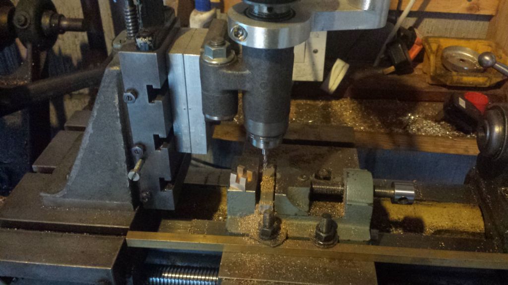

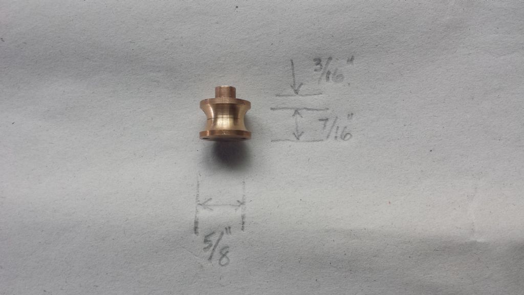

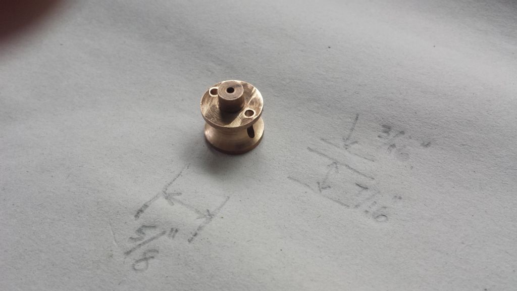

      20170917_123053.jpgHi All,
      The photos shows one of two part machined main bearings for my jepson engine.
      It is 5/8" dia cast bronze in two halves, soft soldered together. It has been waisted and the two holes are 8ba clearance.
      I need to cross drill/bore a hole around 6.1mm diameter on the join line. The hole has to be parallel to the underside and also square to a centre line through the two holes. The hole position on each bearing has of course got be exactly the same.
      I'm struggling with a 4jaw or face plate set which will give me the accuracy I need.
      Any ideas anyone? the two outer faces will be machined later using a small expanding stub mandrel.20170917_123113.jpg
      cheers geoff

          Pop it in a vice and either mount that to a vertical slide or on the mill table if you have one, not only will it make it easier to position the hole but will stop the part bursting open as you drill and I assume ream to 1/4"
          May have been better to do the hole first and then shape the part as you would have more material to hold.
          Edited By JasonB on 17/09/2017 14:09:19
          #317384
            Just looked at the drawings, I'm not sure you will be able to get the full length of the 7/16" dia out of it.
            I'd probably do it with two rectangles 5/8 x 1/2 stacked one on top of the other, drill, bore and ream hole and do the longer 7/16 dia at one go in teh 4 jaw. reverse and do the other 7/16" dia. Then drill small holes followed by the two scallops milled out and then just round over the outside with a file.
            Edited By JasonB on 17/09/2017 14:16:43
            Edited By JasonB on 17/09/2017 14:22:40

              Hi Jason,
              Thanks, I may well have to go with a vertical slide and in my case angle plate set up.
              Would prefer a to do it the other way so I can cut the oil groove in the same setting but as things stand now your suggestion looks the best way forward.
              Yes the 7/16" dia will be tight, possibly slightly under but as it's not critical not really a problem. (Both my bearings will have a face width of 3/8&quot
              cheers geoff

                I misread your post earlier. Yes you're right I wouldn't get the full face width of 7/16".
                The waist diameter is 7/16" so is good only for 3/16" each side of the centre line giving a 3/8" face width.
                As you have looked at the drawing could I ask the following. The two crank webs are a full circle and quite heavy. Is that because they double up as a webs and a flywheel with the two 5/16" holes making the "web" lighter on one side.
                Will post some pics of the finished bearings later in the week.

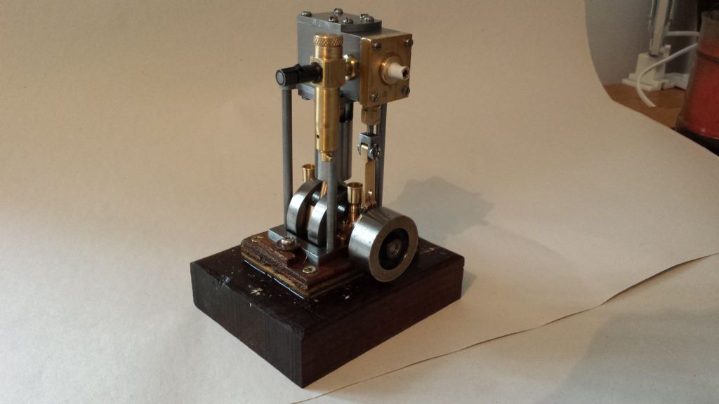

                    Hi All.
                    Is there anyone out there ever made this engine, or knows anyone who has?
                    I have had a good look on the internet and can't find an example anywhere, so it looks like I may be ploughing a lone furrow!!!
                    The engine first featured in M.E. magazine back in April 1947 as a 2 1/2 page article. That article is now on the John-Tom website. In an earlier post in this thread Jason has given a link to the article.
                    It is the first steam engine I have ever built and probably not the best choice as I've had problems. I would not recommend this engine as a first build. Having said that I am "getting there", slowly and gradually more surely. The drawings in the article are good but not 100% correct so beware if you are to attempt this engine. I am currently CAD the whole engine as I go along hopefully correcting any issues with the drawings.
                    The photo shows the engine assembled with the main components, which with good running fits turns over nicely.
                    I'm not looking for specific help at this stage but I will be in due course, probably when I have to set up the as yet unmade valve gear.
                    Back to the original question. has anyone ever made this engine?
                    geoff ………… and yes I will be changing the screws to hex heads!!!20171114_083900 (2).jpg

                      It's coming along well Geoff. If you have them it may be worth looking at the old MEs for the months following when the engine was first published as there may be some comments in smoke rings about it.
                      I've not seen one made or heard mention of it until you started posting.
                      J

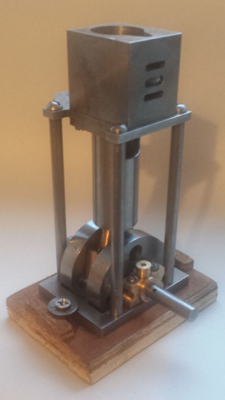

                          A question if I may on the slide valve for this engine.
                          The last photo in this thread shows the ports in the cylinder block.
                          The outer dimension across the two inlet ports is 1/2". The ports are 3/32" wide so the inner dimension is 5/16".
                          From what I have read (M.E. tyro articles by W J Hughes issue 2666 and 2670) the length of the cavity in the slide valve should be the same as the inner dimension (5/16&quot. This would seem to me to be fundamental as with the side valve in a mid position both the inlet ports will be closed. If the slide valve cavity is any longer then both inlet ports will be open with the valve in the mid position, even if only by a small amount.
                          The drawings for the slide valve on this engine show a cavity length of 3/8". Is this fundamentally wrong, does the length have to be 5/16" or am I missing something?

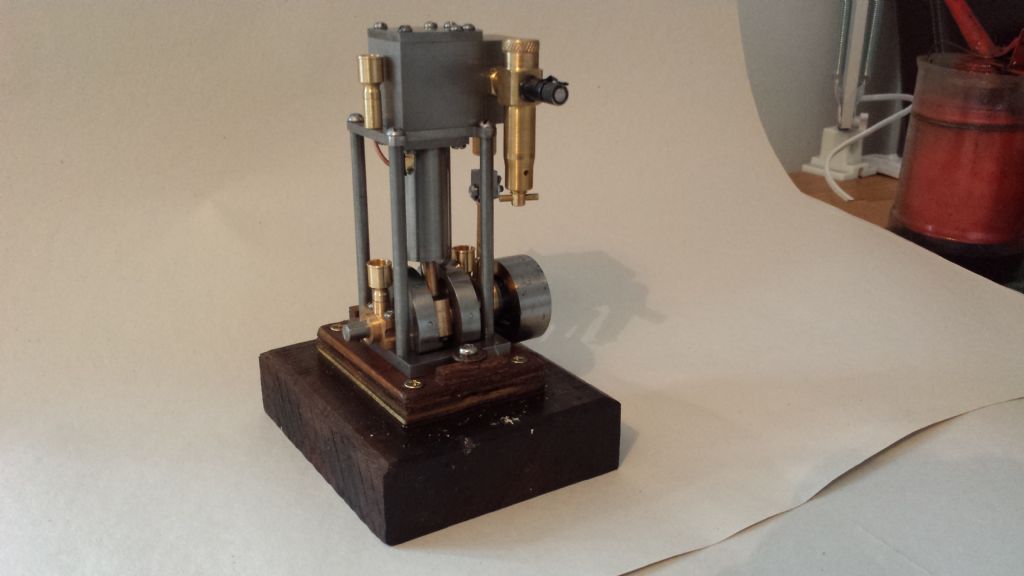

                                            #352211
                                            geoff walker 1
                                              @geoffwalker1
                                              20180429_154444.jpg29042018.jpgHi All,
                                              Took a day of today from usual activities to prepare the Jepson engine for steaming.
                                              Added the home made displacement lubricator to the valve chest, then the three oil cups.
                                              The oil cups hold oil to lubricate all the external moving parts. the two main bearing ones also lubricate the big end and the eccentric via oil channels in the crankshaft. The other one carries oil via a down pipe to the cross and the small end.
                                              Bought the cups on ebay, "cheap as chips", £1.50 for 10, why bother making them!!
                                              Also added an additional flywheel. The engine runs fine with the combined flywheels/crank but better with the added flywheel.
                                              I bought some PTFE sheet to make gaskets. Really impressed, only .004" thick and very easy to cut and shape with a sharp modelling knife and gives a perfect seal.
                                              It would appear to me that I have an internet world exclusive on this engine. I've searched and can't find a single example, apart from mine of course.
                                              Best to all Geoff
                                              #352229
                                              Emgee
                                                @emgee
                                                Nice running engine Geoff, sounds a treat at the low revs.
                                                Emgee
